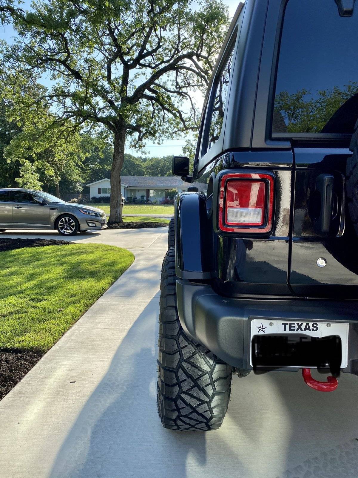

2022 JLUR XR
17x9 4.53Bs -12 offset
Sport S , so axles little narrower but Rubi Flares for reference.
Edit - Also forgot to mention 37x12.50s

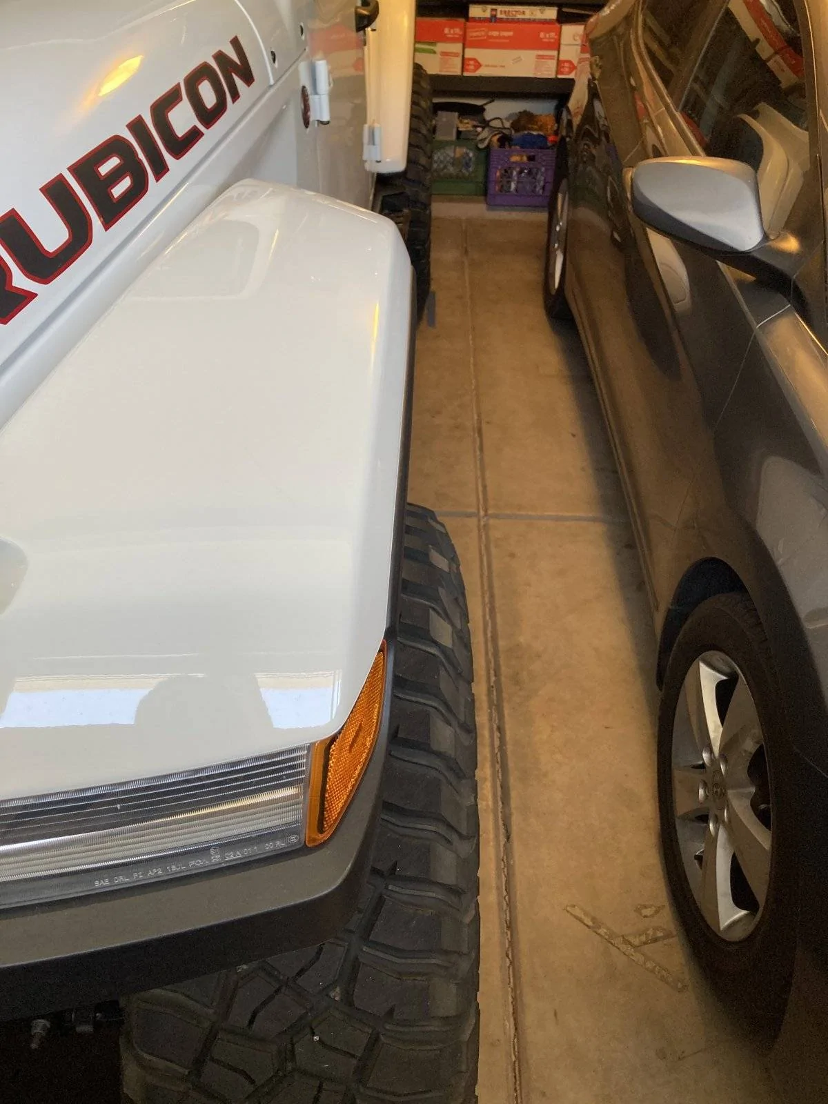

2020 JLUR with 37x12.5 R17 mounted on 17x8.5” wheels with -4.75” backspacing (0 offset)
What lift are you running ? Any issues with rub? I’m looking at 37x12.5x17 BFG MT’KM3’s on 17x9’s with -6 offset (4.76 backspace) to put on my sport with a RK 2.5 max flex lift .. RK said I might see some rub at full lock on the lower front arms..
McQueen
Feb 28, 2021
67
93
Arizona
2020 Jeep Wrangler JLUR
Mopar 2” lift. The front tires just barely tap the low point of the fender liner at full flex + full lock. I’ll get a picture later to be more specific. I haven’t removed those plastic guards at the lower rear of the rear fenders so the tires tap those at full flex as well. Again, I’ll get a few pictures to clarify.
Otherwise, everything tucks nicely at all angles.
A couple things I would note for your case:
1. The 37” BFG KM3s mounted on 17x8.5 on my Jeep actually measure out to 36” so they run small which likely reduces the rub risk. I doubt there will be much difference on 17x9 wheel but it may make the tire stand a little taller so the actual diameter may not be the same as what I’ve got.
2. I don’t know the specifics but I recall that the sport has narrower axles than rubicon which will likely play a role in clearances and finding appropriate wheel BS. Probably also attributes to the rub risk on the LCA.
3. Sport fenders sit lower than rubicon fenders. Less clearance.
I don’t know much about the JL Sport suspension but the above items are what I would be looking at. Check with RK for suggested bump stop thickness to limit up travel. I used Teraflex’s bump stop kit at the rear for finer tuning (it’s a nice shim kit). Will add the fronts later.
The BFG KM3s are amazing tires. You will love them.

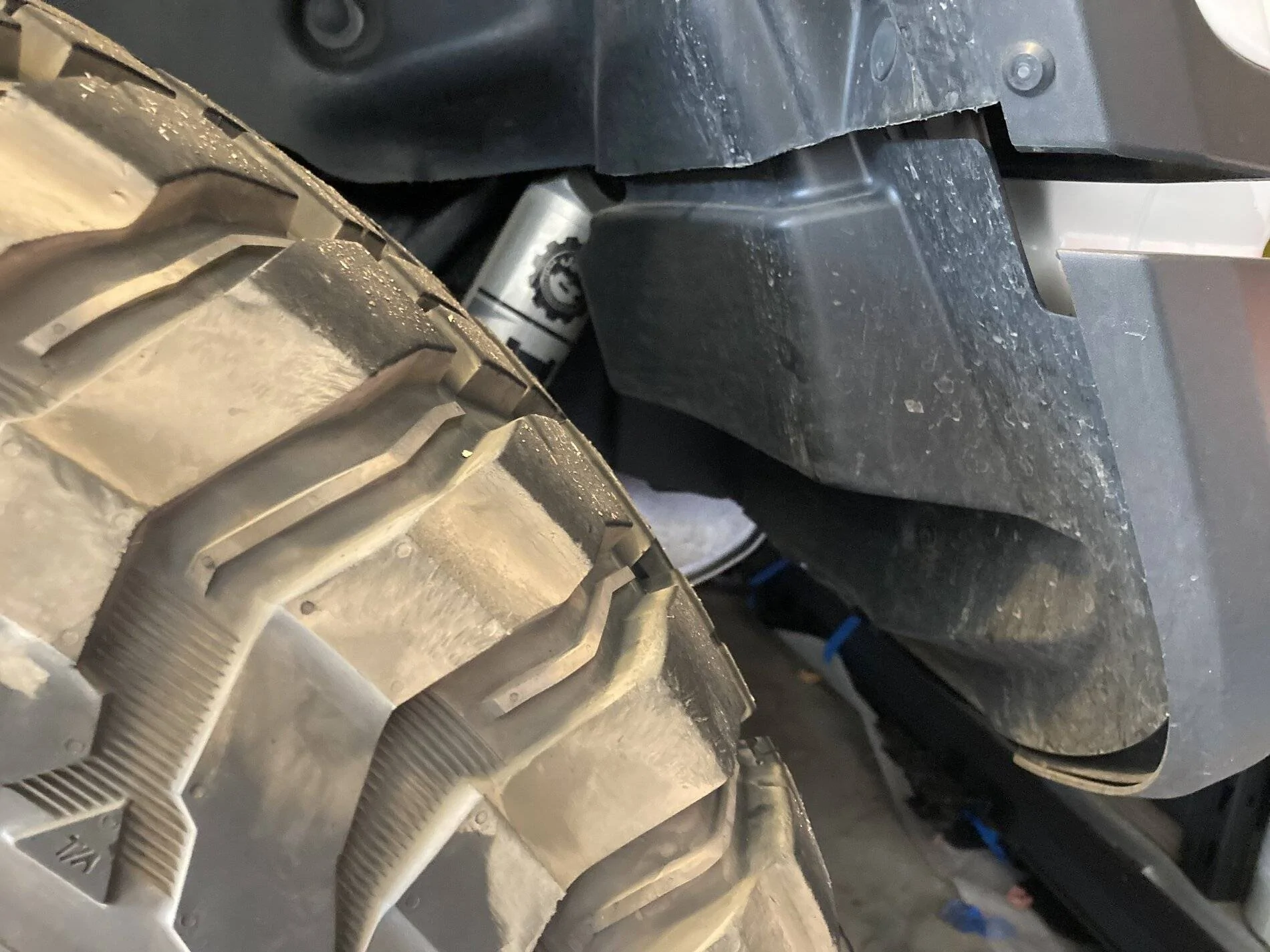

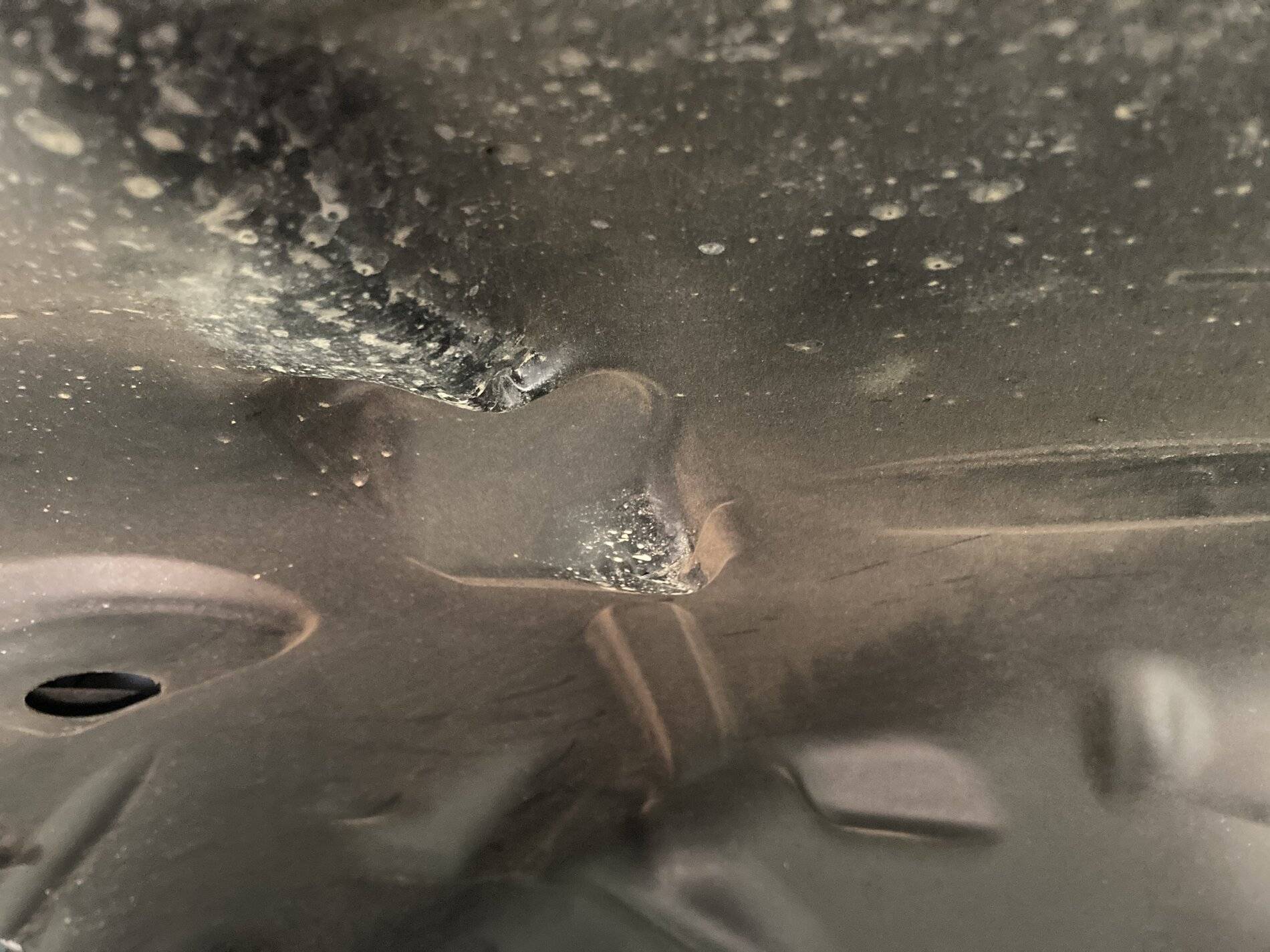

Pictures of rub locations.
These are the two lowest spots on the ceiling of the front inner fender well. They surround a bolt location that is tucked in the recess. Tires just barely tap this location at full lock + stuffed.
