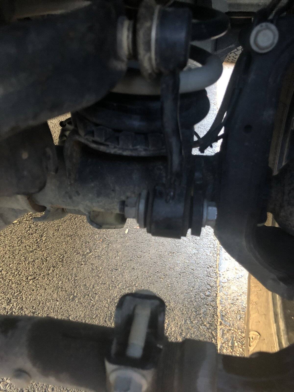

Hey everyone, I have a noobie question. I am going off roading this weekend and to prep I was practicing disconnecting my Sway Bar and reconnecting it. I am not overly technical and this is my first time so I wanted to try it first before I ended up on a trail looking clueless. I was able to get the driver side no problem. I was not able to get the passenger side though, it actually looked different than the driver side. Is this normal? How do I go able disconnecting it? Do I need a special tool? I was not able to get the wrench or socket it in. Please see the pics below. First pic is the driver side. Second is the passenger. Appreciate your help! Driving a 2020 JLU Willys

That’s a flag nut, you don’t need any tools on that side. Just untorque the bolt from outside.
Also can google flag nut if you’re still confused.

The passenger side has a "flag nut" on it, no need for a wrench or socket on the inside. The flag nut will rotate until it hits the metal while loosening, then the bolt will back out. After removing the bolt the flag nut will come out just like a regular nut would.

Thanks for the quick responses! That makes sense. I didn't even attempt to mess with it since I wasn't sure. I appreciate the help!
