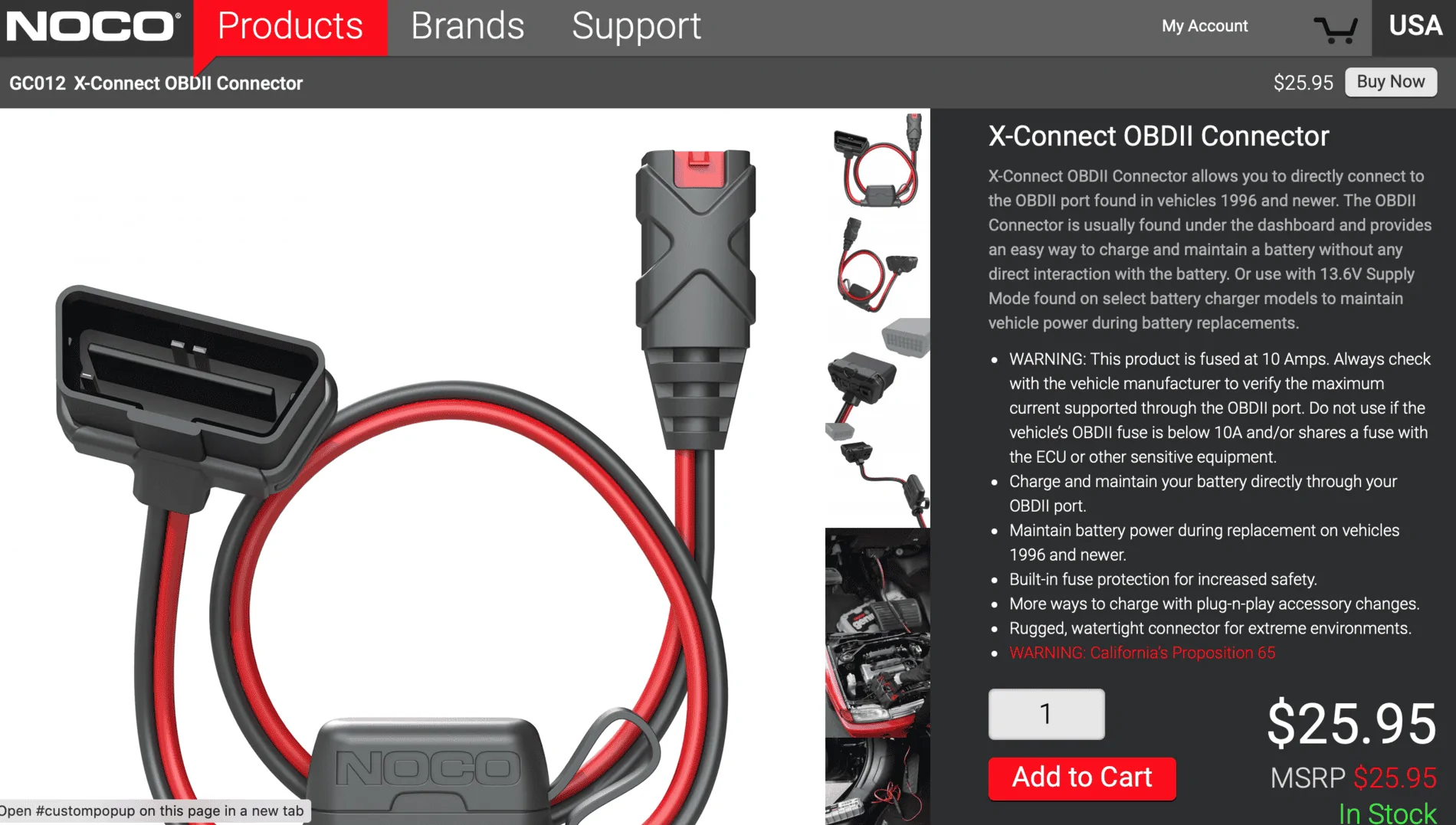

Just wondering if this device can be used to trickle charge the battery(s) on our JL.

...huh?
Some of the reviews on Amazon (considering they're genuine) seem to indicate so, but with some installation.
There's one from an apparent TJ owner.

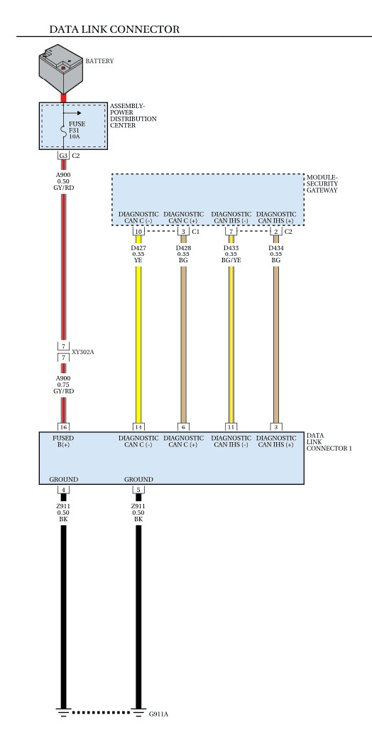

Found this wiring drawing of the connector here on this forum. Seems to be OK as trickle charger is working.
