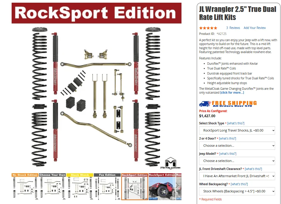

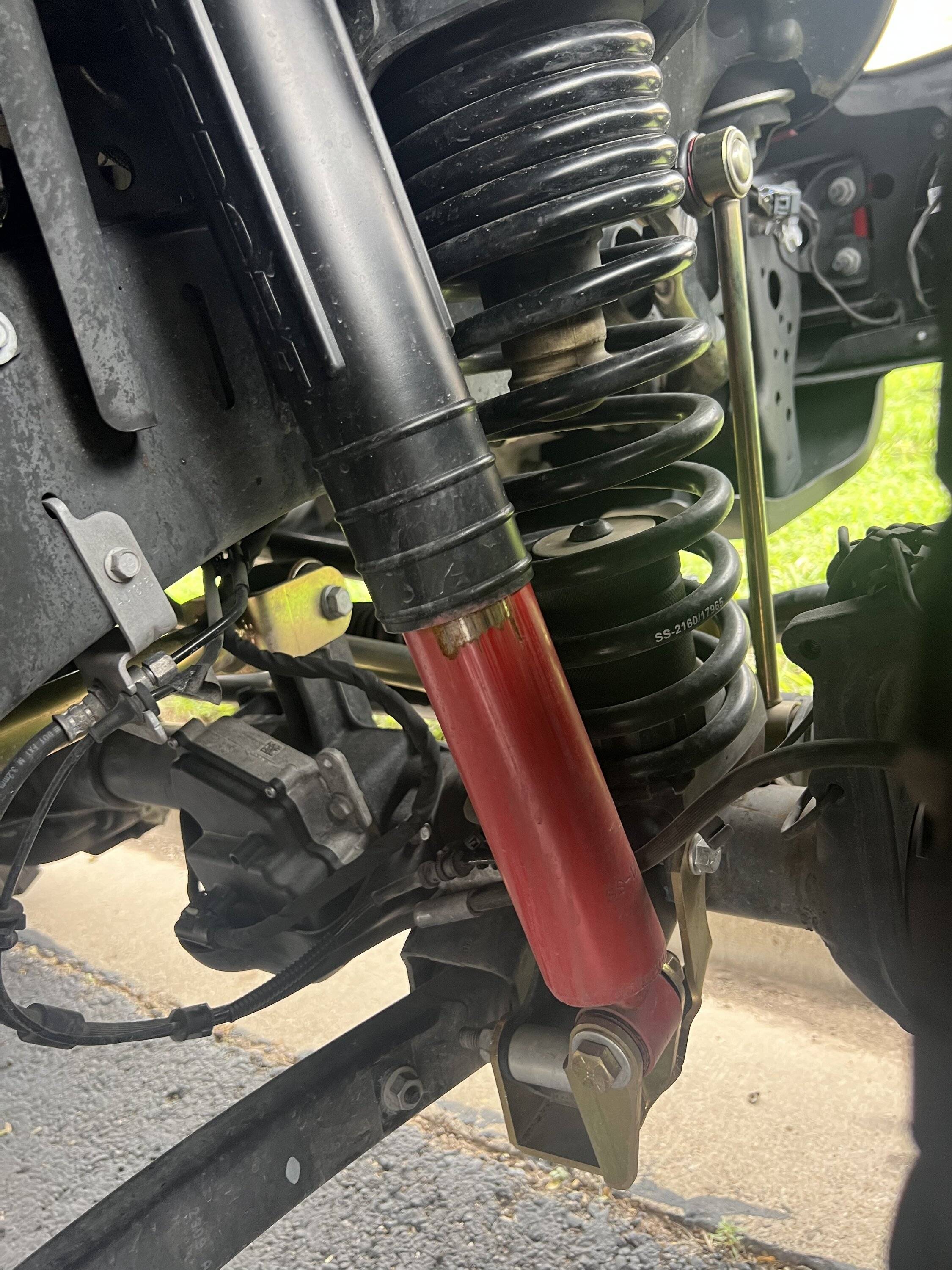

Looks like 3" of bump up front, so you should clear 37s without modification. May scuff the inners a little at full stuff.

THIS is confusing me as it “looks” like a shock extension/relocation bracket.
Metalcloak's outboard front shock mounts.

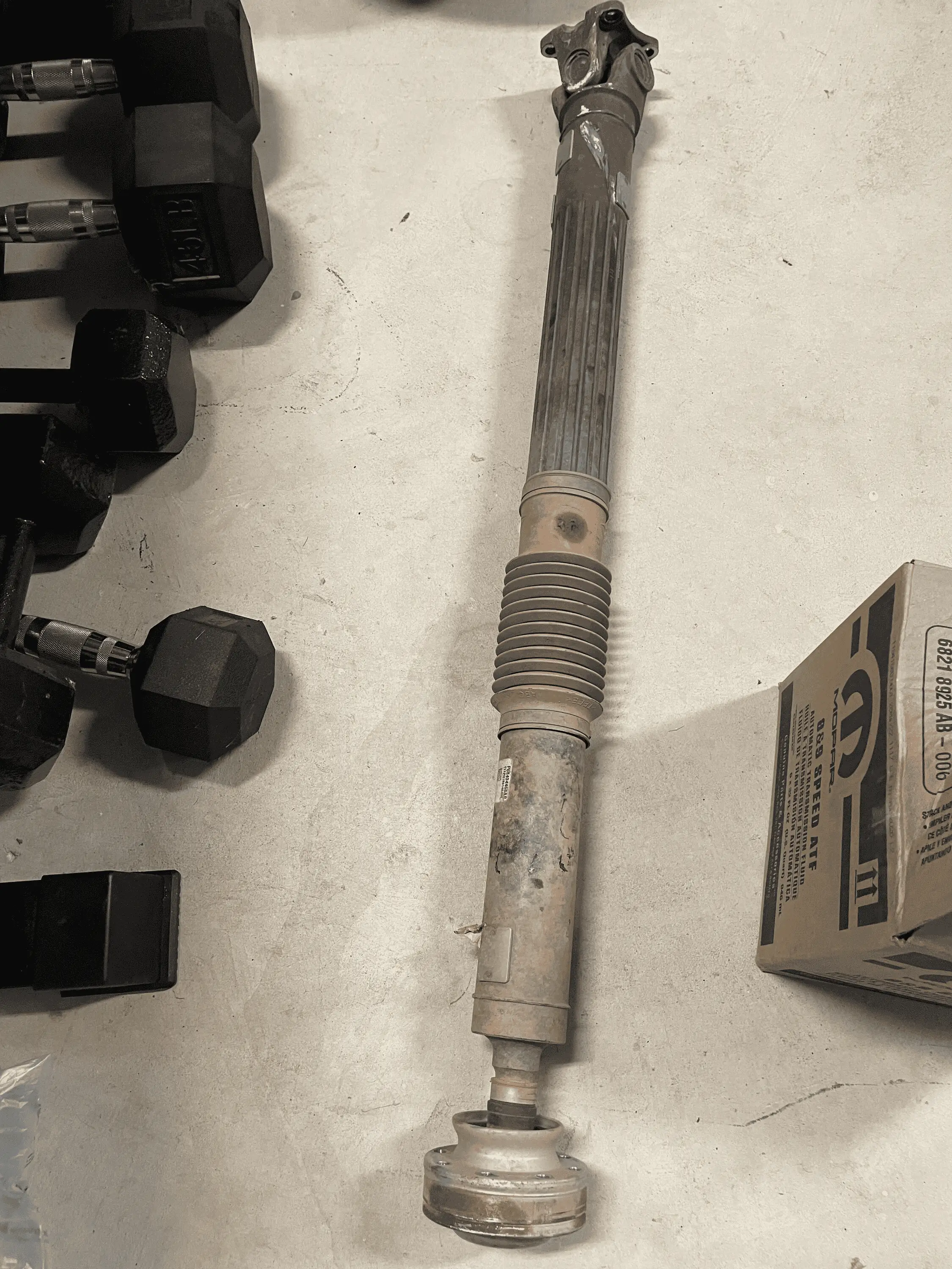

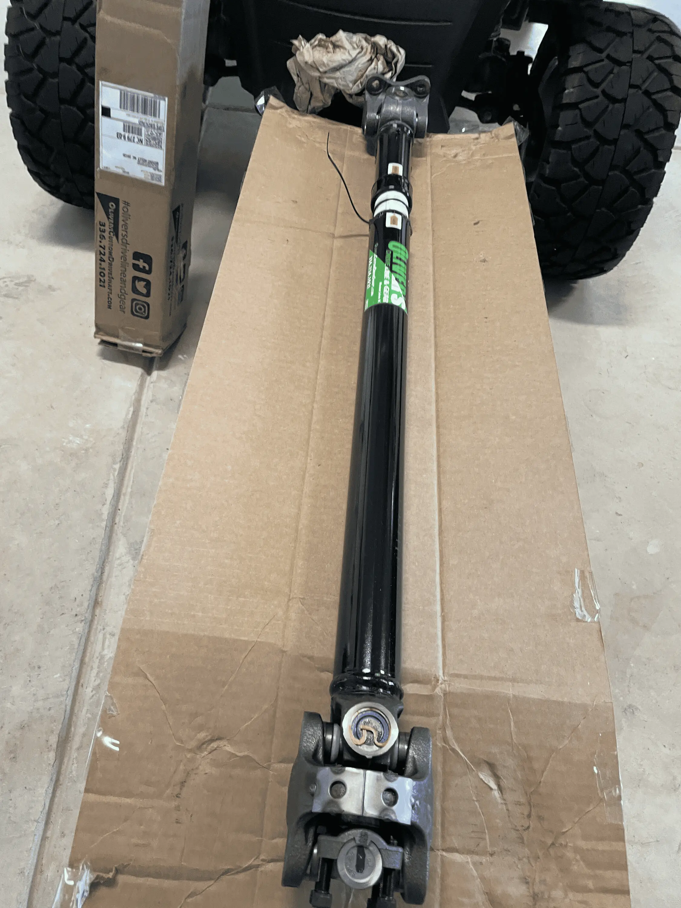

Double check and make sure you have an aftermarket front drive shaft.
What would he be looking for? I don't know my self : )
GATORB8
May 30, 2021
8,831
11,726
CLT NC
21 JLURe, 06 LJ, 25 HDZR2
Two U joints at the transfer case end. Stock has RZeppa. And it will be half the thickness.

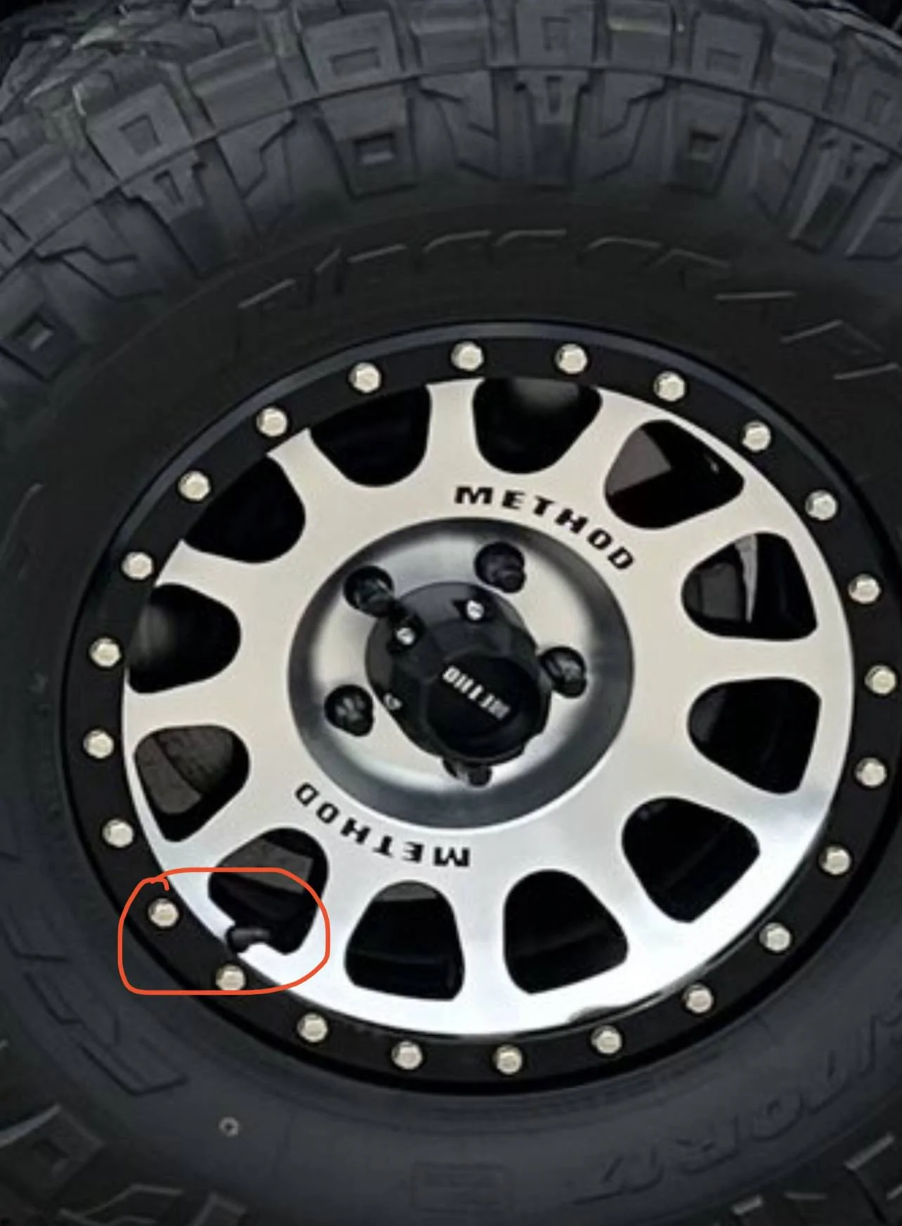

Glad to join the jeep community . Just purchased my first jeep ever …. So not familiar with a lot of things related to the vehicle (usually owned sports cars)
Jeep is a 2020 rubicon recon , it did come with bead lock method wheels and 35’s … wondering if someone can clarify if this jeep was lifted by the pics below or if anyone Can point me in the right direction as to how to find out . Thank you in advance
Definitely got lift details from @GATORB8 Just FYI, the wheels are bead lock simulated I believe

You guys are right , wheels almost look identical , how will I be able to identify ?
BDinTX
Brad
Jul 18, 2020
49
2,947
5,460
Dallas, Tx
I think @hoag4147 nailed it with the valve stem

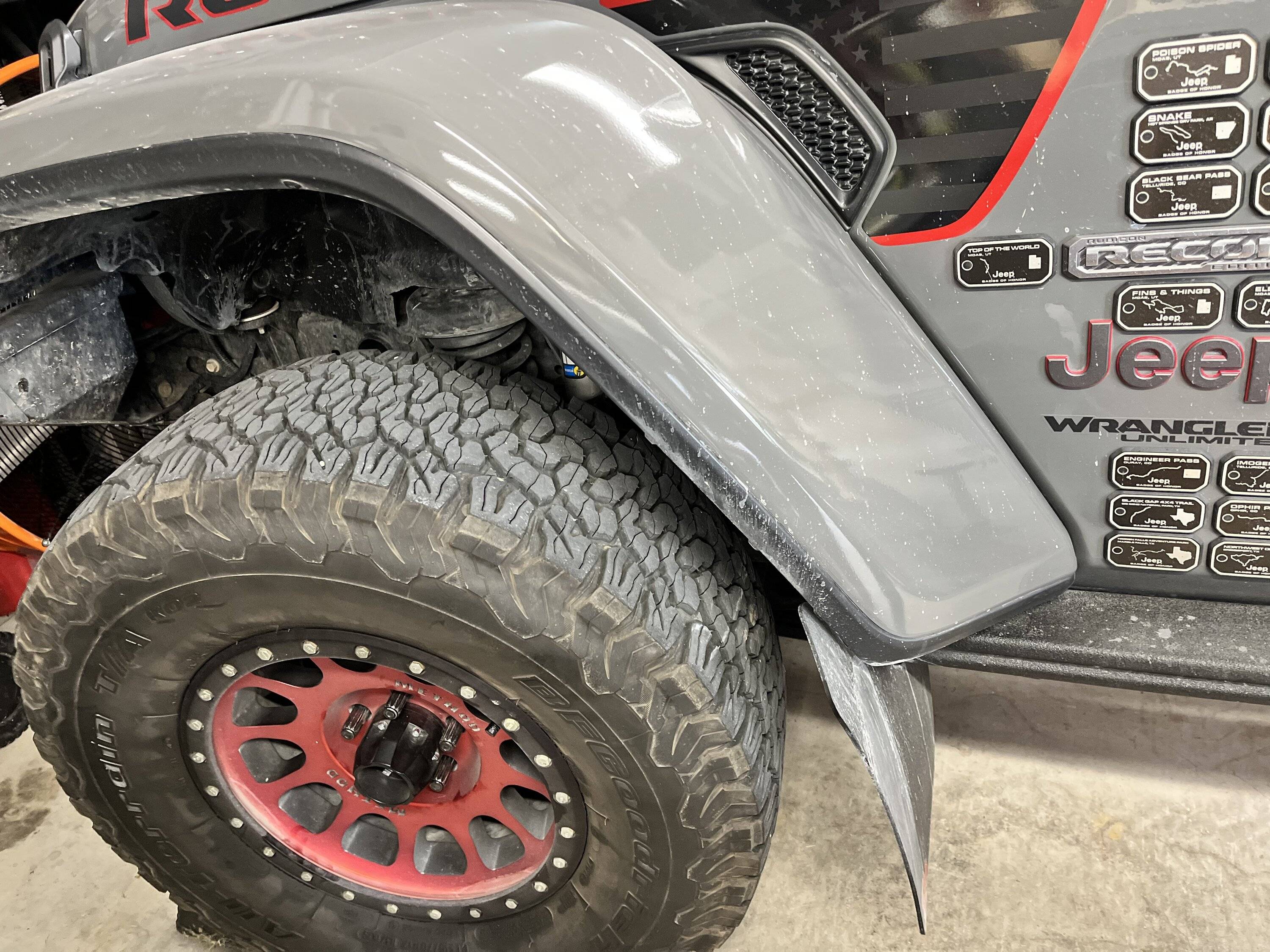

We have the 305NV in red on a 2020 sting grey recon lol
Water collects inside the lip and is a pita…
