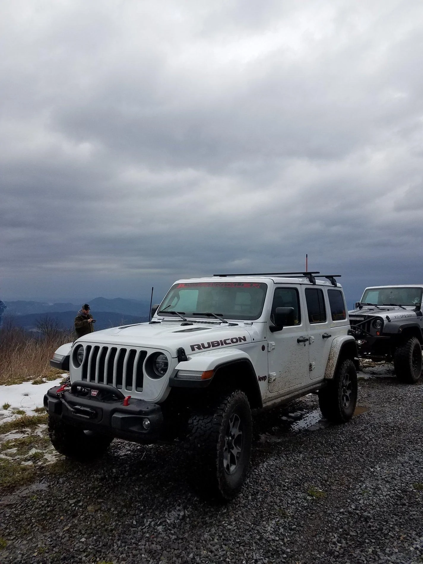

Looks great with 35s like you have. I think the 37s look a little crowded not as much wheel well..
Jeep Wrangler JL New Rubicon Express 2" Budget Boost 20180324_122811
Yea, just like I wanted a little extra room for 35's, I'd be stressed pushing that disconnect button with 37's. You can flip the rear bump stops for running 37's though. Fronts what I'd be worried about.

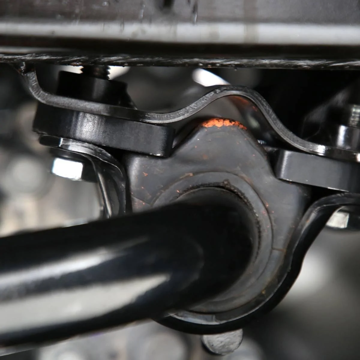

I went with the RE kit because the shock extensions looked beefier, the spacers are wider with index holes for the isolaters and I liked the way they drop the front sway bar. RC comes with new sway bar end links.
I guess you answered my question partially, the RE is beefier shock extensons Then?
But how does the RE kit "drop" the sway bar?

My question on the difference between the RE and RC kits is
1. The shock extenions, is the RE a thicker/stronger metal?
2. The sway bar links, the RC comes with longer replacements and the RE doesn't, how does the RE not need them?
Yes, the shock extensions are thicker than RC. I actually called RE to ask them, the front (most important) is addressd with the sway bar drop brackets which I like. But, the rear, they said on the JL they are not needed and you don't lose anything with the 2" of lift. I've taken the kit off road on 4 different trips and it has been great. Who knows.
