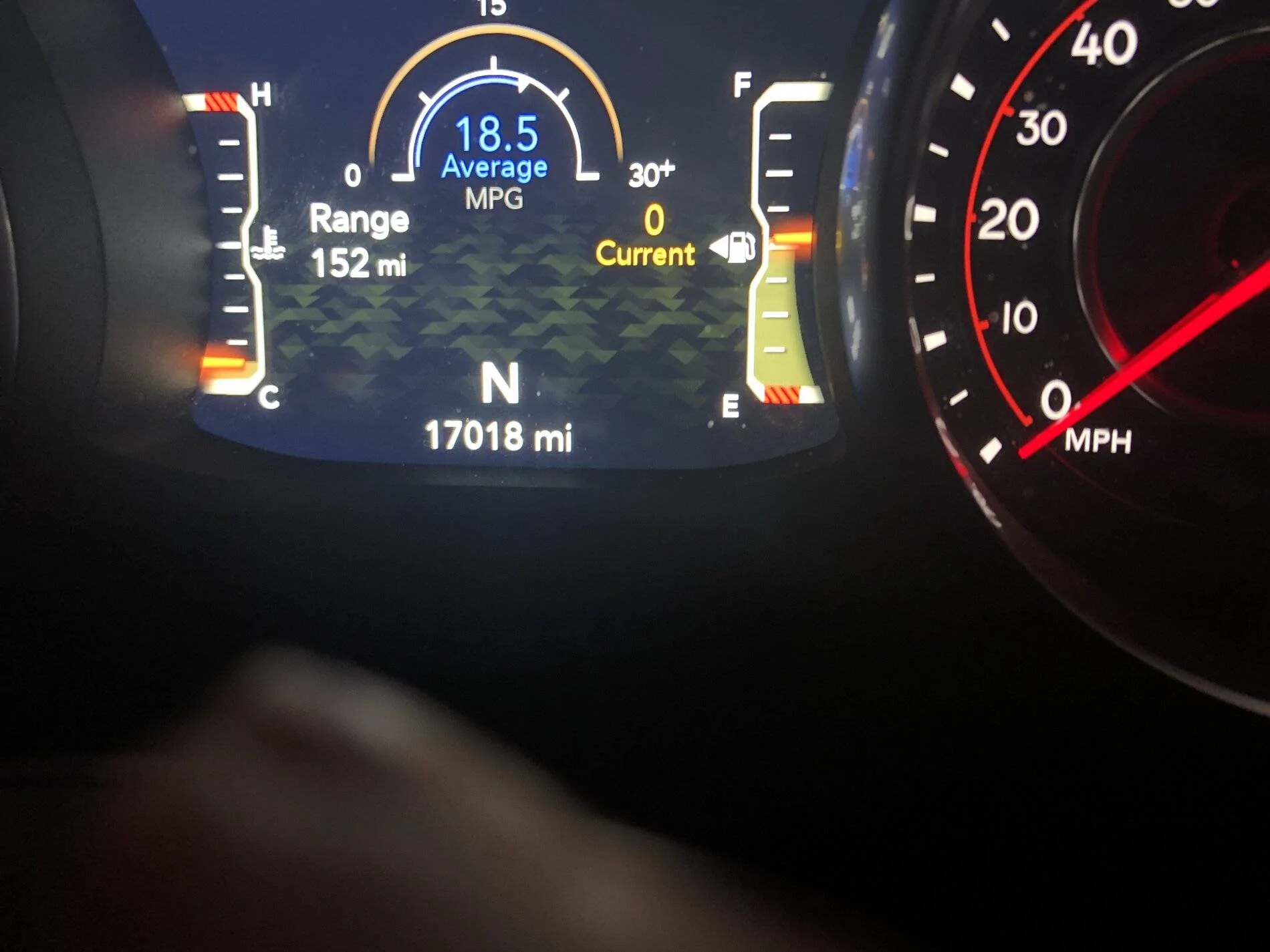

So now after my Jeep downloaded the new update on my screen it's now showing the shift numbers on my manual as I drive. You can see from the picture it's now in neutral. Does anybody know why>

I know there is a setting for that along with what gear. the transmission is in. you access it through the cluster setup menu to turn it on and off. the update might have just turned it on. stat scrolling through the options and settings for the cluster

That indicates that the clutch recall has been completed. The resolution is a software fix, it uses an algorithm that predicts what the temperature of the clutch and friction plates would be based on the driving habits of the driver and variables like rev hang. If the suspected temperature supersedes the allowable temperature, the Jeep will transition into limp mode to avoid catastrophic failure of the clutch and hopefully, not burning the Jeep down.
Here is the Service Recall Bulletin: https://static.nhtsa.gov/odi/rcl/2021/RCLRPT-21V028-2204.PDF
https://www.jlwranglerforums.com/fo...uals-overheating-clutch-pressure-plate.47887/
Tons of threads on this issue here.

I spent a half hour looking through the settings and can't find it. However one of the guys in the group said it appears when the manual trans safety recall Y-07 was done and yesterday it was done

Where can I see that in the manual? And does that mean I can shut it off. To me it's annoying
https://cdn.dealereprocess.org/cdn/servicemanuals/jeep/2018-wrangler.pdf
Start at page 186.
Screen Setup
Push and release the up or down arrow button until the Screen Setup Menu Icon/Title is highlighted in the instrument cluster display. Push and release the OK button to enter the sub-menus and follow the prompts on the screen as needed. The Screen Setup feature allows you to change what information is displayed in the instrument cluster as well as the location that information is displayed.
