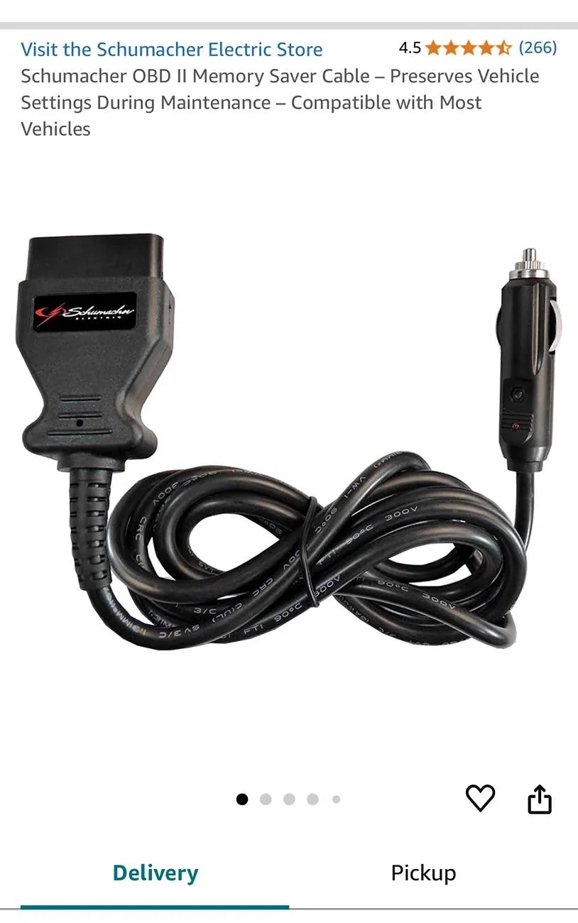

Ca
I lost the main screen “security code” required. Contrary to reports even by the service writer the vin# to parts couldn’t get it. After failing to retrieve it he called the computer tech to try, nope. Wouldn’t reset without the security code, $110 to pull the radio for the serial # on the back to get it. … This may not be common but happens. If you don’t want to gamble keep the system powered. This is one option, others are battery powered.
Jeep Wrangler JL New Battery Installation IMG_2029
Some mfg’s supply the code with the vehicle. I was also told a 9V battery connected to the cables works when I posted the “battery nightmare” thread.
