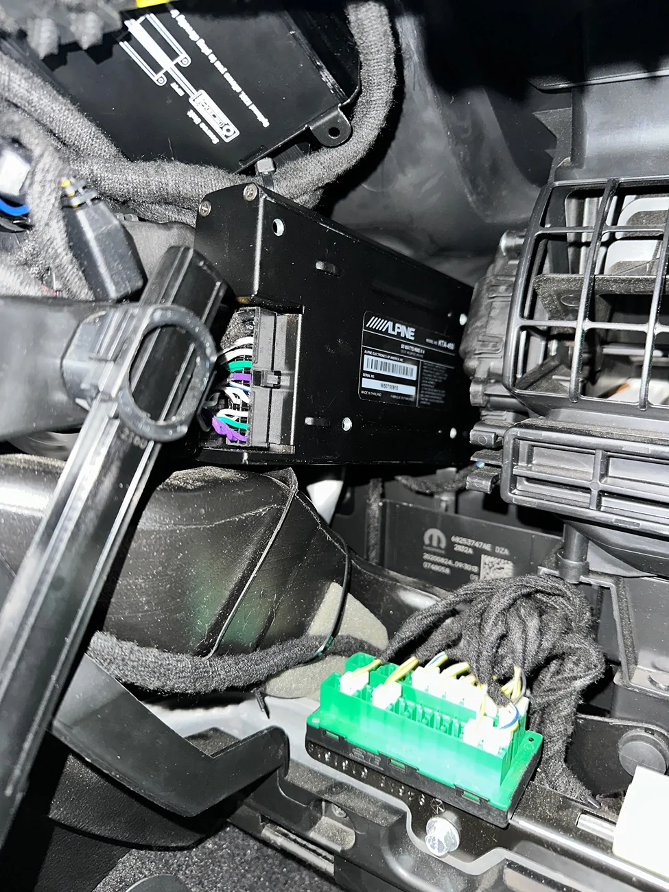

Wait .. I'm trying to figure out that second picture. Where is that, and what orientation is it? Is that under the dash up front, or did you have to remove the passenger seat to do the work??
That is behind glovebox between the heater core and fan. I could've extended the wires and ran it to under the dash on the drivers side where the stock amp goes, but couldn't find just the stock amp bracket to attach the amp.
So what exactly is under your passenger seat, and what's under your dash? If you don't mind me asking. I'm just wondering what you've added to your (apparently?) 2-door Jeep.

The load pack interface and the speaker amp are under the dash.

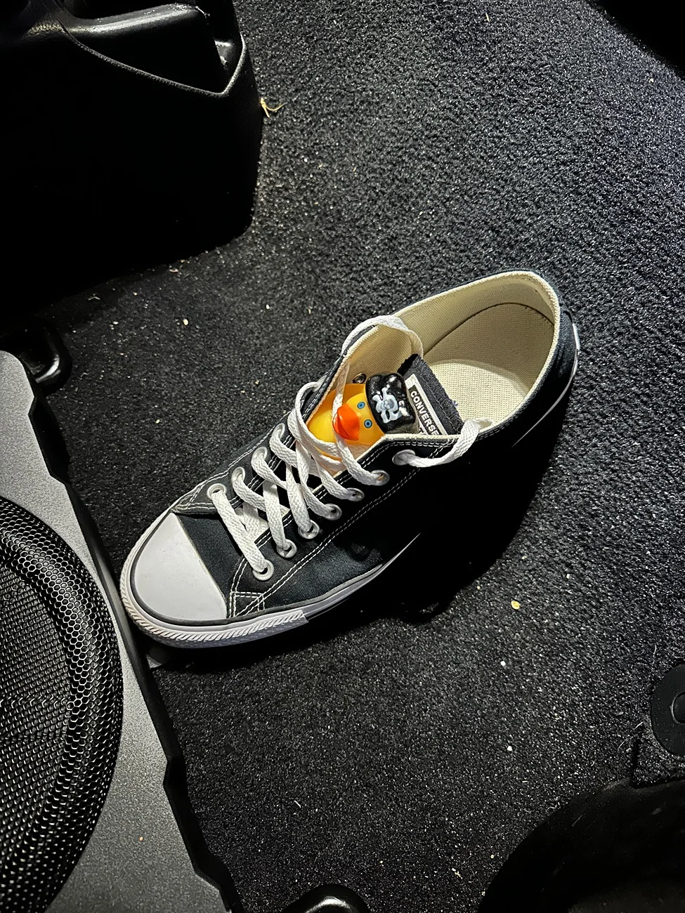

The Kicker HS10 is under the drivers seat, nothing under my passenger (maybe an air compressor at some point).
