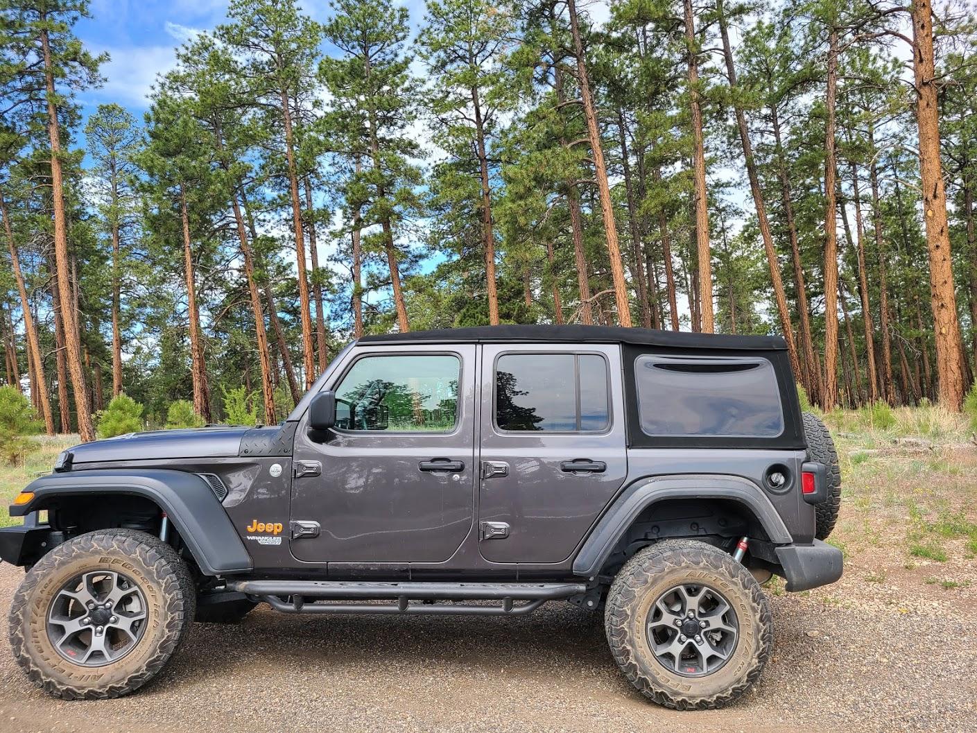

Here's a picture of my Jeep. As you can see, the rear axle isn't centered in the wheel well after the lift.
What would you guys recommend for improving her ride and bring the geometry back to stock without breaking the bank?
