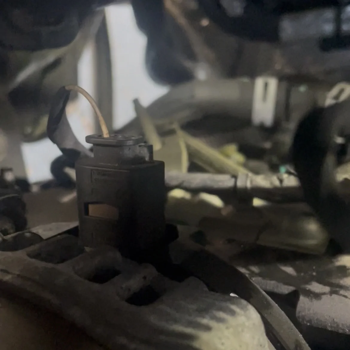

Ok, the other wire that clips on, actually it appears there is only one wire on this clip, not two.
Hm, yours is different than mine then. I'm assuming that is the voltage request wire from the pcm. It should have some kind of voltage on it. If it does, your alternator is bad.
What engine do you have? I can try to look up your diagram ...
2.0 (2022)

Yes, that is your command line. If it has voltage and alternator is still not producing, alternator is bad.
Just a caveat though, I had a bad battery that got so low that the PCM actually went into a protection mode where it wouldn't command voltage from the alternator. Replacing the battery restored the signal on that line for me. I was very close to replacing the alternator before I discovered that. But it sounds like you've already replaced the battery.
