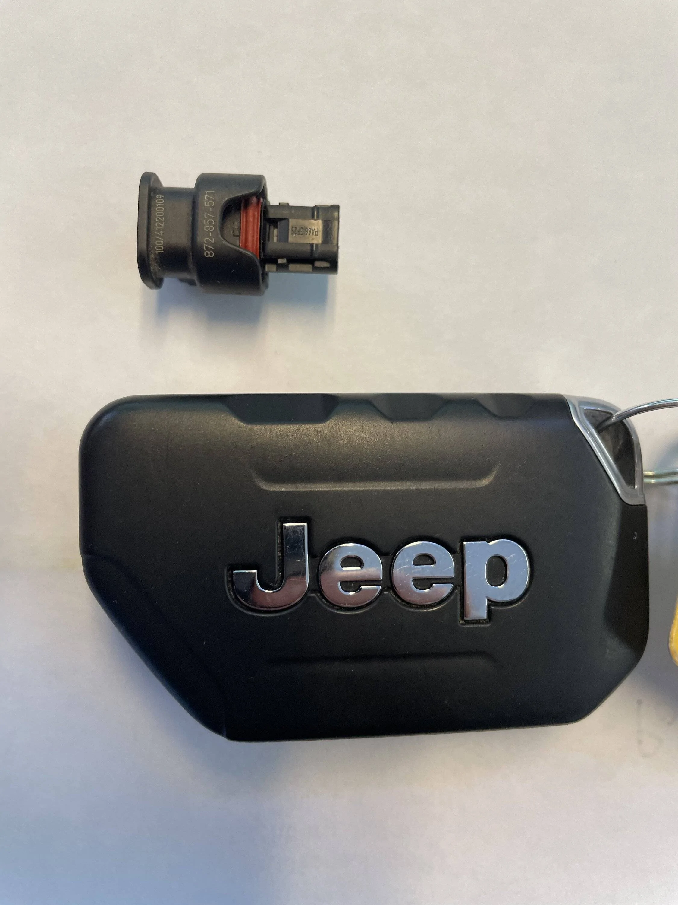

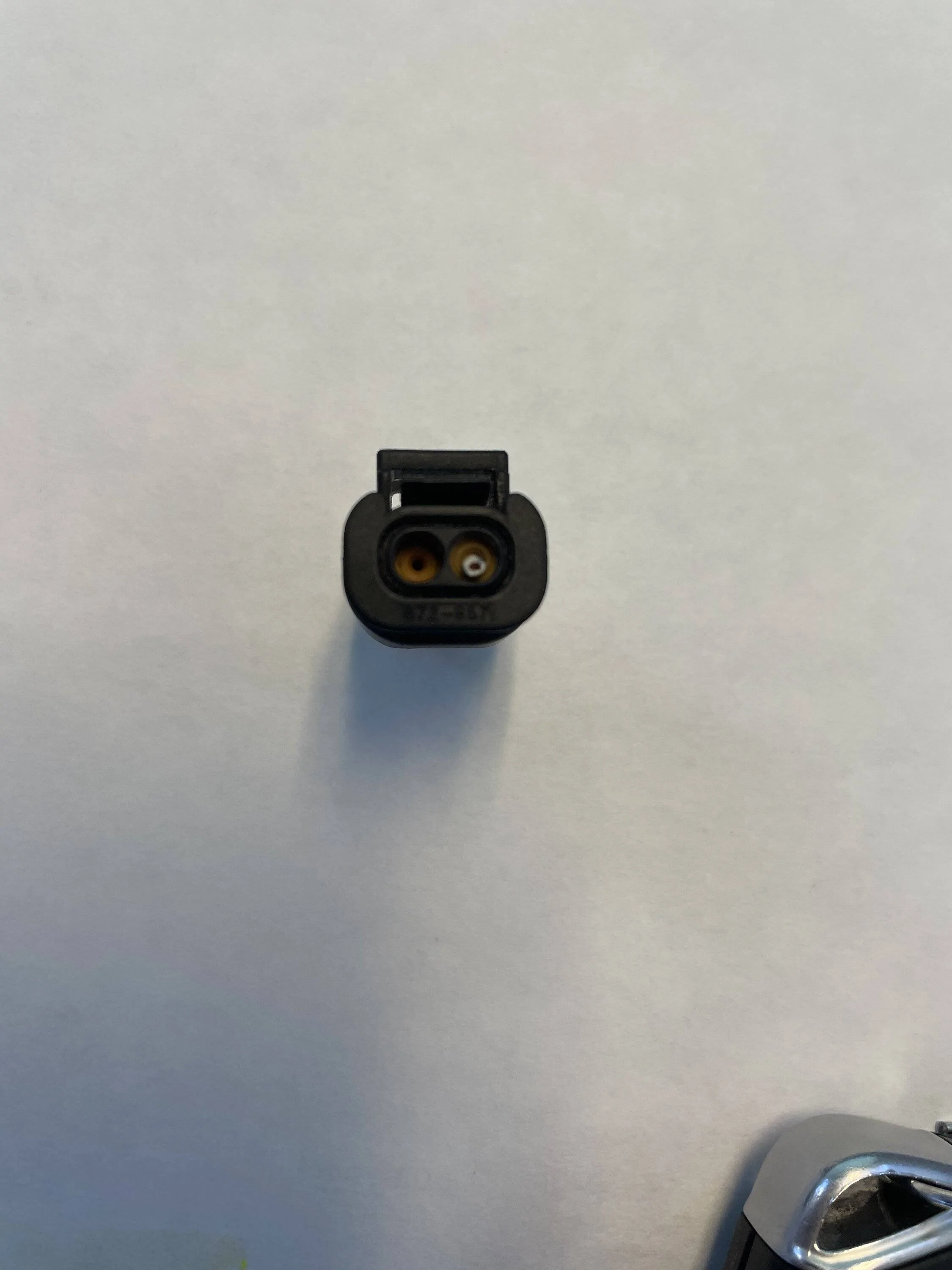

Had a freak accident yesterday and pulled my rear license plate housing away from the bumper. This included the license plate light, tearing it away from the connection underneath. I know what your thinking..How?? Don’t ask..?
Can anyone identify this part? Ran all numbers on it in Mopar parts and nothing came back. Seems to be a male connector of some kind that plugs into the LED license plate light. Pulled away from wiring underneath, that seems to go to backup sensors. Hoping I can attach new part to wires under bumper where it came from.
Any help would be greatly appreciated!

I haven't seen the connector available separately, but Quadratec has the harness for about $60.

Is it in good enough shape to repin?
That definitely looks like it but says it’s not compatible with 2020 JLUR. Gets me in the right direction. Hoping to just get this harness and not entire wiring package but that’s probably not going to happen. Thanks for the info.

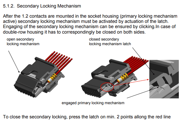

Not sure what you mean by that. Does this piece come apart?
There is normally a lock on the pins that can be released and repinned. You would need to source new pins.

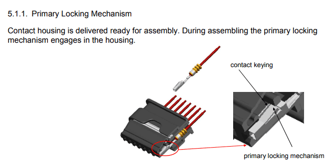

This should be a similar connector, with more pins, would need to reverse (undo secondary, then undo primary):
Jeep Wrangler JL Need help identify part… 1661963099765
Jeep Wrangler JL Need help identify part… 1661963119197
4.1. Usable Contacts with SEAL
Contact system: Mini Lamina Contact MLK-S 1.2 and MLK-Sm 1.2 see Kostal drawing DOC00072546 and DOC00079128 MCON 1.2-LL see Tyco drawing C-1452674
