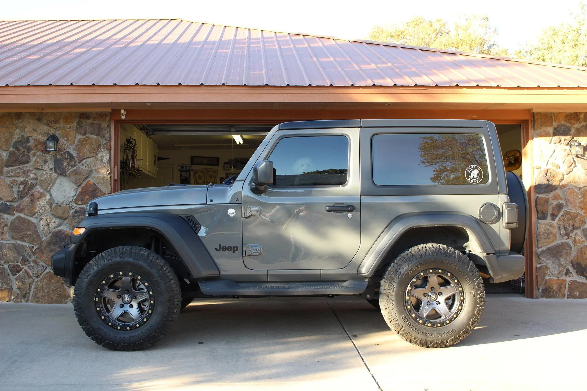

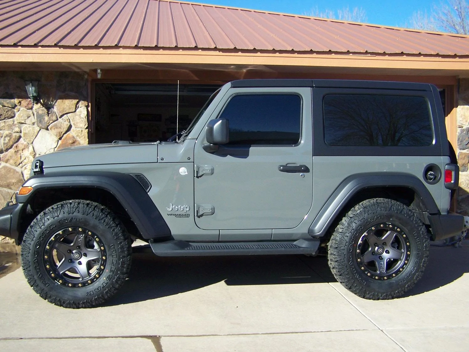

Here they are - Method Roost wheels and Nitto Ridge Grapplers 285/75/17
I know this post is almost a year old, but are you lifted in these shots?
Rig looks great. Just what I am after. Nice clean look. Thanks!
