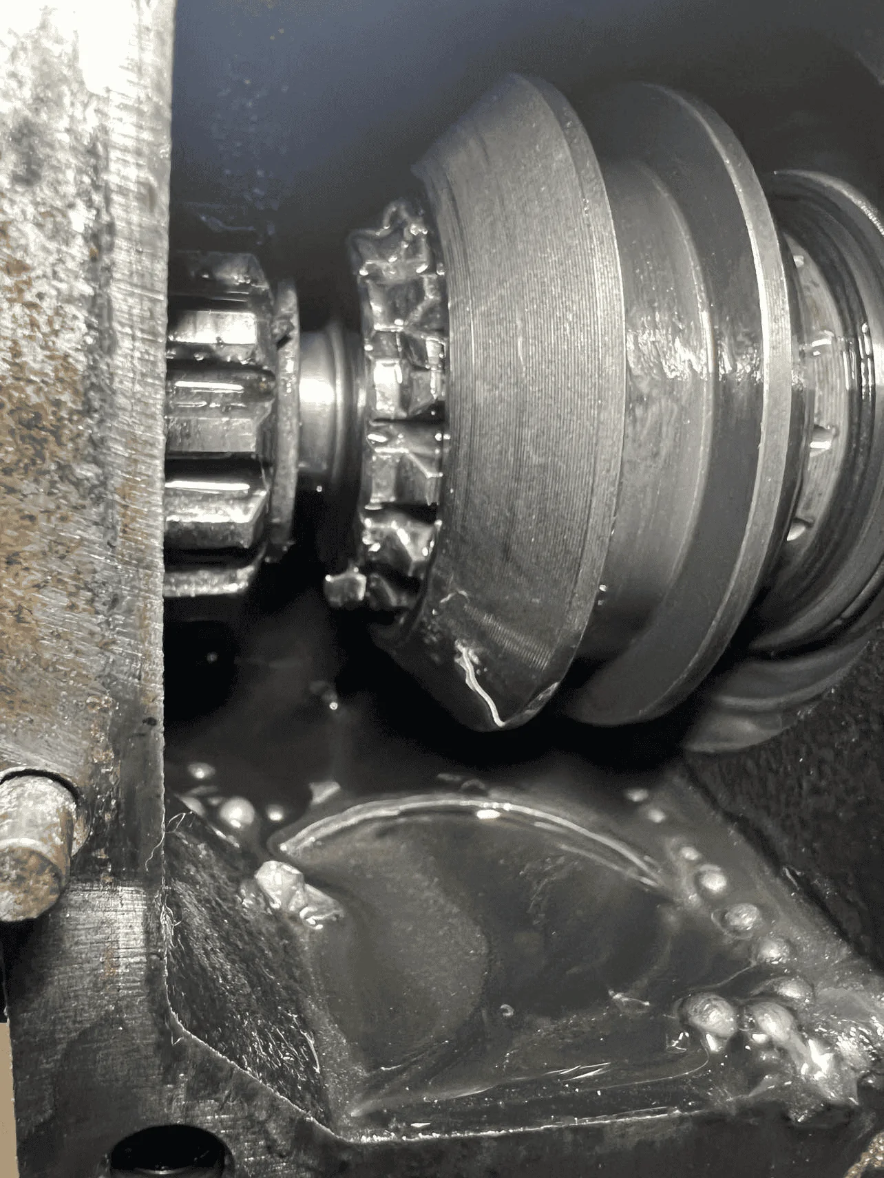

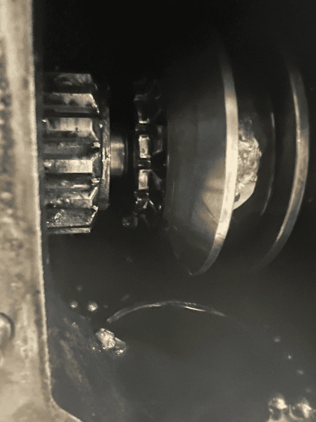

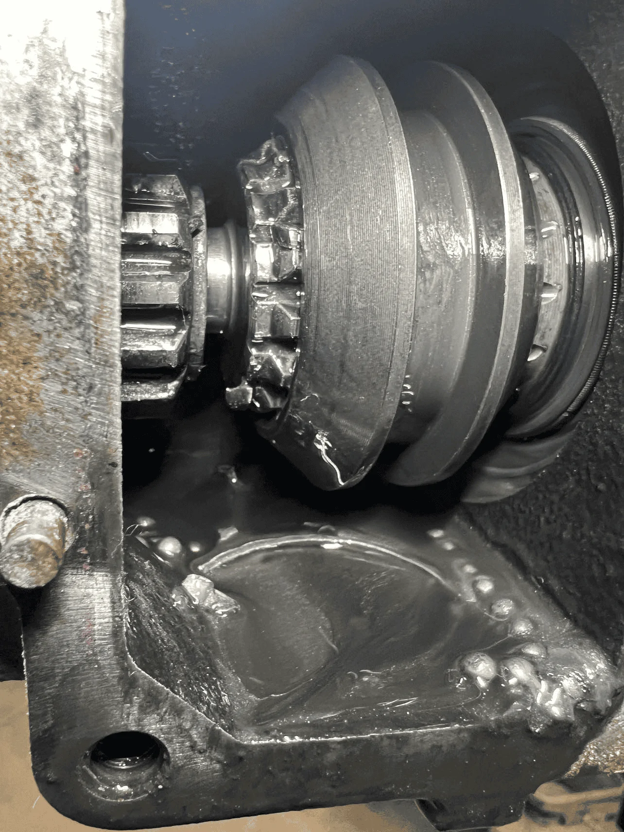

2020 JLUR, and my FAD blew up last week. It must have been going for a while, since it let go in a parking lot with three inches of snow.
It looks like the bearing gave out and the collar wasn't fully engaging. I've never hear of this kind of failure.
I'll be doing a FAD delete and replacing the shafts with a single.
