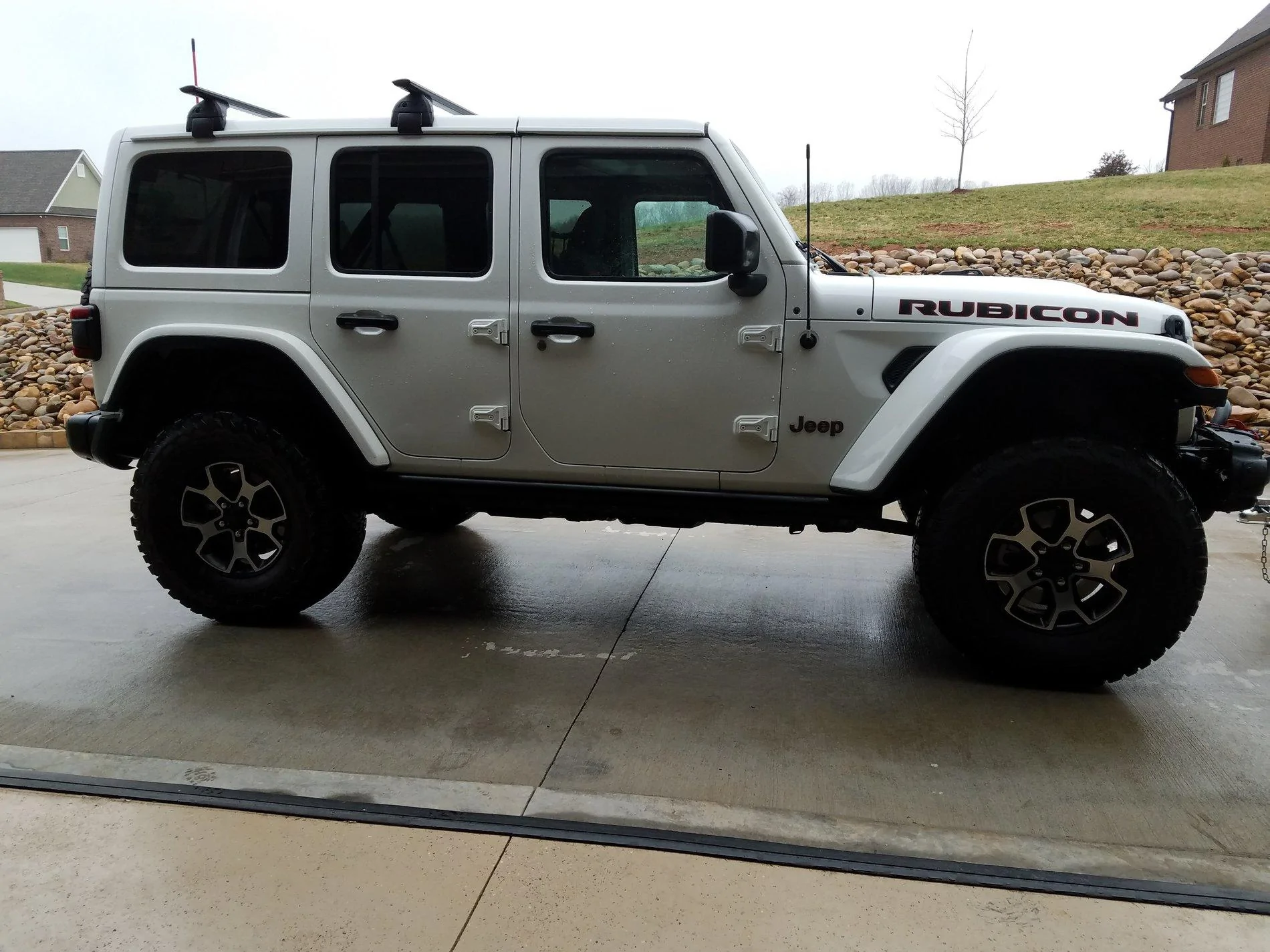

Just received my mopar rack from Qtech (who was awesome as always). One thing to point out. i was wrong in thinking the load was transferred to the roof by the rack tower. It looks like it does in the pics, but it does not. 100% of the load is transferred to the rain gutter. The rack comes very close to the roof, but it does not distribute the load to the roof in anyway. (unless you want to be pedantic and call the rain gutter part of the roof)

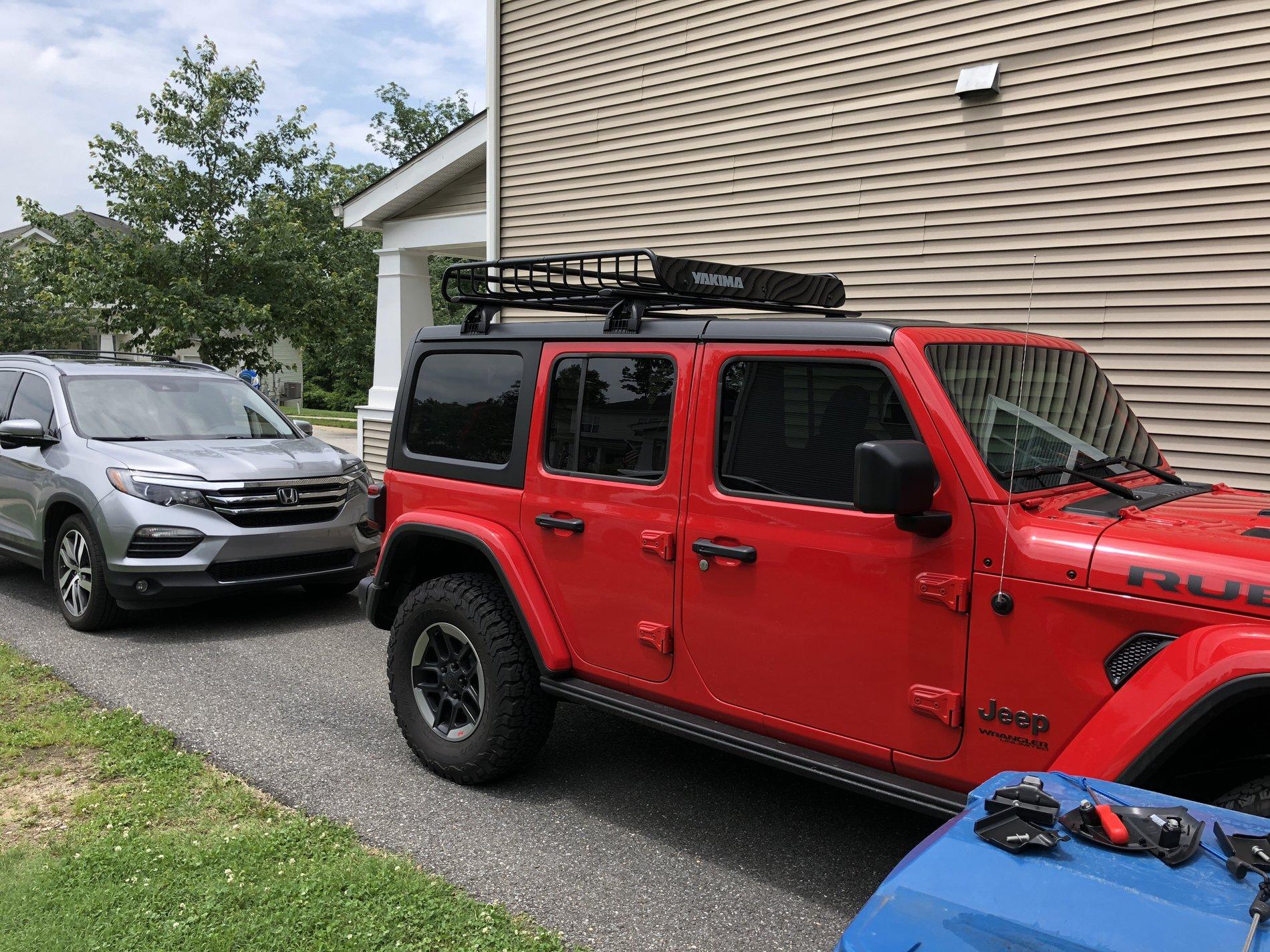

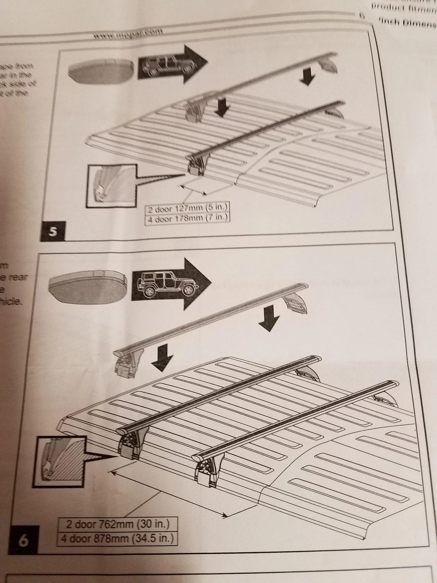

I spaced mine based on the cargo rack I installed. Didn’t even realize the instructions had measurements to use. Also, had to adjust the width of one of the crossbar footings and tweaked the brackets a bit so they would sit flush against the outside of the rain gutter when I bolted them down.

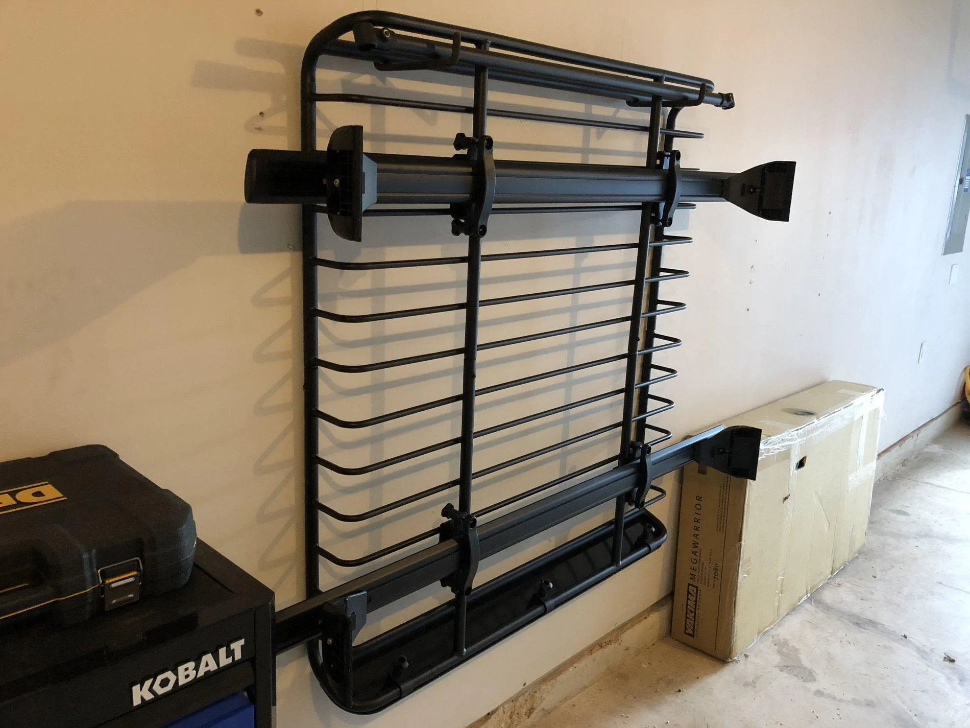

I remove mine when not in use. Since I have a cargo rack installed it all comes off as one piece which makes it easy.
Long term plan to to install a platform base rack that bolts to the roll cage. I’m leaning towards the Rhino Rack Backbone system and 72x56 platform. On the JK this is rated 269lbs dynamic and 700lbs static. Perfect for a rooftop tent, etc.
Right now current setup hauls light camping gear, shovel, and hilift jack.
For the OP, would think you could mount to the freedom panels no problem. Just you won’t be able to remove them with the rack on of course.
