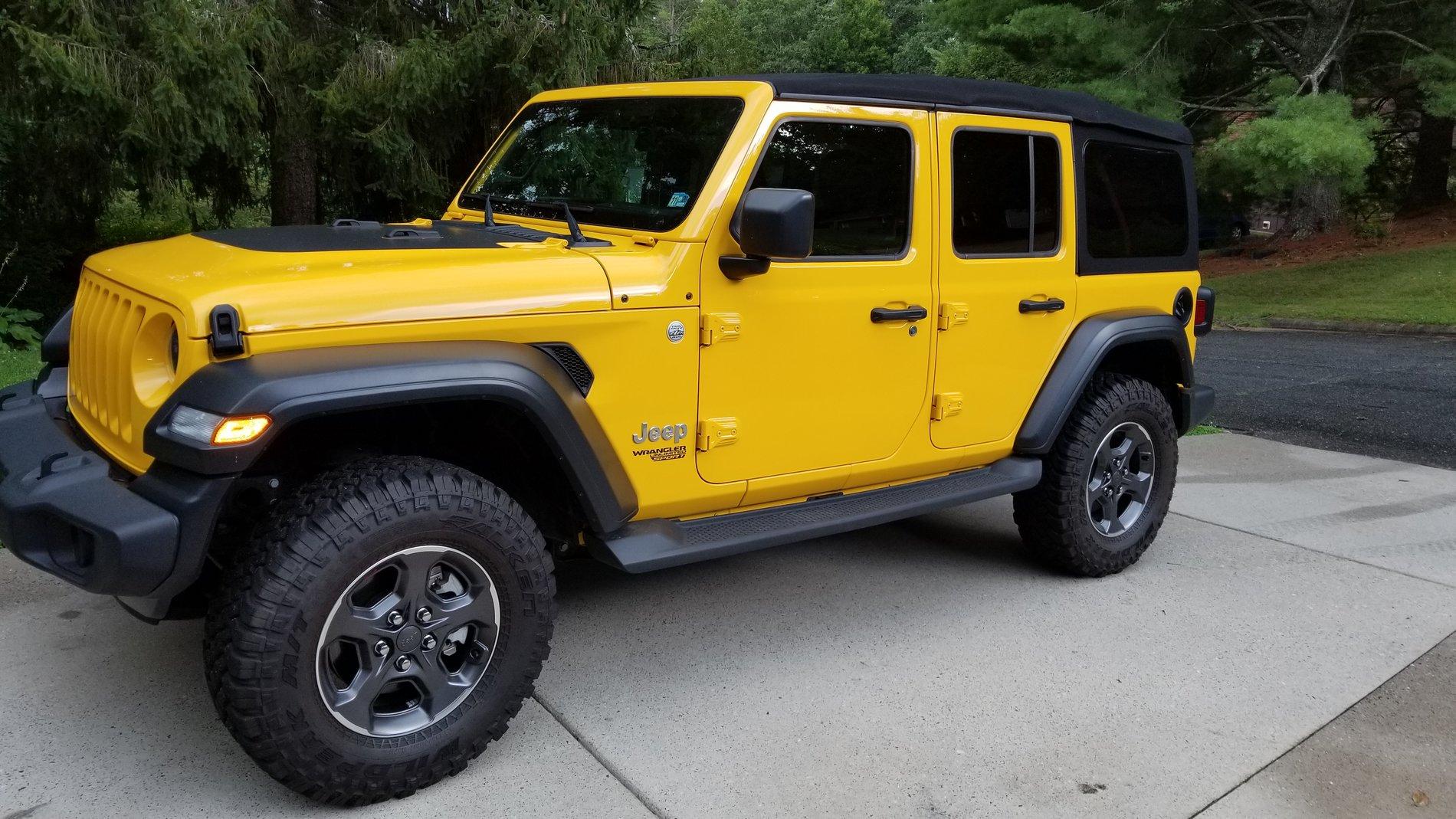

Jeep Wrangler JL Mopar LCA's 20200728_170128
Completed the Rubicon suspension upgrade with the Mopar lift kit LCA's. Gained a little over 1.5 inches lift on the stock wheels and tires; then added the Gladiator Rubicon wheels and tires. The tires are the 33inch Falken Wildpeak MTs. Steering feels much tighter on the road, and Jeep rides great.
Next thing will be to remove the minivan side rails and add some good rock sliders that can double as a step.
