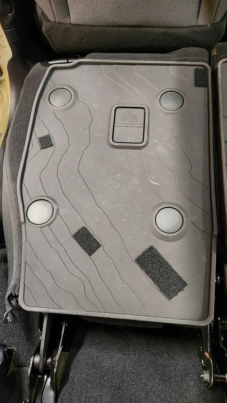

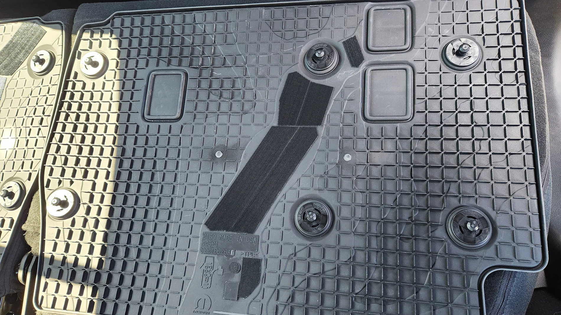

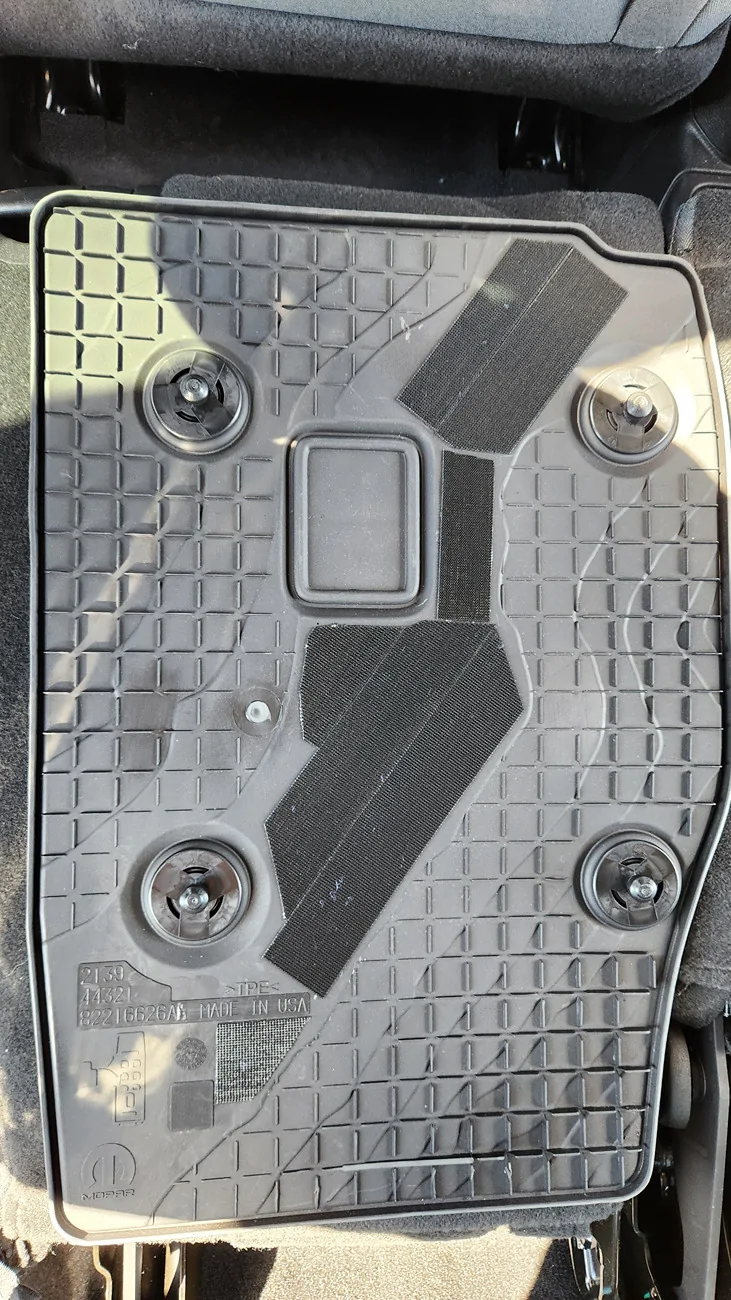

Update: I decided to try using Velcro to hold the mats in place. It wasn't pretty, but then again, neither is having holes in the back of the seat. At least this way, I get the benefit of having the mats installed.
First, I used adhesive hook-side Velcro on the bottom side of the mats. Due to the design of the mats, there were only a few flat spots that I could actually use the Velcro. See images below.
Jeep Wrangler JL Mopar Cargo Tray (82216627AB) issues 20250912_142821
Jeep Wrangler JL Mopar Cargo Tray (82216627AB) issues 20250912_143635
This Velcro actually stuck to the back of the seats really well. So well, in fact, that when I initially tried it before the adhesive was fully cured, the Velcro wanted to separate from the adhesive side rather than the hook side.
I let the adhesive fully cure, and it seems to hold better; however, I would still be skeptical if I were planning on constantly removing the mats. Since the intent is to leave the mats in place, I think it will work. The hook side has no issues holding up the weight of the mats.

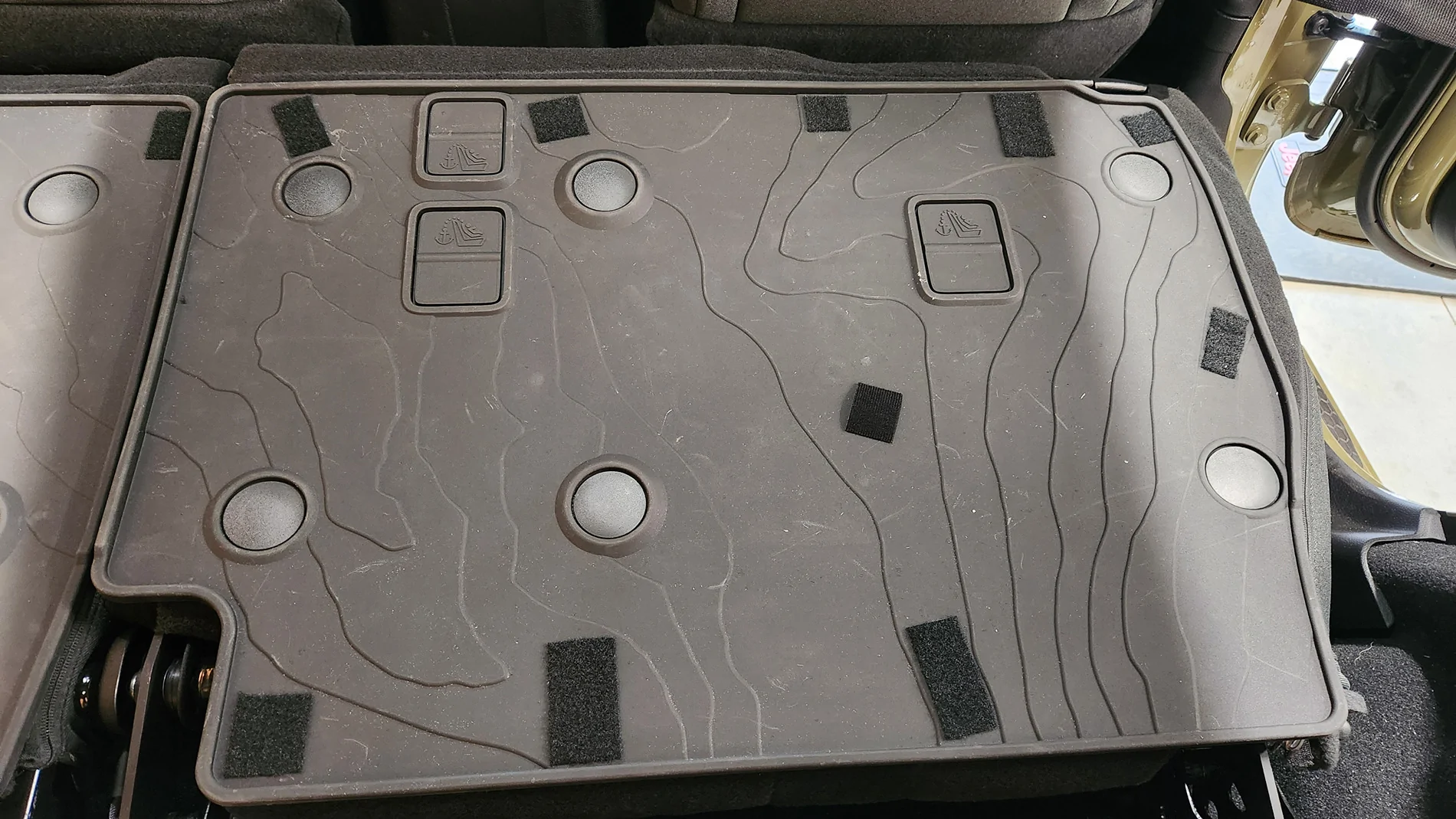

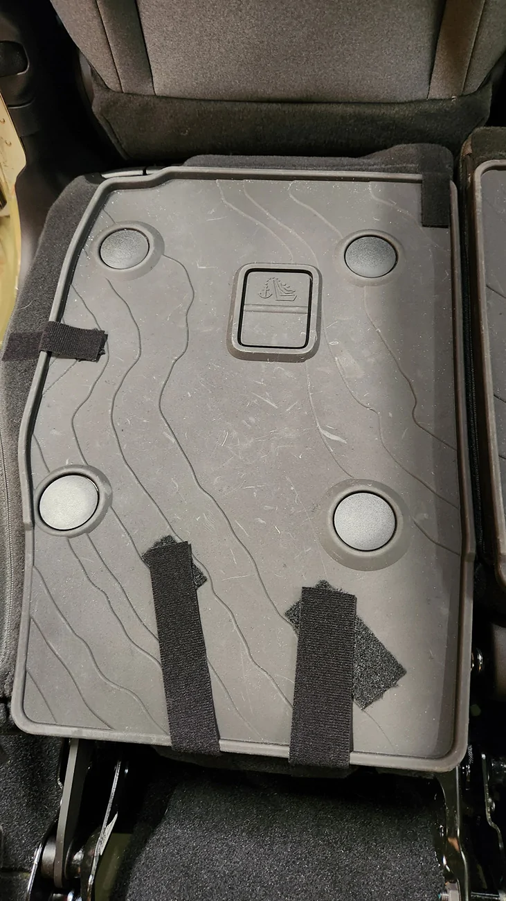

But...due to the placement of the Velcro, the edges of the mats were a bit floppy , especially the larger mat. So, I decided to try to secure the floppy edges with more Velcro.
This time, I used loop-side adhesive Velcro on the top side of the mats; I did have similar issues with placement of the Velcro on the top side as I did with the bottom side, as there were limited options with flat surfaces. I then used double-sided Velcro (hook on one side, loop on the other) to attached to the loop-side Velcro and the seat itself. See images below.
Jeep Wrangler JL Mopar Cargo Tray (82216627AB) issues 20250914_151716
Jeep Wrangler JL Mopar Cargo Tray (82216627AB) issues 20250914_151709
Jeep Wrangler JL Mopar Cargo Tray (82216627AB) issues 20250914_153002
Jeep Wrangler JL Mopar Cargo Tray (82216627AB) issues 20250914_153013

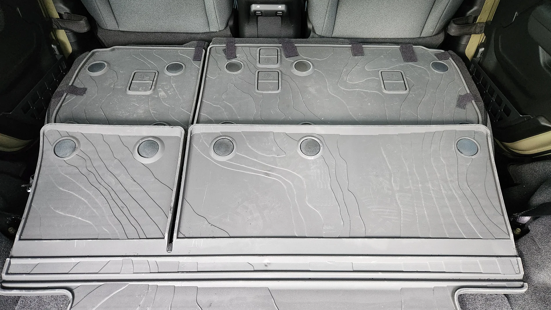

This seemed to (mostly) resolve the issue with the floppy edges. It isn't perfect, and I probably would NOT recommend anyone doing this to their Sport/Willys. I only did it because I already cut the holes in the seats. This is definitely not the clean/factory look that you get with the Saharas/Rubicons. That said, I will likely post updates in the future to see how they hold up over time.
Here is an image of the final product with everything installed (the gap hider that comes with the kit does hide some of the Velcro, fortunately).
