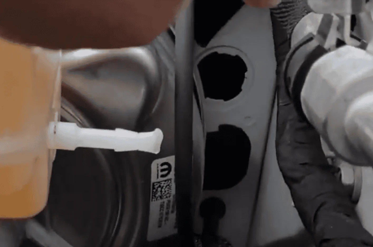

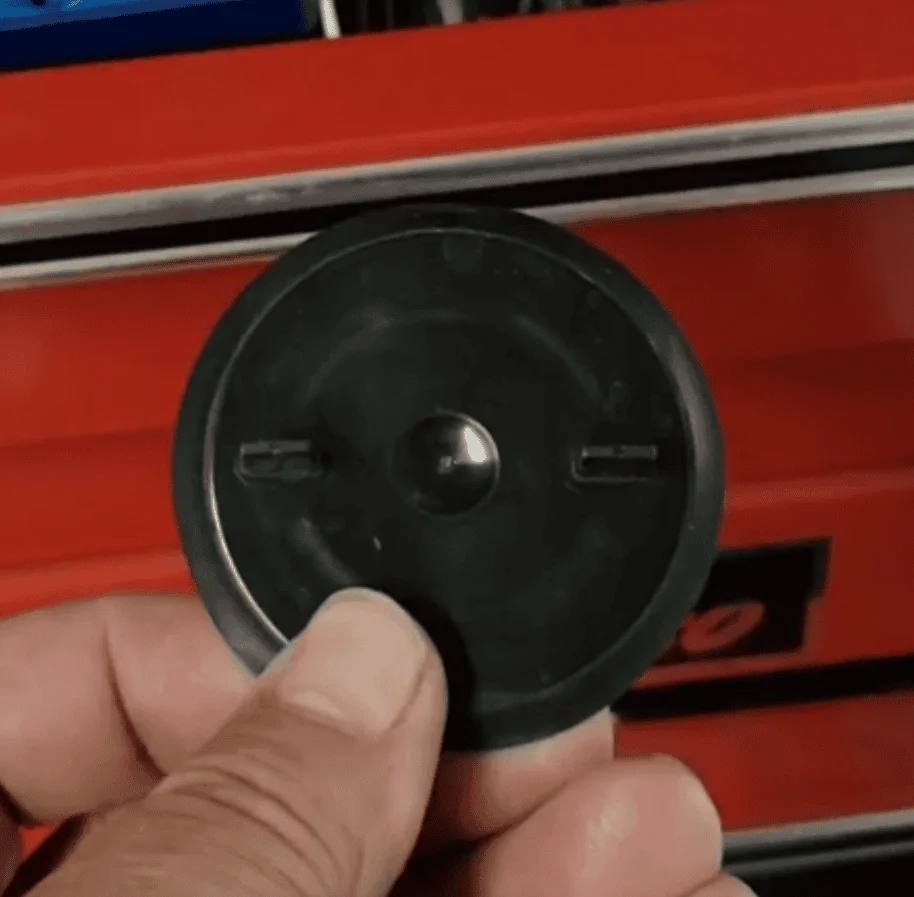

I was installing a trailer brake controller the other day on my 2018 JLU Sahara. It has the factory tow package, so I did not need to fish wires through the firewall. However, while I was under the driver's side dash I noticed a large hole in the firewall. i could see right through it. Figured this was not right, so I went to the dealer, 2 of them actually. I tried to order the plug thinking that it just fell out while I was off-roading. They ordered just about every body plug that shows up in their system. All of them wrong.
I looked around the internet for clues and I found this YouTube video of some guy showing how easy it is to fish wires through a JLUR firewall.
I know what it looks like now, but the dealer still does not know what the part number is. Does anyone know what this part number is so I can order it?

Looks like FCA updated their system. I was able to order the firewall plug this week.
The part number is 68336758AC PLUG-DASH.

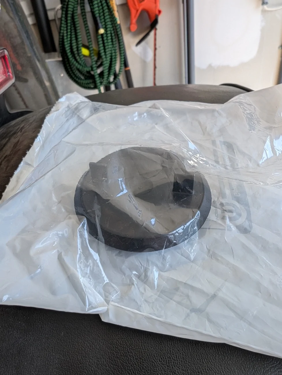

Here is the part number that goes with my 2024 Wrangler 4xe:
Dash Panel Plug68336758ac
Looks like the photos above. I was unable to figure out which plug was correct by looking at the Mopar online store references, so I just ordered all of them and found the right one in the bag. Note it gave a warning that it doesn't fit my model, but it looks exactly the same as the one I pulled out when running my antenna cable.
