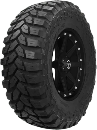

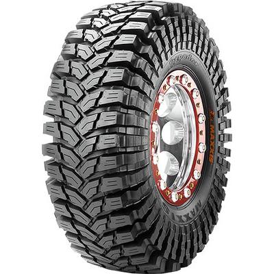

So which is which? Both claim to be the Maxxis Trepador 35 x 12.5 x 17. I really prefer the one with the red colored rim over the one with the black rim. How to know?
Bottom one looks like a maxis razr. I've run the razr's in that size on my ram and got 50k miles out of them. Obviously the trepadors would be better off road.
Red color rim is the trepador bias ply (rock crawling focused..not for streets)
Black rim color is the trepadors radial(more road focused m/t)
