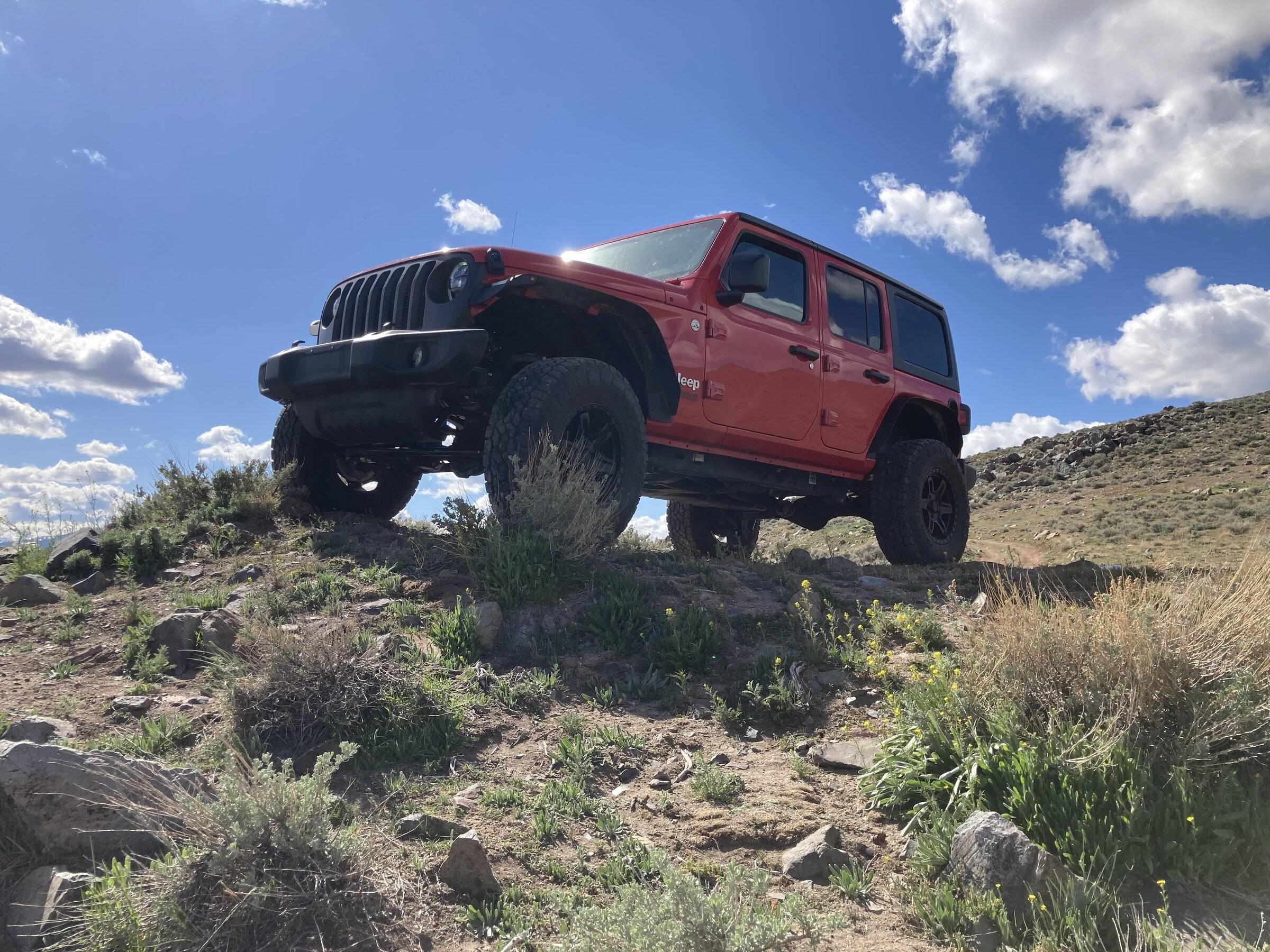

So I just got my Jeep back Monday from the shop, they put on my Clayton Off-road 2.5” Overland lift kit with Fox 2.0’s.
Yesterday was the first time since I got my Jeep in January that I’ve gotten it out and hit the trails. I tell you what!!! I’m hooked!! I’ve never had a vehicle I could do this in.
With my lift and 34’s I was able to cruise over everything no problem. That being said I didn't want to get to crazy being I’m a total novice to this stuff. But it got me wanting to add some protection to the more vulnerable areas of the undercarriage. Looking at what y’all think is the most important stuff to protect. I’ve been reading a lot and there is a lot of differing opinions. Here in Reno it’s very very rocky so I would love to err on the side of caution. Plus I want to be able to enjoy my Jeep for many years to come.
So far I’m looking at;
LCA Skids
Differential Skids
Still need rock rails looking at Rock Hard 4x4 Patriot rails
I want to get the Rock Hard Aluminum Belly skids set of the Artec full belly skid set
Either of these will be a little down the road
Any advice is appreciated
