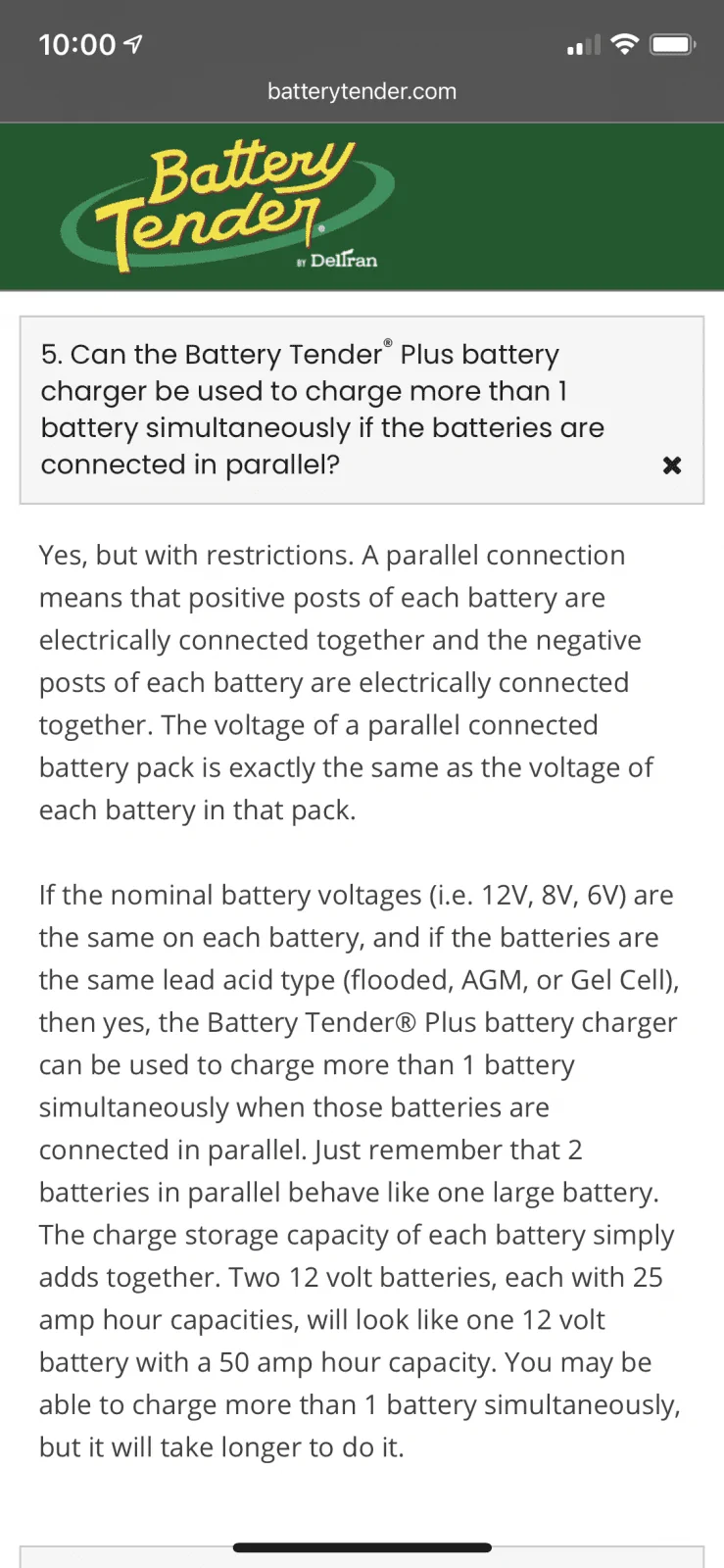

I am putting my 2020 JLU in storage for 3 months and plan to put a trickle charge on it. Anything I need to consider other than just hooking the charger up as with another vehicle. Concerned about having two batteries.
It’s not a problem. They’re treating like one battery. Initial charging may be slower, but that it.
Jeep Wrangler JL Long term charging a JLU battery. 4CF7237F-FCBE-46DB-B878-3EF0CA604F59
