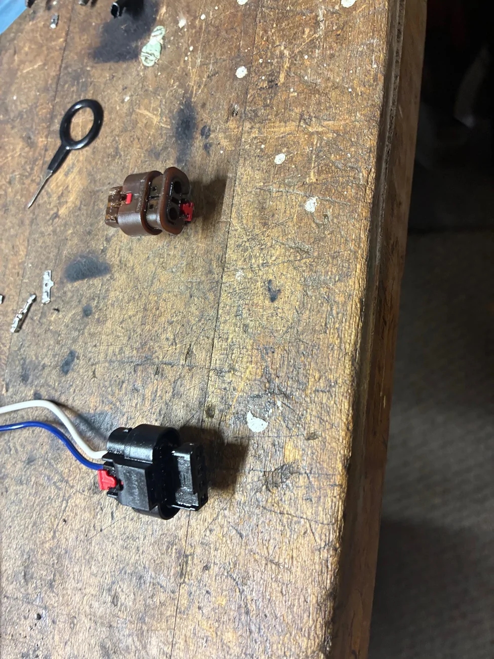

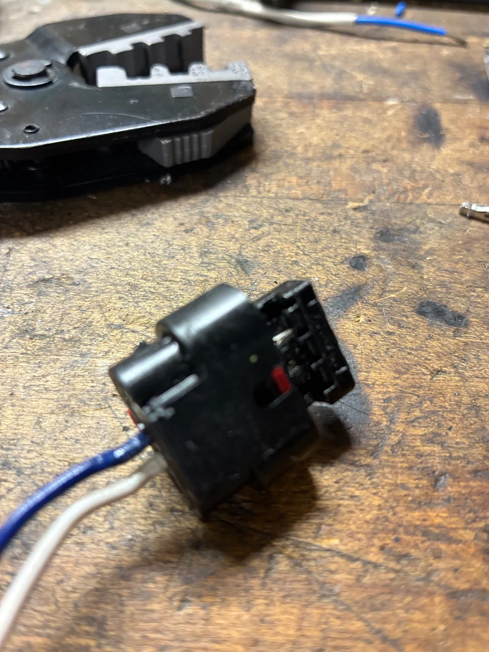

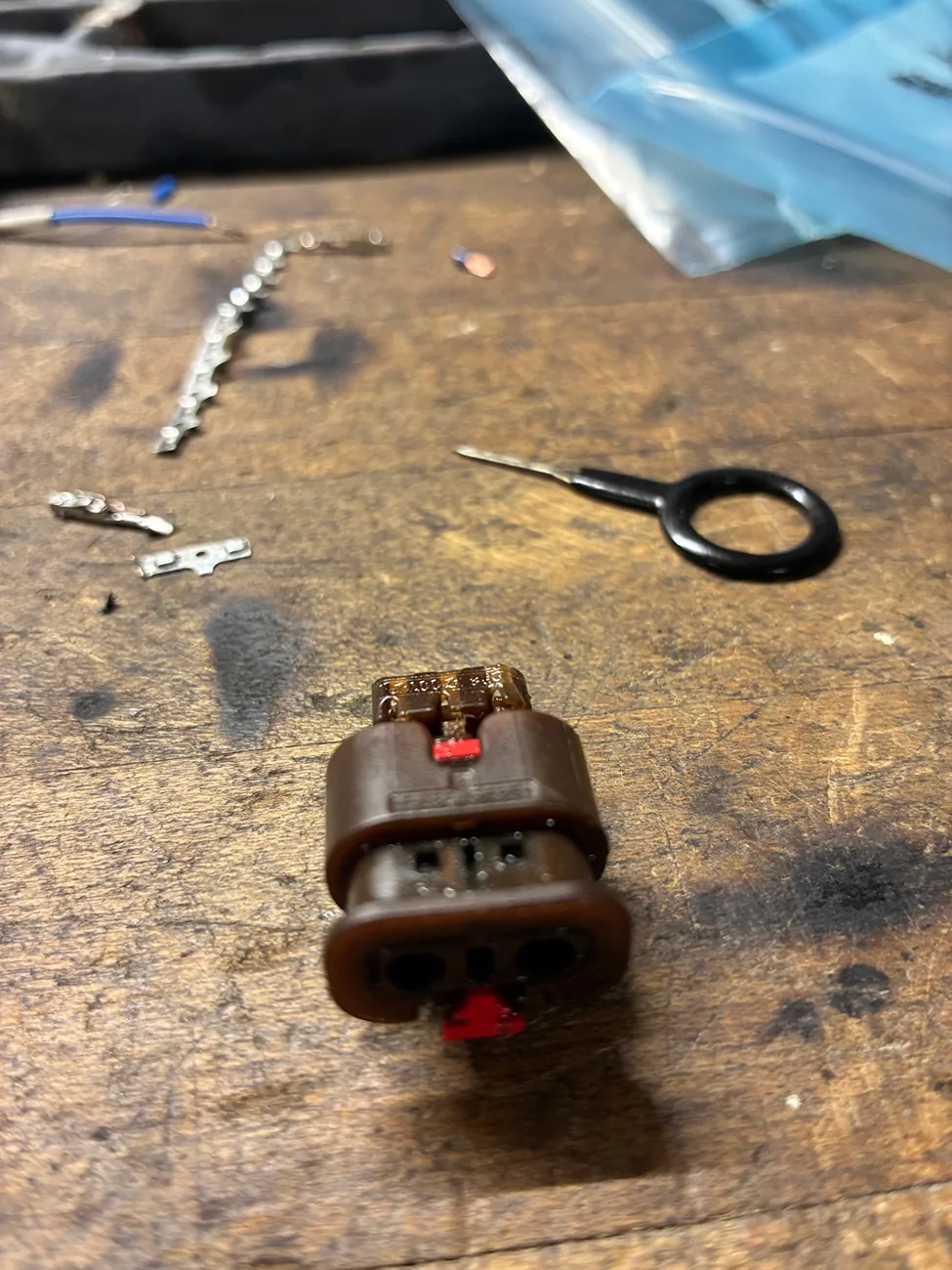

Hoping someone can help with part numbers. Attached are the wire connectors for the rear locker inside the diff.
Tried to find a wire harness to replace a faulty ground in the position sensor wiring. Since I couldn’t find that I tried rebuilding mine and broke both connectors. Looking for the connectors or a line on a complete wire harness for inside the diff.
Jeep Wrangler JL Locker wire connector part number? IMG_0085
Jeep Wrangler JL Locker wire connector part number? IMG_0086
Jeep Wrangler JL Locker wire connector part number? IMG_0084

Mouser.com carries Molex automotive connectors. Their website can be a little overwhelming with all the available parts. I would contact their technical support and send pics of the part you need.
@roaniecowpony or @chevymitchell may know

***UPDATE ***
so this turned into a cluster.
locker light was blinking on a rear potted locker position sensor.
opened up diff and found the ground wire insulation coming off like the ground was cooked.
Tried re wiring but broke both connectors in the process. The link on amazon is the 4 pin connector inside diff.
https://a.co/d/eALaKXl
the eBay link is the position sensor connector.
https://ebay.us/m/DdN1Ok
I spliced the two wires, plugged them into the sensor kit. Got to sensor 3 and now my blinking light seems to be gone.
