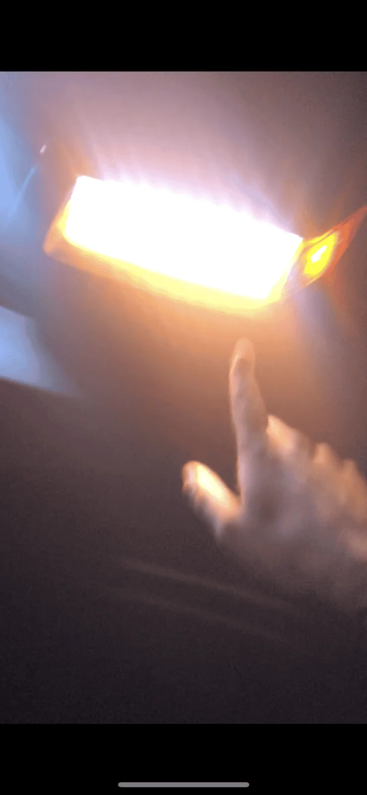

As i start the engine turn signals switch on and I cannot turn them off. (They don’t blink the light is fixed).
The back up light is even worse it has been on for two consecutive days and I can’t turn it off...

I added a video on YouTube of the crazy lights.
Just to clarify, in the video the car is in P not R and the back up light is on.

The reverse/back-up light looks strange... it looks like the passenger-side is on, but the driver-side isn't. Regardless of why it's happening, I'd recommend taking your vehicle from where you purchased it. It shouldn't be difficult for them to fix.
