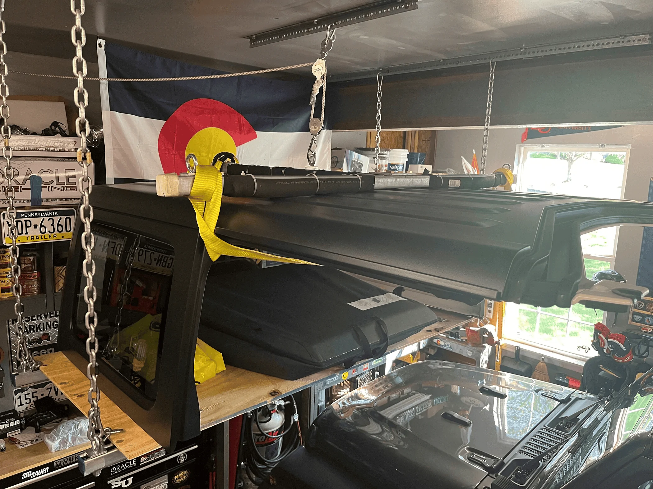

Not a HF hoist, but I'm a big proponent of spreading the load out, and having a safety backup. Multiple lag bolts into perpendicular trusses (above sheetrock). I get nervous with this stuff hanging over vehicles 😉

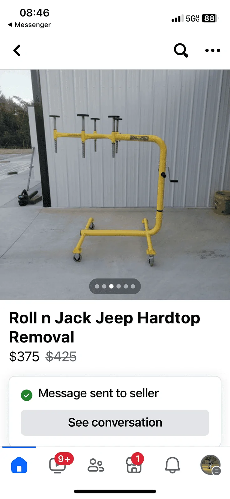

Not a hoist, but I found this on Facebook marketplace, and it’s been great. Makes replacing the top very easy, as you can line it all up without help. I drive the hood right under it in the garage. Can go from buttoned up to doors off and topless in 45 minutes with no assistance.
They can be found for sale.
