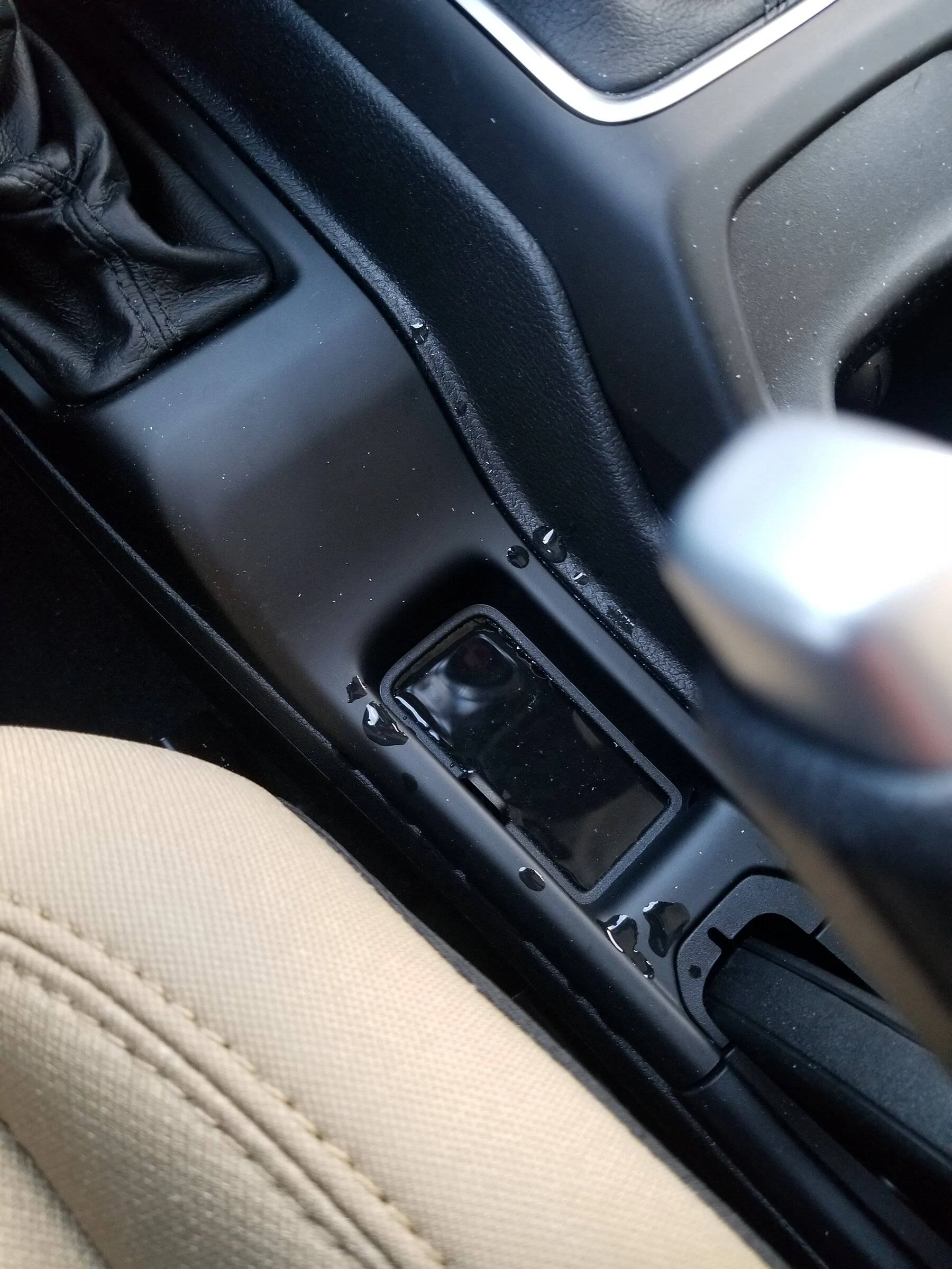

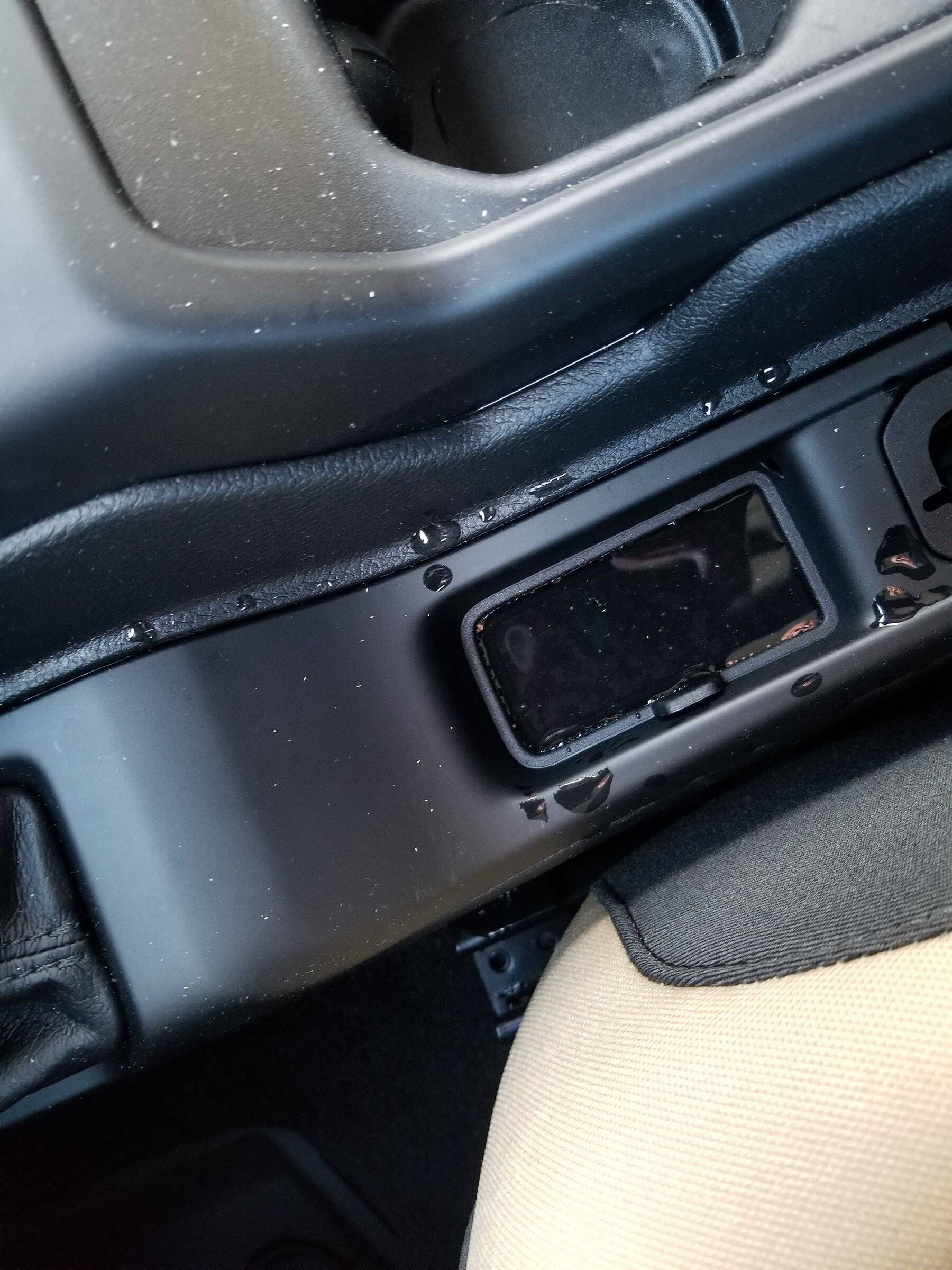

I feel like I'm baptized, and I am officially a jeep owner. Has anyone in wrangler world ever had water in the little change coin area? Jeep is 3 weeks old. No water on seats or floor, could have dried while at work. Dealer said pop out freedom panels and reset them. I have never took freedom panels out. There is still plastic near the clasps to undo them. If still leaks, goto dealer for leak test. Just curious If anyone had same water end up in coin holder. Thanks in advance for any info about leak.

Just pop out the freedom panels and reset them, that’s where it would be coming from.

Yep, happened to me a time or two. Just take them off check to be sure the rubber seal isn't pinched anywhere and reinstall, that'll take care of it.

Thanks for the feedback. Will reset them and if that does the trick.
