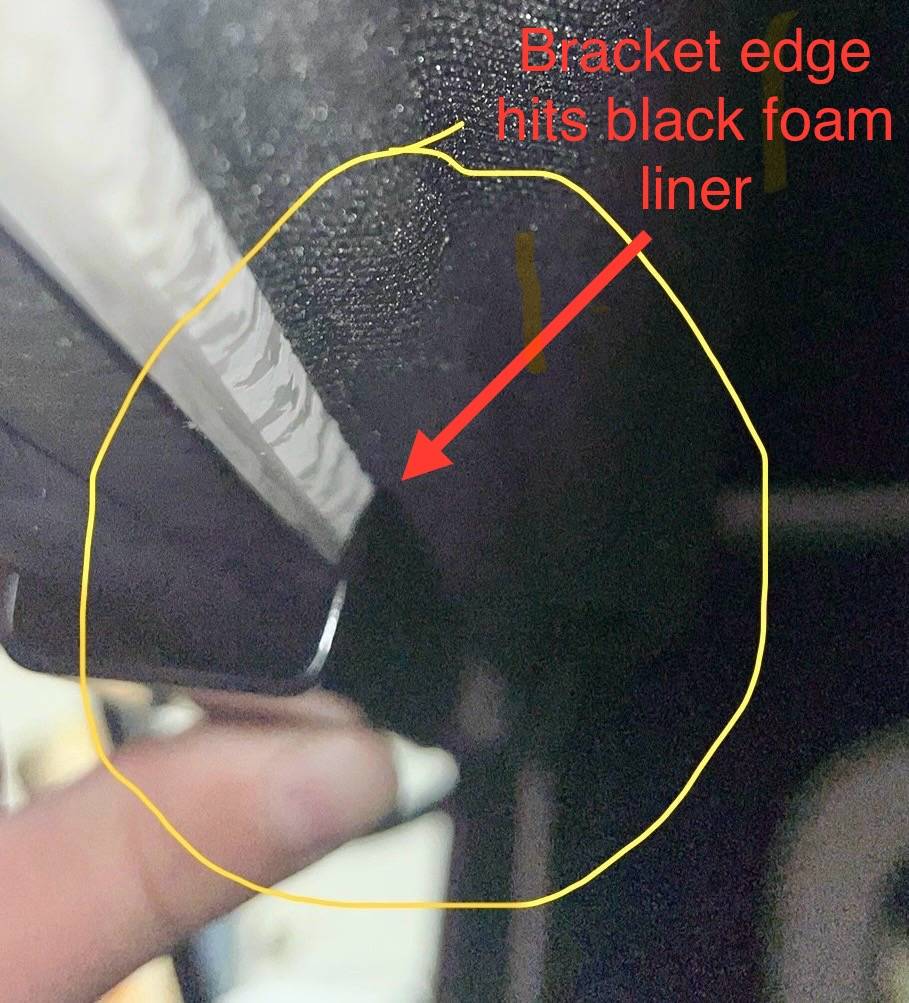

I’m having this issue currently, just got my hoist and am trying to finish the install. When I’m looking at it, our top has the added liner and it looks like the bracket is formed to a tight tolerance for a top without a liner. I’ve left a message with the manufacturer and am waiting for a call back.

Can't tell if you have the factory headliner or not, but if you do and maybe it is the same with others, you can pull it out a little if you have to and slide the bracket underneath it. The bracket fits on mine without having to pull it out, but I have pulled it out to run the wires for the lift gate light I installed. It should move enough without pulling the velcro loose.

Yes our liner is the factory option. I went out to look at it and found an area to pull the edge away off to the side.
The first time I looked at it, it seemed like it was fabric adhered to the top. Looking closer at it; it seems to possibly be fabric covered abs and has great fit and finish to the rest of the top. Bracket fits perfectly. Originally I was worried I would tear away adhesive and ruin that area.

It’s stuck to the roof with velcro
