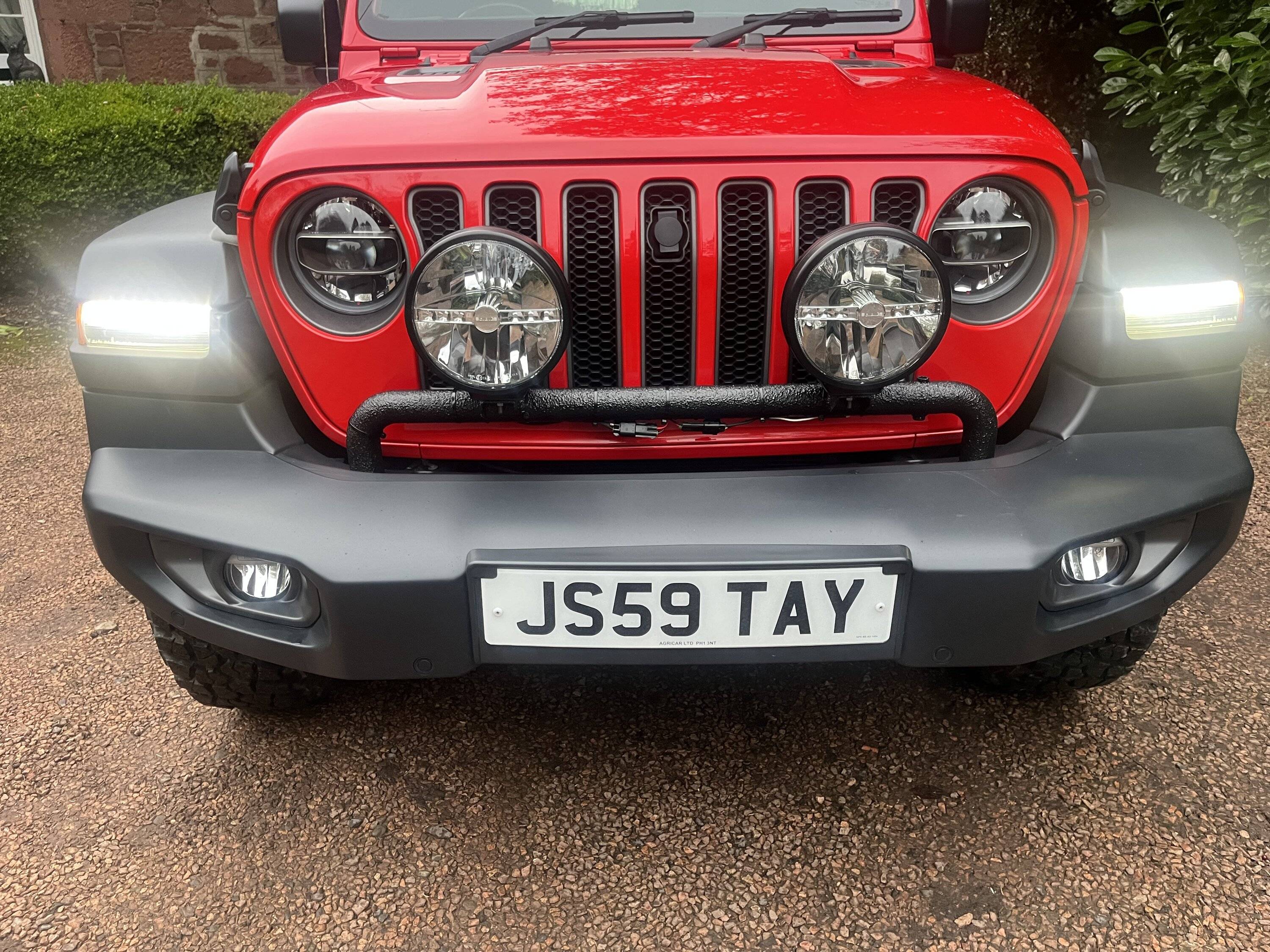

Hi guys I have just bought a 2021 wrangler jl rubicon in the uk .

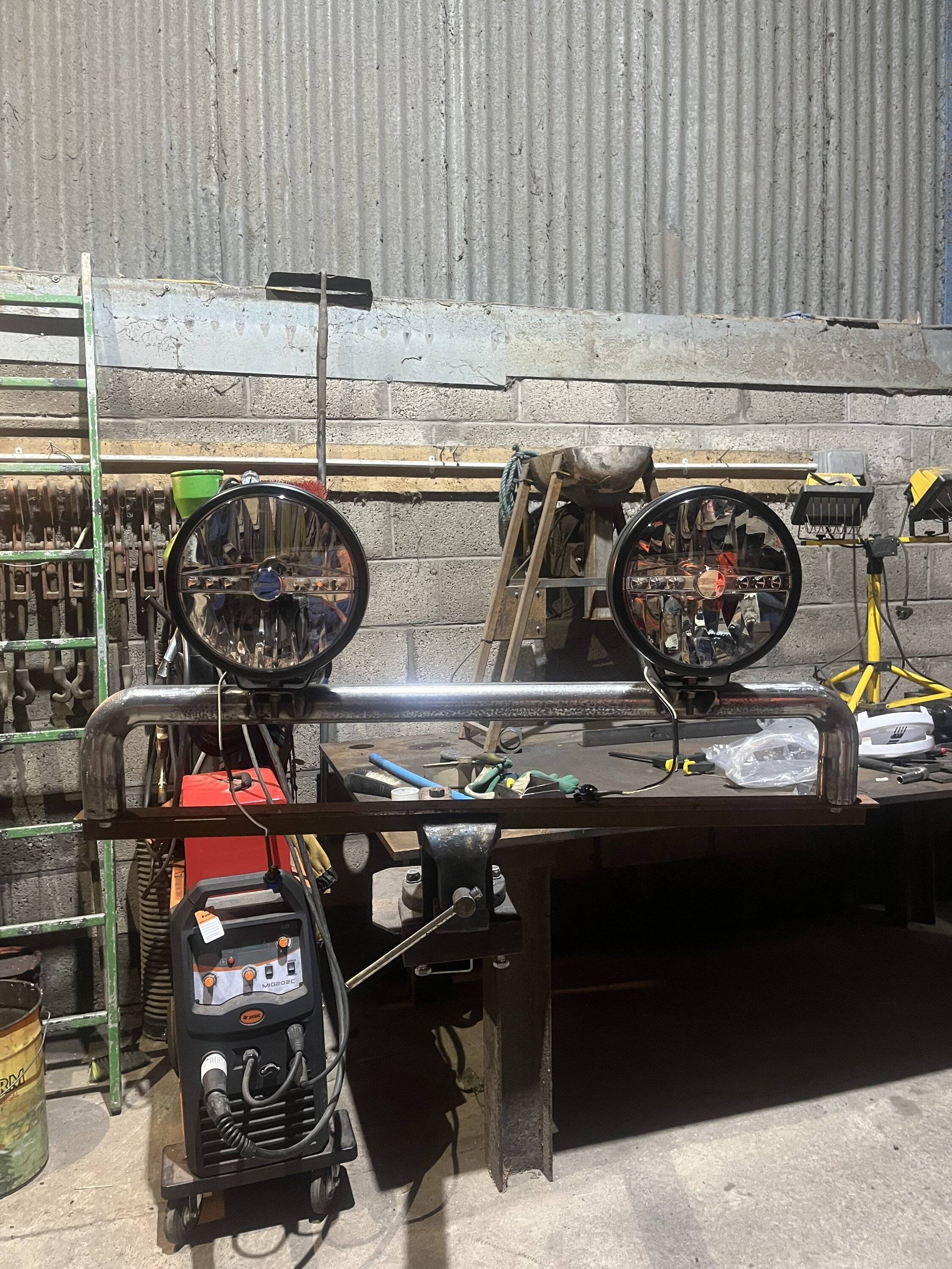

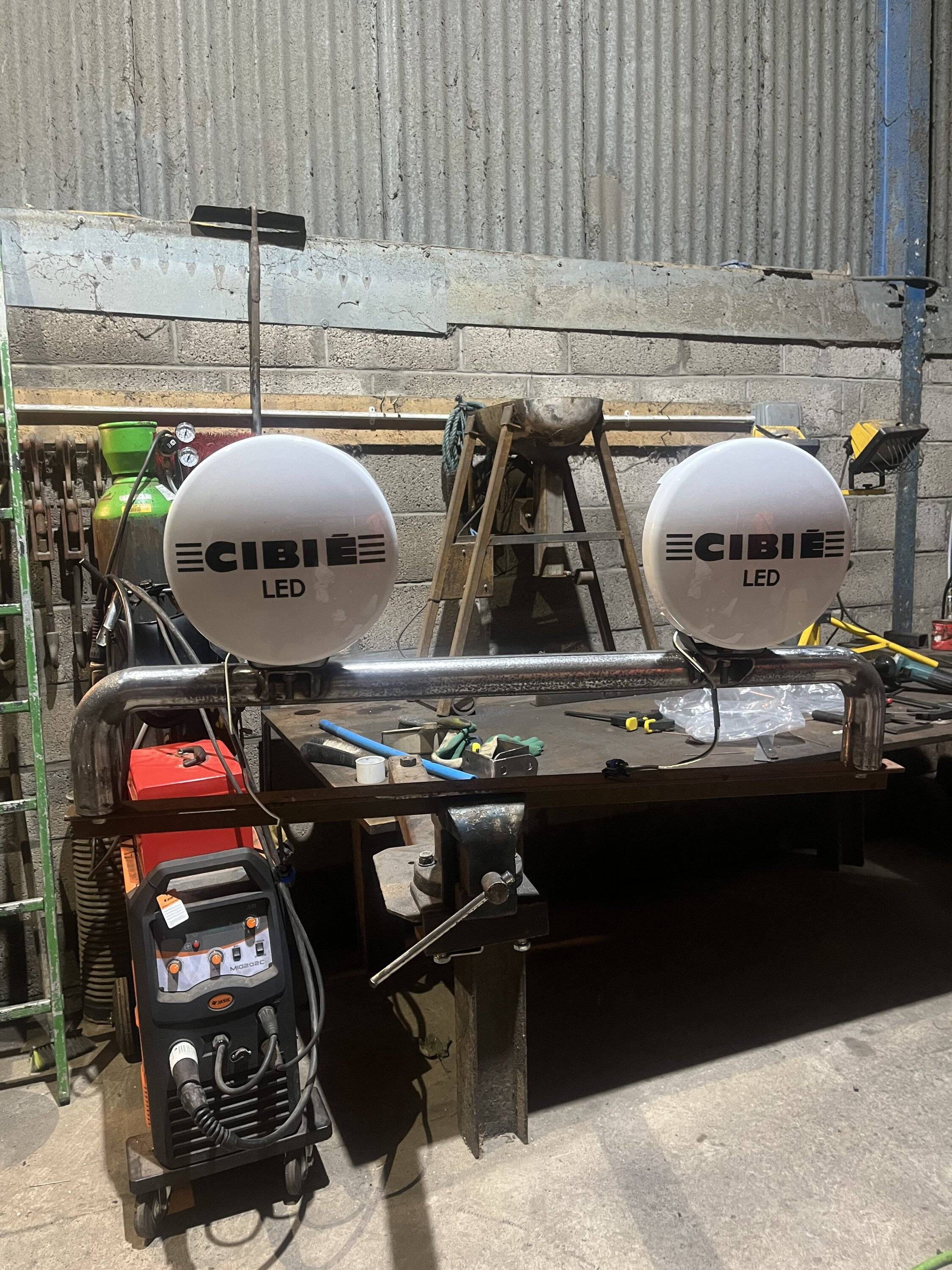

I want to fit a pair of driving lamps but can’t find an aftermarket kit to let me do this without fitting an aftermarket bumper which at the moment is not affordable. So I have decided to make my own if anyone would be interested in pics and details let me know and I am always open to ideas .

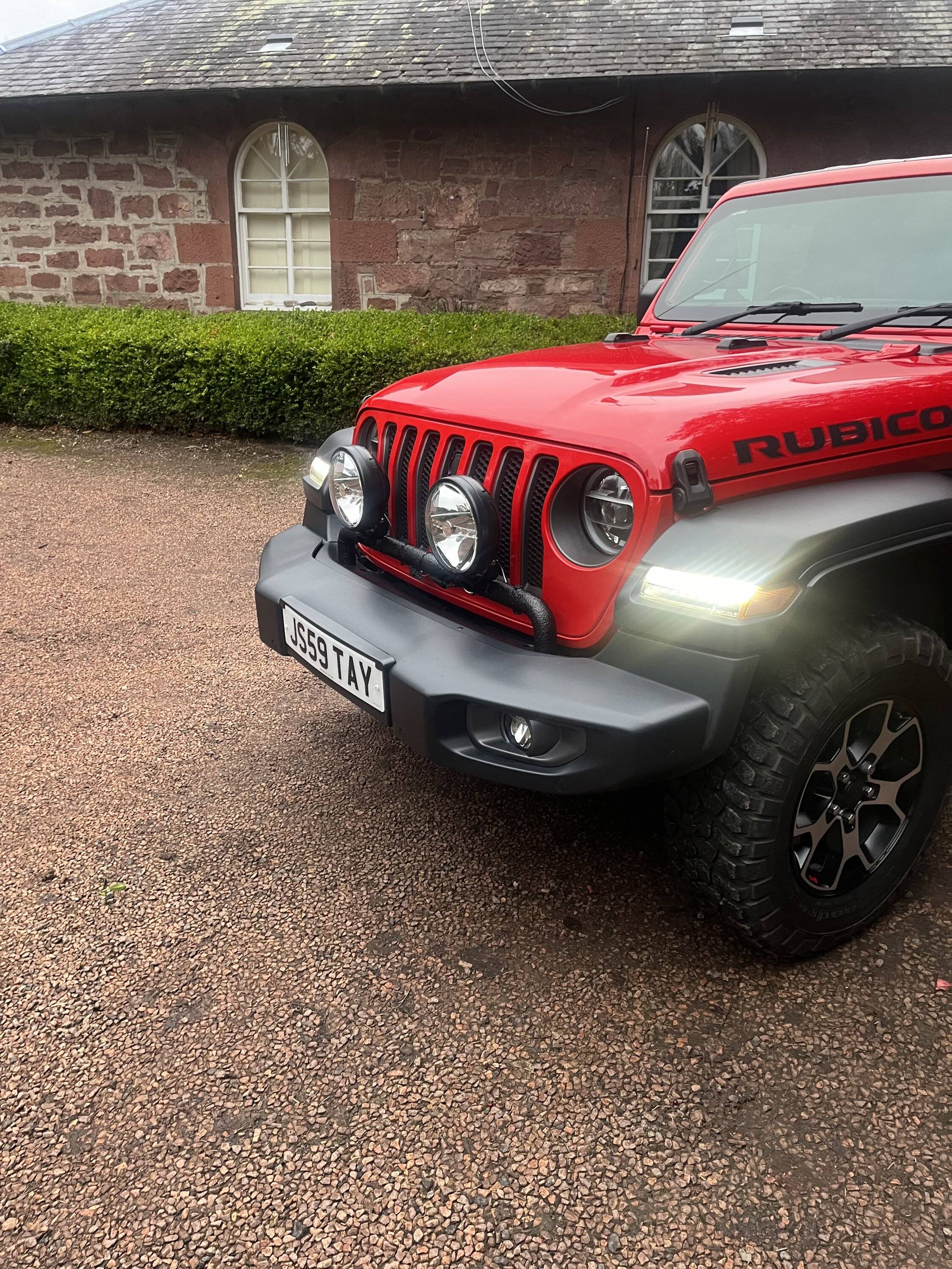

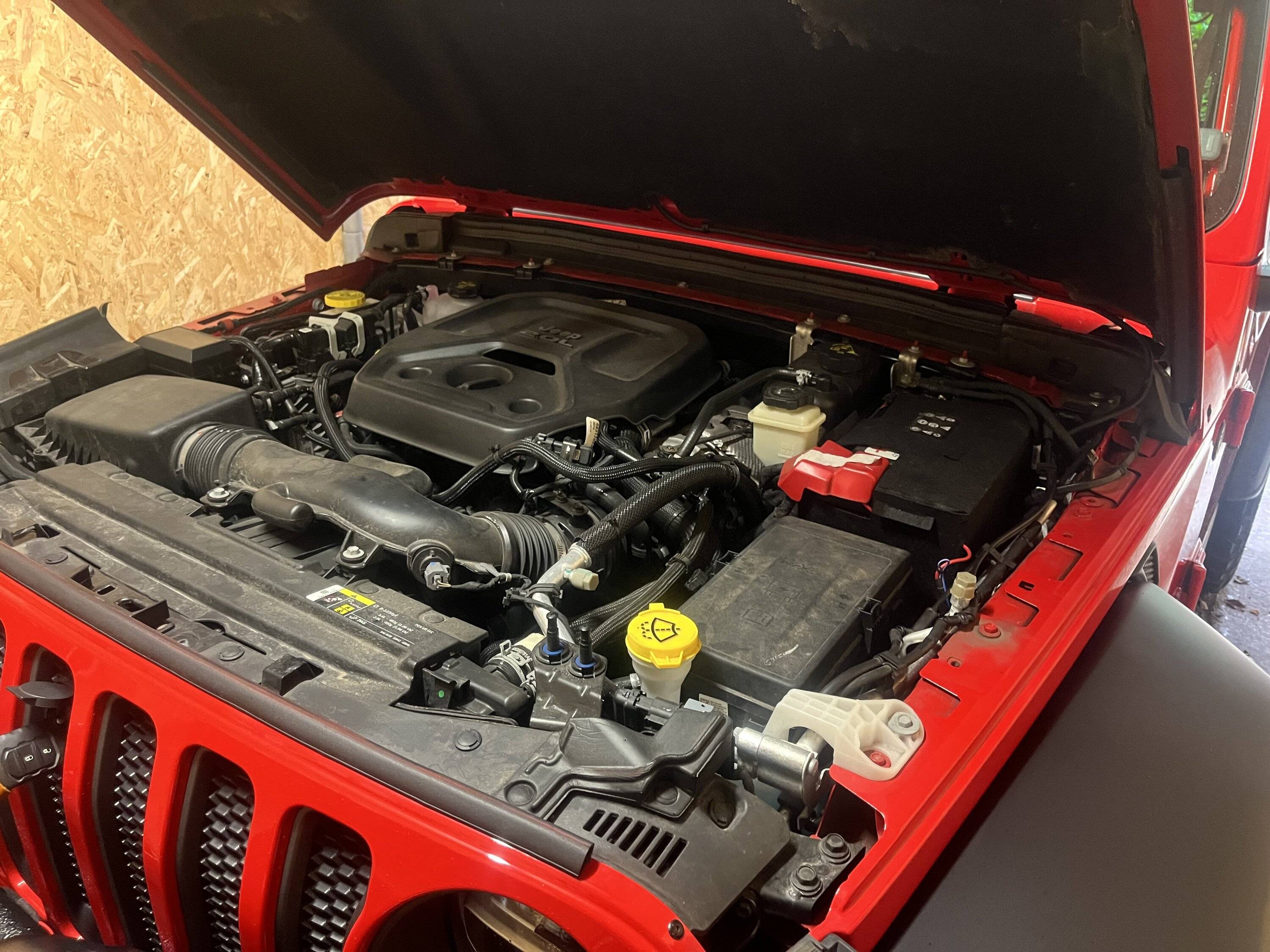

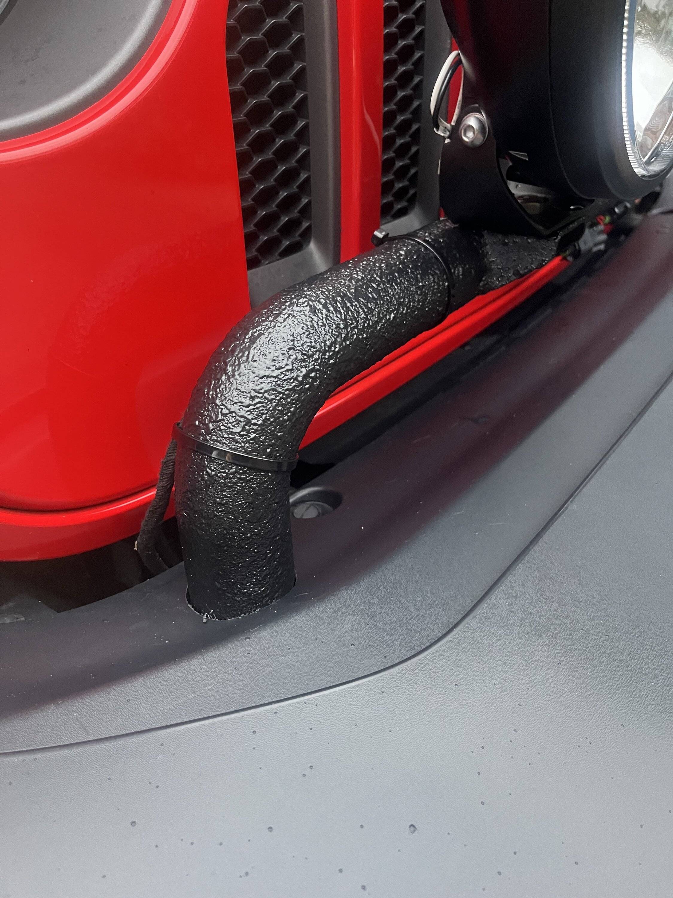

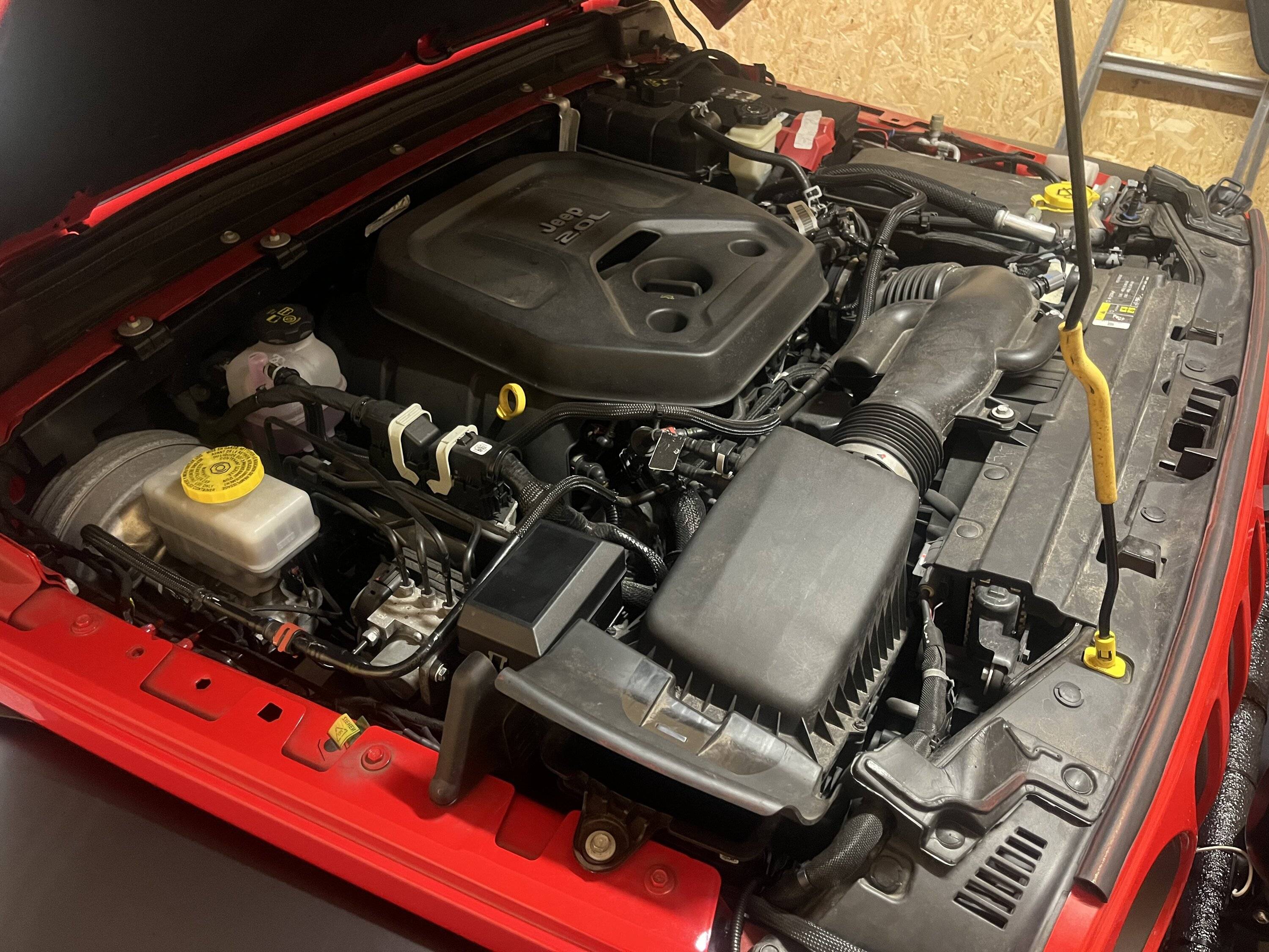

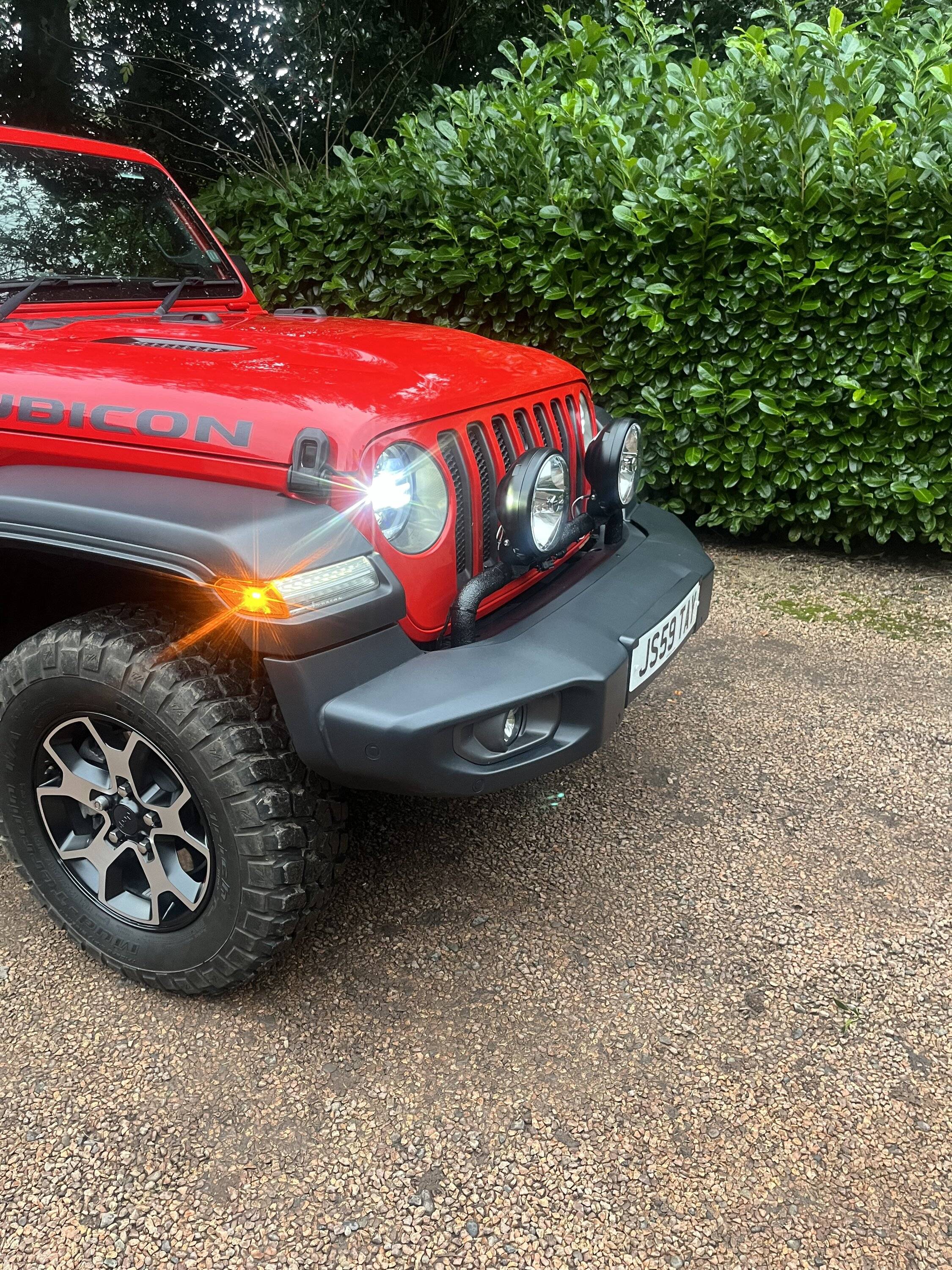

The finished lamp bar . Painted it with raptor the wiring was a challenge i used a stedi pig tail and there is not a lot of room under the hood but manage to squeeze in a fuse and relay box which I thought the finished job worked out quite well .

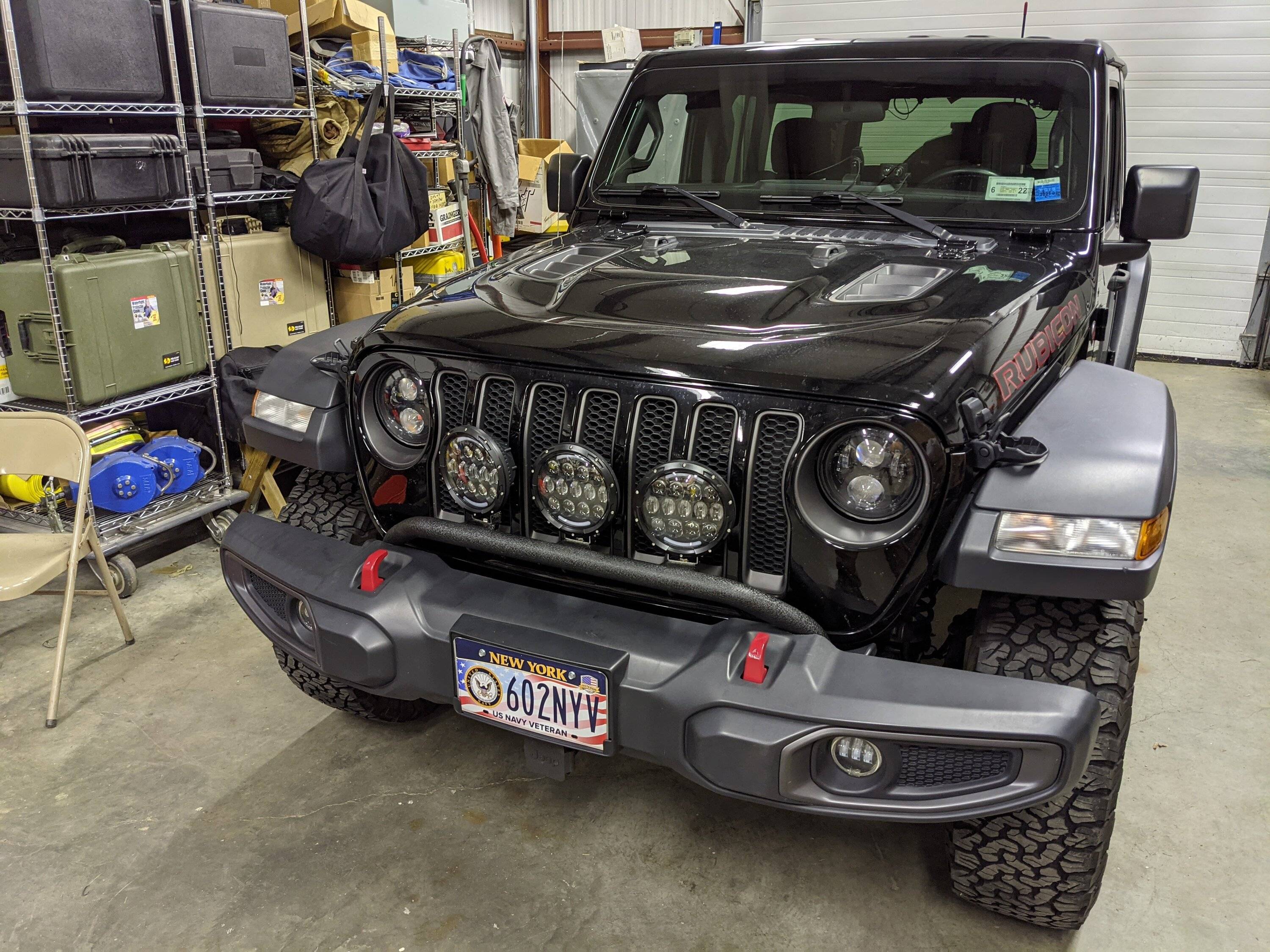

I took the bull bar from a JK, put the brackets on backwards, modified the brackets to bolt up to the outside of the frame, drilled out holes for the wires, and painted them. It's a days worth of work, but they came out pretty good.

Great but would not work on the British spec bumper . I made brackets that bolt to the bumper brackets then the bar goes down through a 52 mm hole !!
