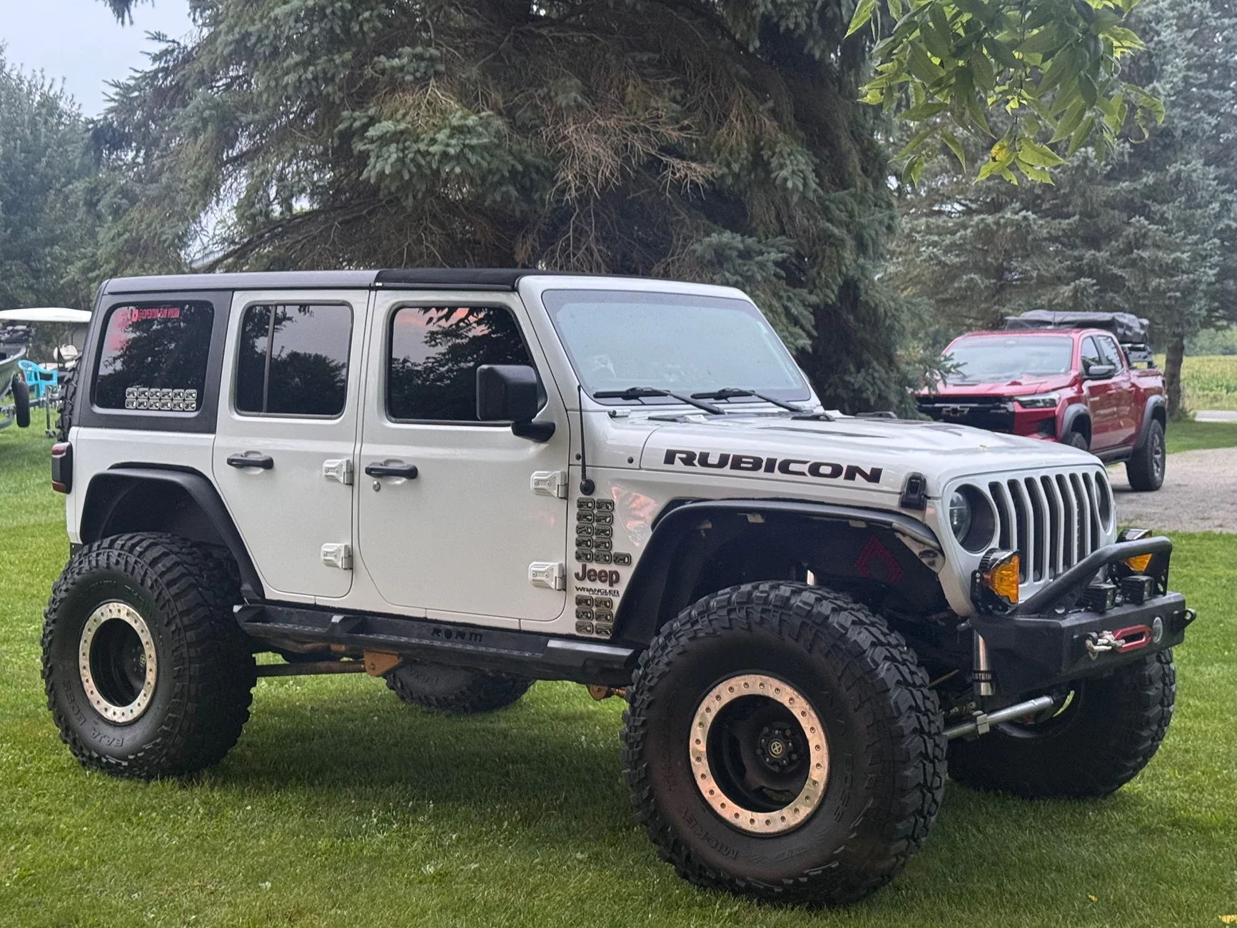

This is the start up and drive out of AMW 4x4.
Just as a side note, It will spin the tires. On pavement easily, It will spin the tires while rolling about 25 mph and throw big rooster tails off the 40s.
I have had zero time to do any off roading with it yet. It also got a Metalcloak 4.5 long arm lift installed on it.

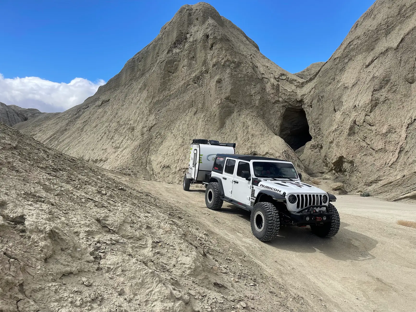

I have towed campers, 88,000+ miles with a 3.6 on 37s with 5.13 gears. The Jeep had a 153,000 miles on it when I did a hemi swap last week.
I think 5.13 gears are the sweet spot if you are towing or just in general with a Jeep on 37s. It runs about 2100 rpms at 70 mph.

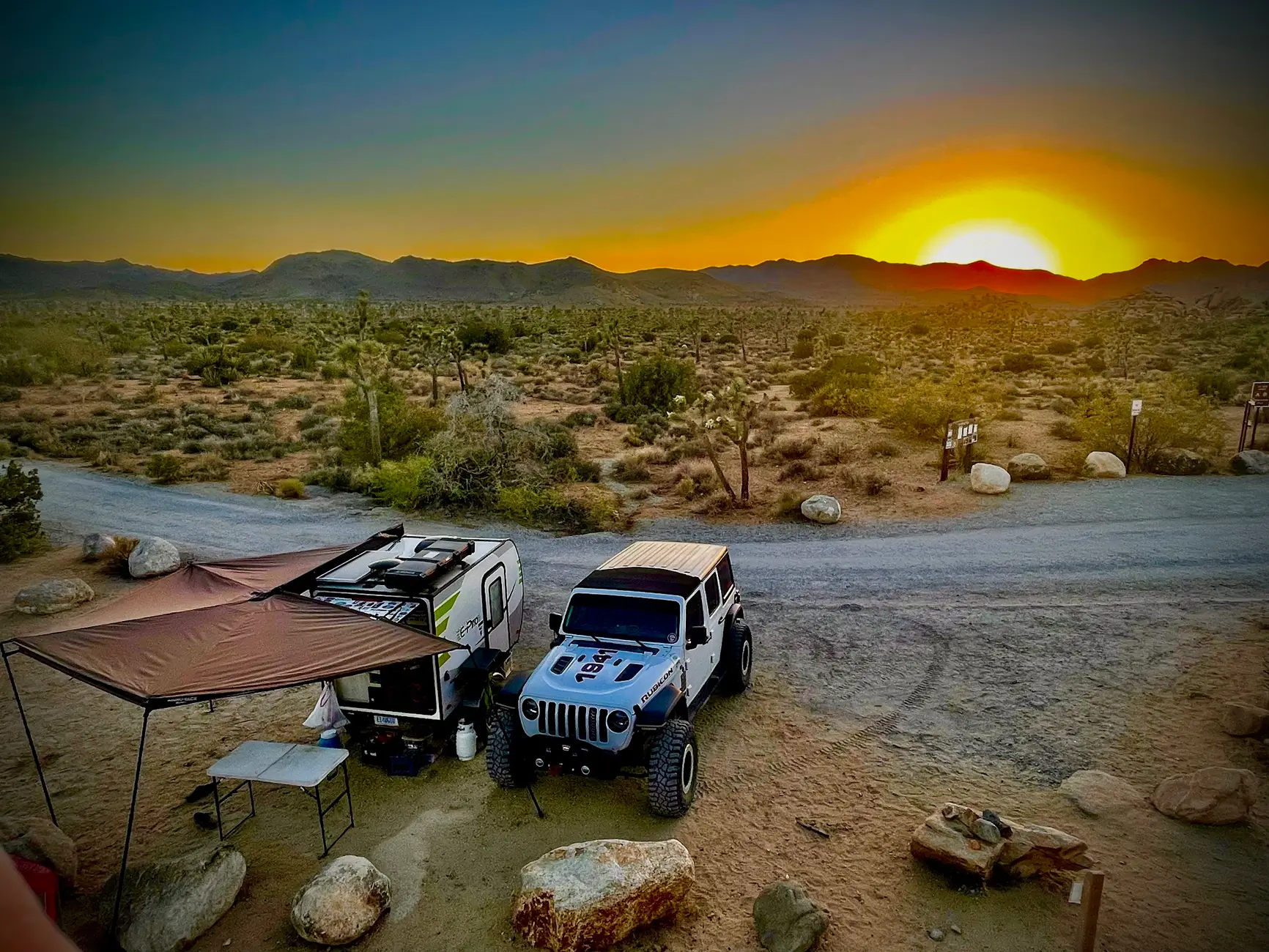

This camper was towed about 54,000 miles.

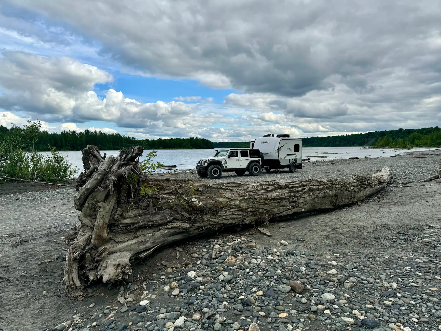

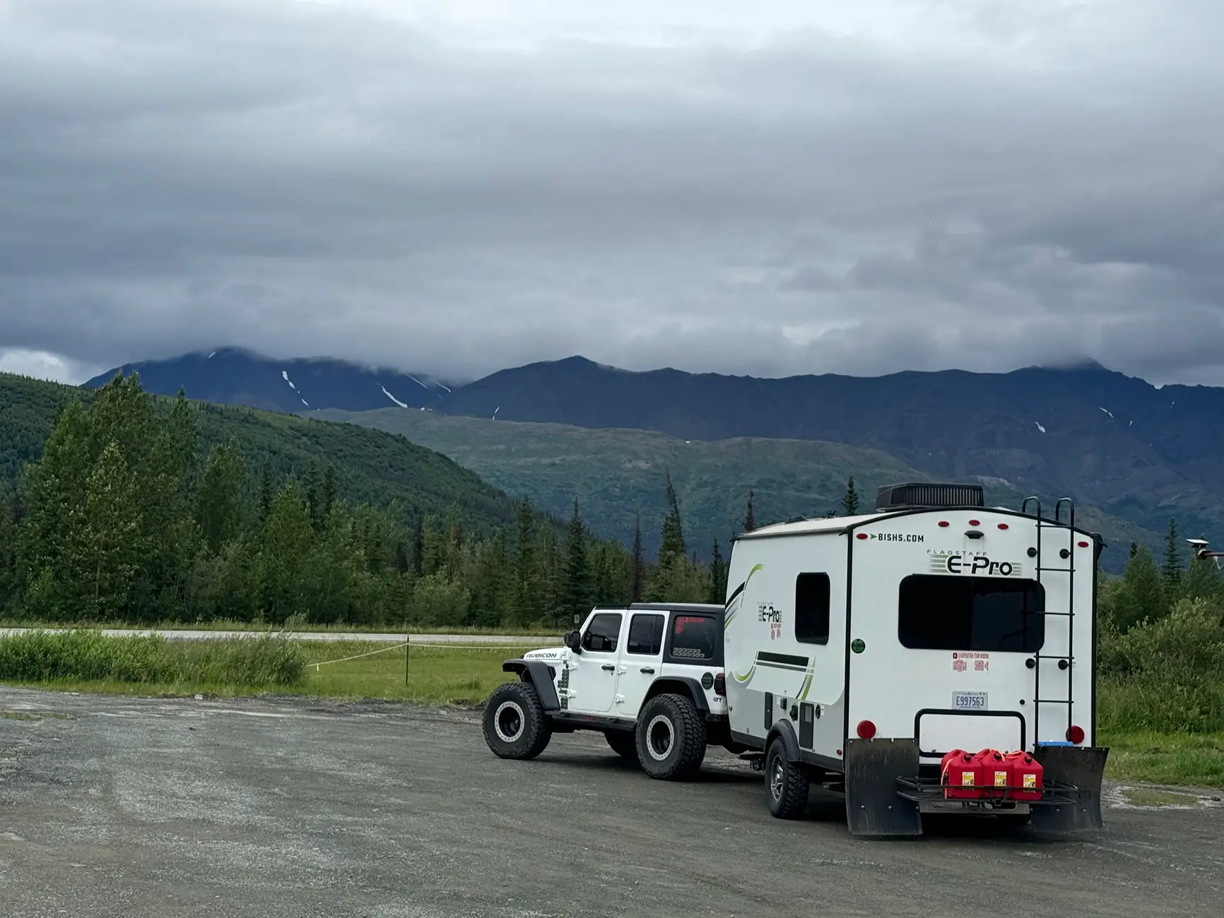

I have towed this 3200 pound camper 34,000+ miles over many mountain passes in Colorado, Utah, Nevada, California, Montana, Canada and Alaska.
