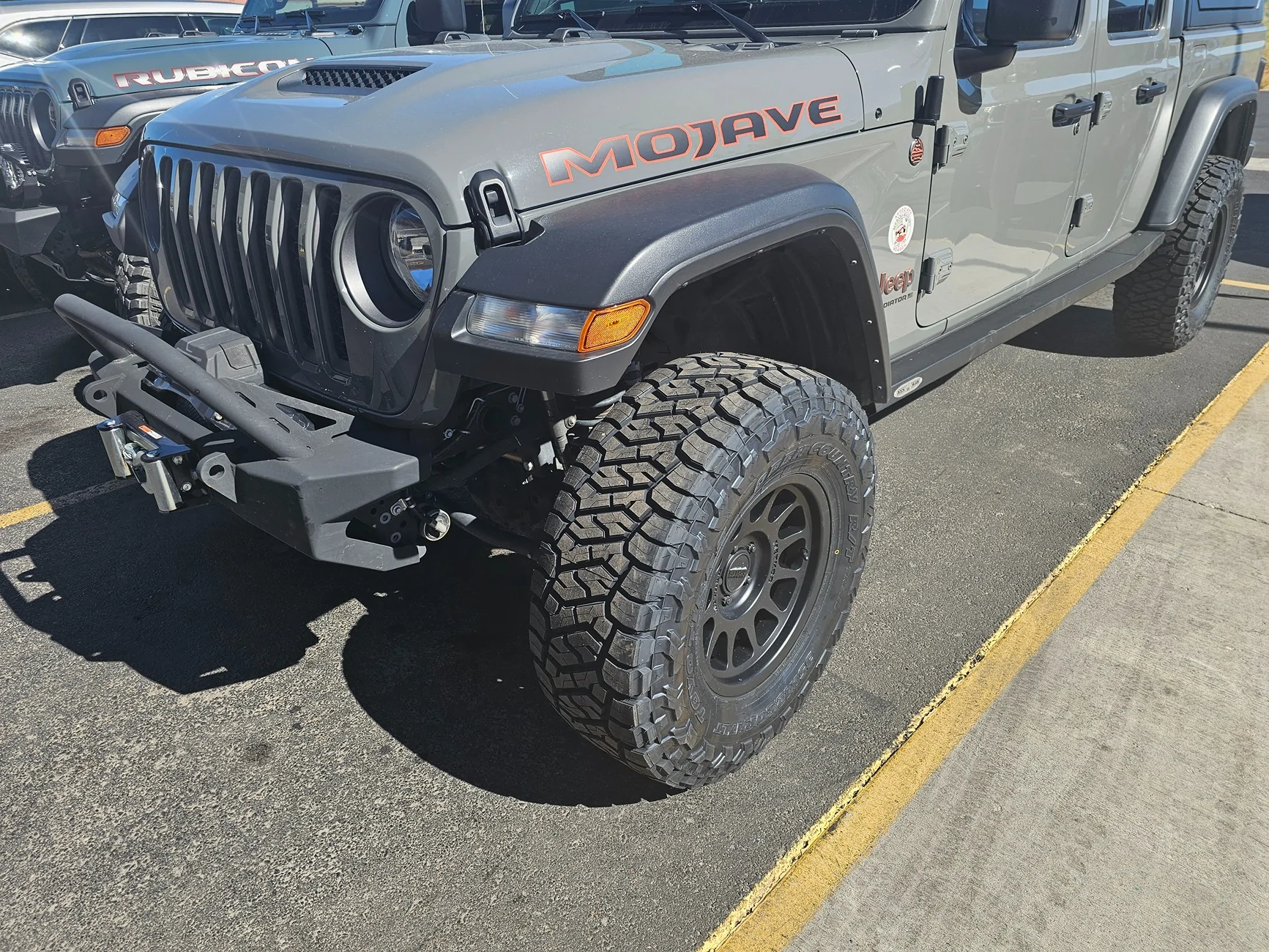

Take a look at the Toyo Open Country RT Trail. We have a set on our Gladiator that I have been very happy with. They are smooth and roll easily on the highway but work really well off road.
Jeep Wrangler JL Jolene is getting new shoes Gladiator Mojave Toyo RT Trail

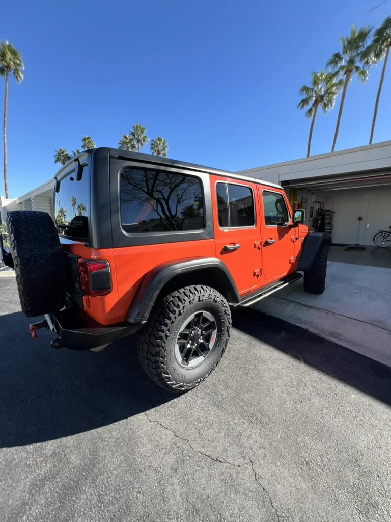

You can't go wrong with the K02 or K03's for your purposes I think. I had them and really liked them for the combination of on-road/off-road driving. They're quiet, durable, and still have good off road performance. I didn't have good experience in sticky mud back in the midwest but I live in the desert and am in rocks, sand, and snow and had no issues. I just replaced them and went up from 285/70/17 to MT Baja Boss 315/70/17's. So far I really like them but haven't been in the rocks or snow yet. (I just got them 2 days ago.) They are a little louder but not much. I do think they're heavier. We'll see what happens to gas mileage. I didn't buy it for gas mileage, so whatever. LOL
Jeep Wrangler JL Jolene is getting new shoes 64B905A9-77F5-4168-A388-7D1A6B65A6F0_1_105_c
These. I have them on my ZR2. 20,000 miles deep now. Have run wildpeak, duratrac, and ko2. Will put the rt trail on everything from now on.
