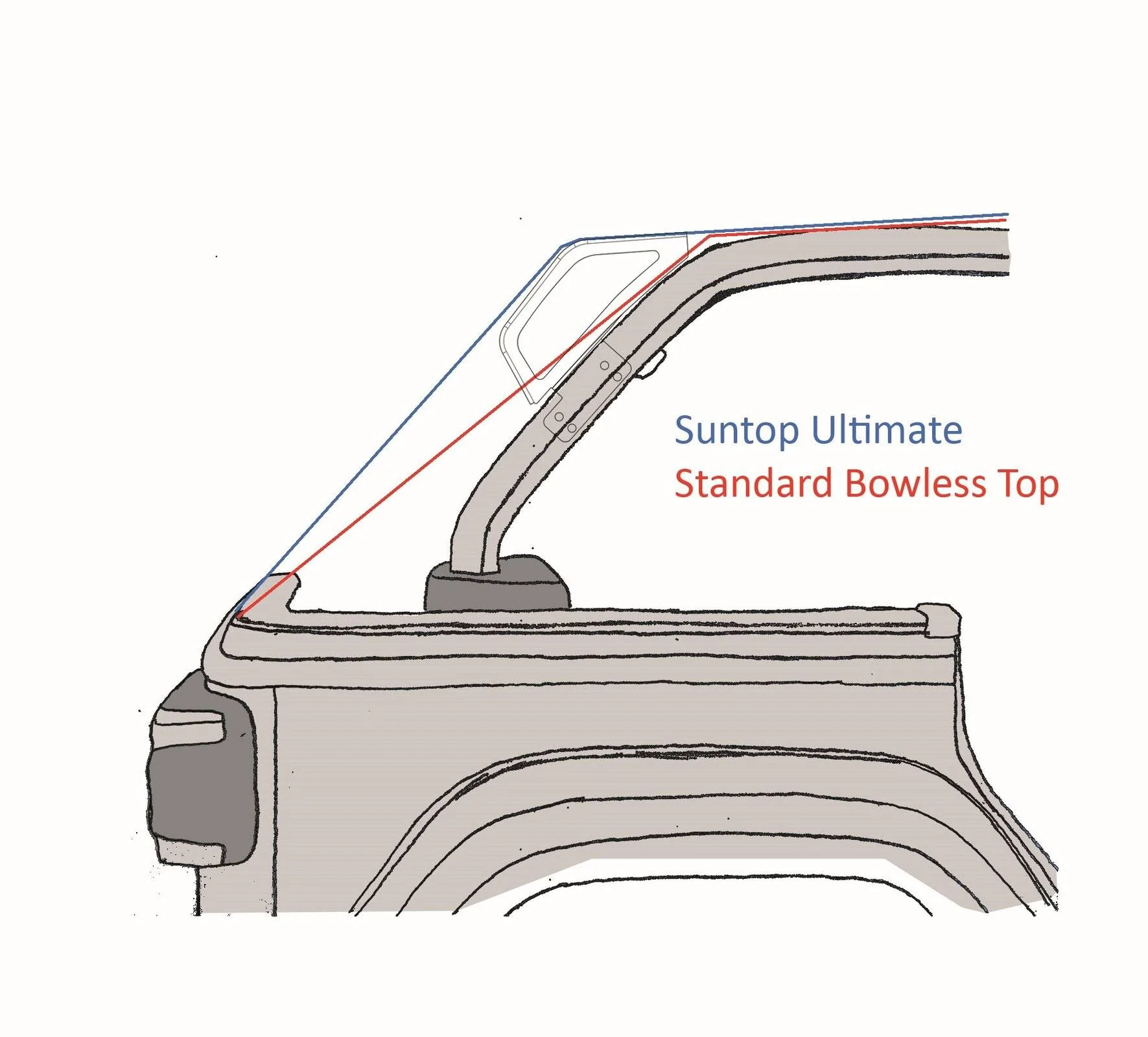

Gotcha. It might be a tall order to get rain coverage with mismatched systems, especially back seaters because of the roll bar bend being in front of the rear headrests.
The Suntop windows require the top part for some special hardware that changes the contour of the roll bar to move the bend behind the headrests, plus the rear door surround attachment part. You might be able to modify it to stay put, but it'll likely be floppy without the custom bits.
So basically, I’d need to find someone who is selling, for parts, a full kit with a broken top, and then Frankenstein it from there.
lol.. yeah, sounds about right; but even then, your Smittybilt top stops on the inside of the rear roll bar, whereas the Suntop extends beyond it, so the rear windows likely will leave a gap at the top. At the very least you're looking at some Chinese-water-torture level of drips coming down onto the heads of your rear passengers.
