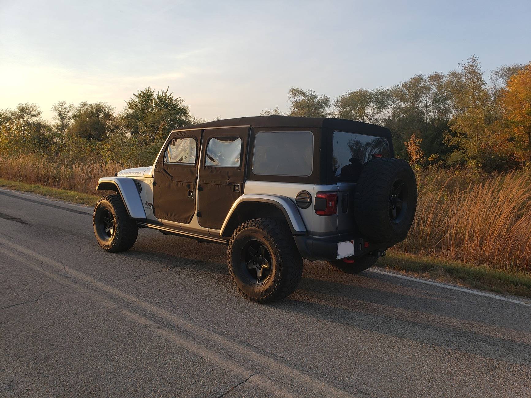

I have thought of a better way to ask my question, so here goes.
If I already have a mopar soft top (via "dual top group) from the factory, how easy will it be to toss on the fabric & frame of a fastback top, like an NX or others, from Bestop?
Or will I have to swap out nearly all of the door surrounds & other small pieces?

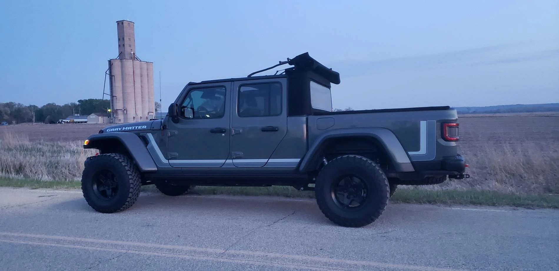

Based on owning & installing (1) a 1. Bestop NX Glide (for JKU) around 2018, (2) a Bestop Sunrider for Soft Top (for JT & JLU) aroud 2021, (3) plus now a factory Mopar top, I'm thinking they have a lot of shared parts.
Thanks in advance.
Soft top pics for attention.
