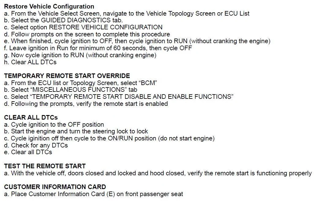

From 2020 year there are only FObs and programmer. https://infotainment.com/shop/exter...er-jl-factory-oem-mopar-remote-start-upgrade/
Here are also video tutorial.
And also manual how to enable it but for service.
I think when I have the fobs, I need only program it. And I need to know how.
Its information collecting. For examle I found that if you disable auto Start/Stop system, also remote start will be disabled.
Therefor I have anabled auto Start/Stop. Ehen I press remote start twice, car respond only with flashers, but car didnt start.
In my opinion I miss this steps:

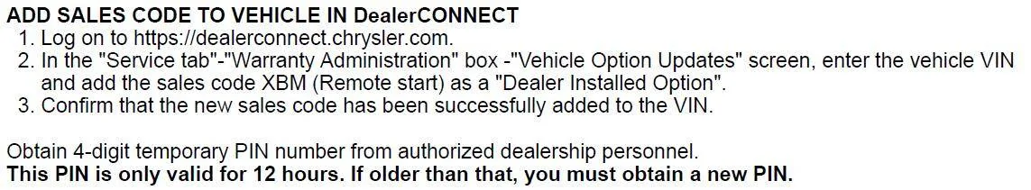

And then this. I do not need to configure new fobik.

" Its information collecting. For examle I found that if you disable auto Start/Stop system, also remote start will be disabled. "
ASS being disabled by the dash button is reset when the engine is turned off. If you use something like a Tazer it remembers you setting and reverts to that setting when turned on again, so remote start isn't affected and works. I've disabled ASS with a Tazer and my remote start works just fine.

its working! Im happy.
