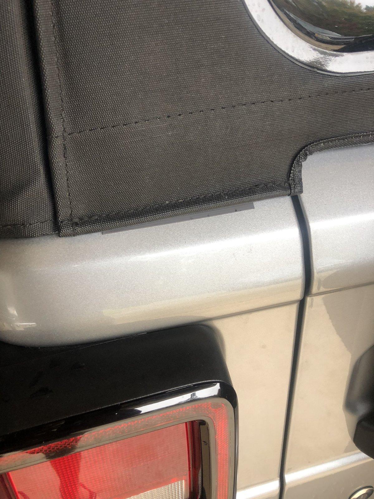

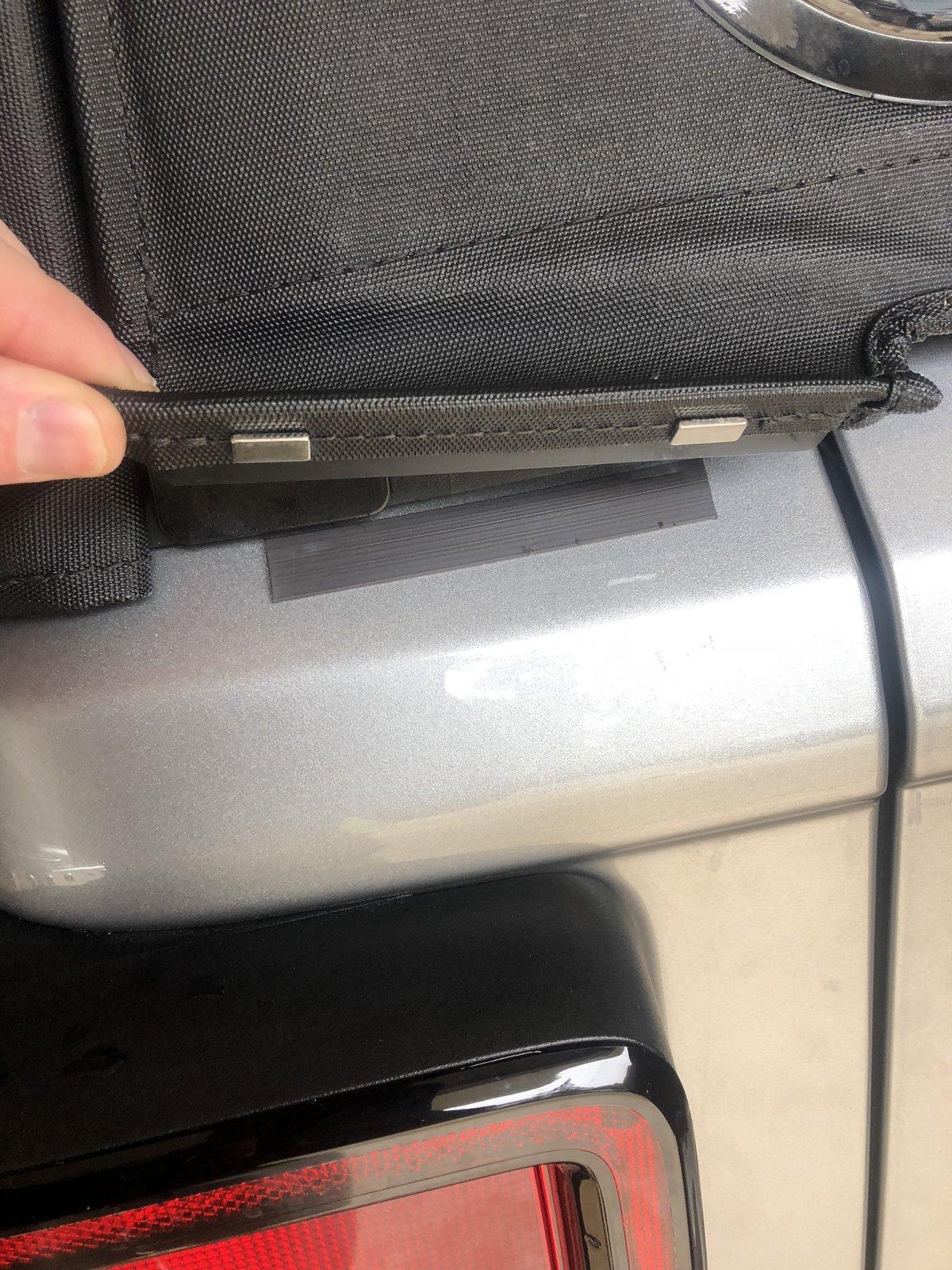

The bottom attachments on my rear soft top panel kept popping loose after driving.
In order to fix that I ordered several neodymium high-strength magnets (link attached) and gorilla glued them to them underside of the fabric.
I then place a short strip of 3M magnetic tape to the swing gate, just under the plastic lip. No problems so far. Let me know if anyone has come up with a different or better solution.

How’s this fix holding up?

It was going pretty well until the glue wore out. I think with some better glue it will hold up fine.
