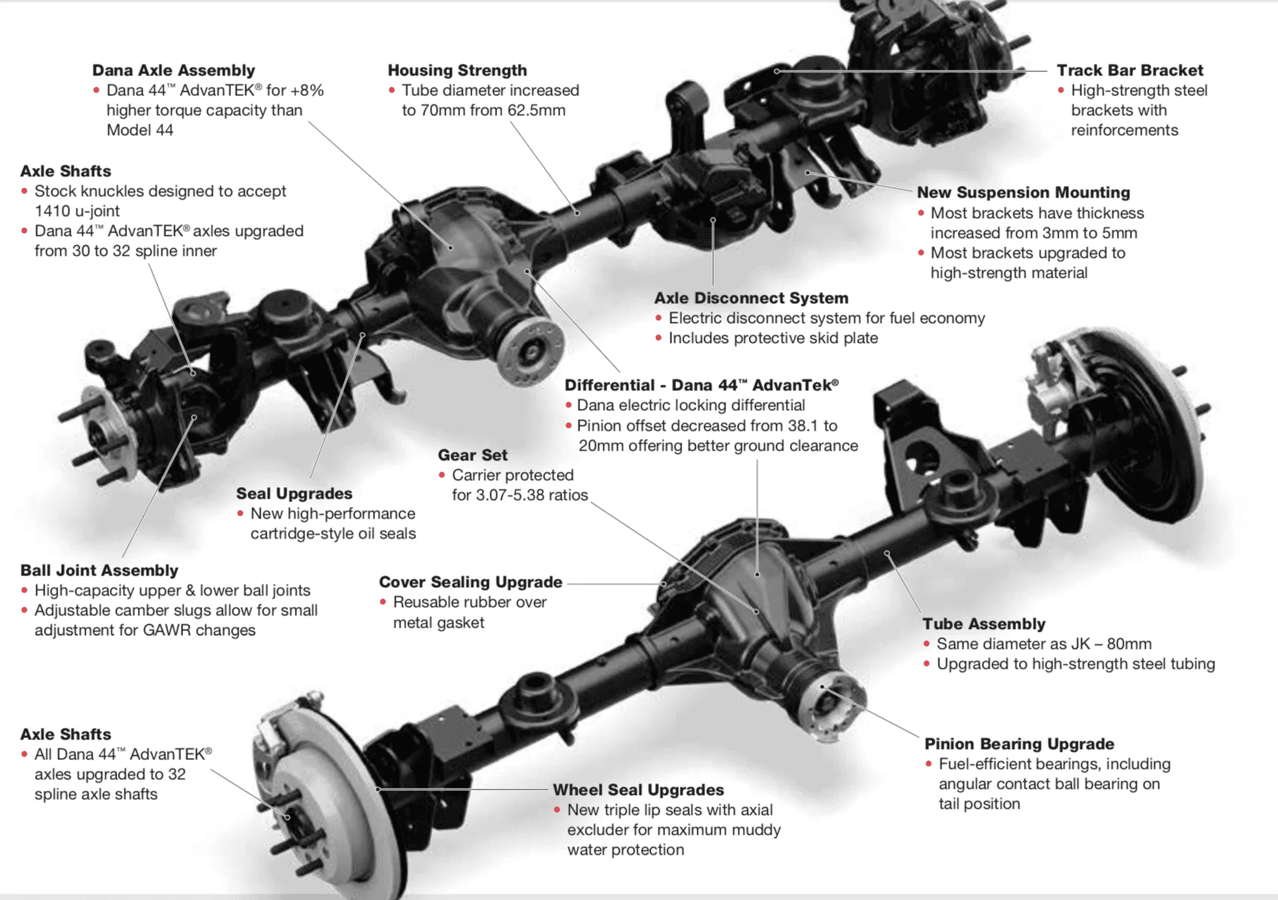

Also, all advantek dana 44 rears 32 spine! I wonder if that means sport owners with the D44 can put in a rubicon locker?
According to this PDF from DANA it says all:
Jeep Wrangler JL JL Rubicon Axle Specs Screen Shot 2018-06-20 at 8.38.45 AM

You're right, that was written back in Feb, when there was very little info out on these and DANA was very tight lipped about anything. We passed on what they told us, then we find out different info as time goes on.
Nice! Think a Rubi locker would work in a sport 220mm 44? Assuming they in fact are both 32 spline.
I called Dana and they told me the locker is an Eaton..so I emailed Eaton about splines etc...nothing Back yet. Also I have the part number for the locker but nothing shows anywhere available in the US
