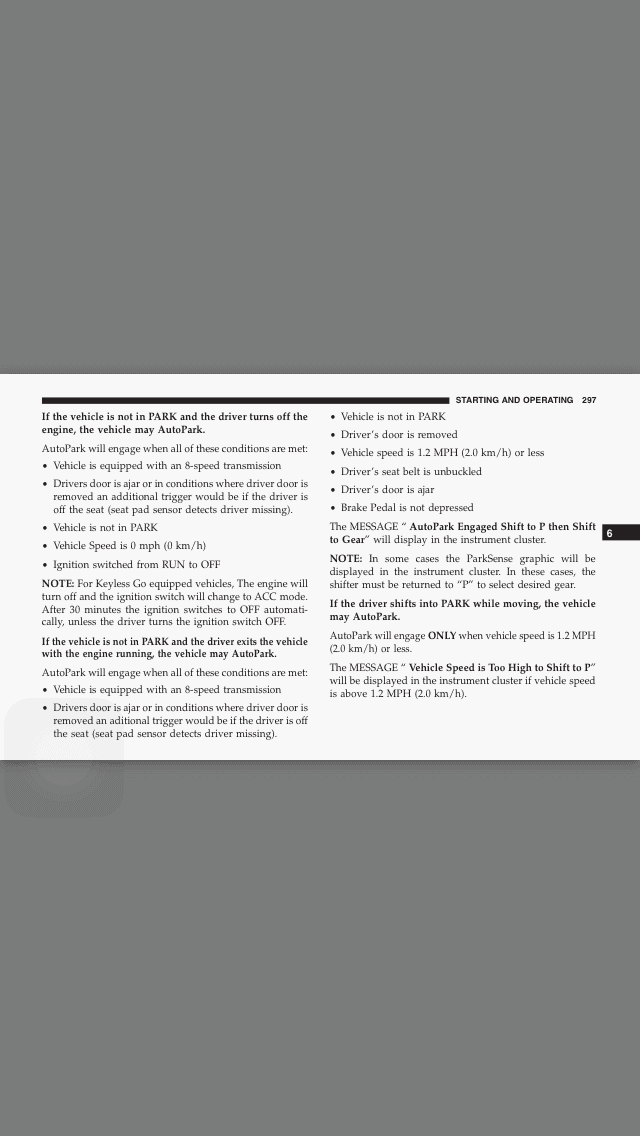

So once you turn the button off it works fine if the issue occurs ?
Is that for the parking sensors only? Why would a beeping sensor affect the vehicle ability to move, as JL doesn’t have auto park assist.
Also if Chrysler is aware of the problem why not find a fix ??
Thanks
@Gus You can see the button for turning the sensors off in this pictures. That said, it’s definitely the auto park feature at work in the video. My Ram does the same thing. The sensors are only noise, no action.
