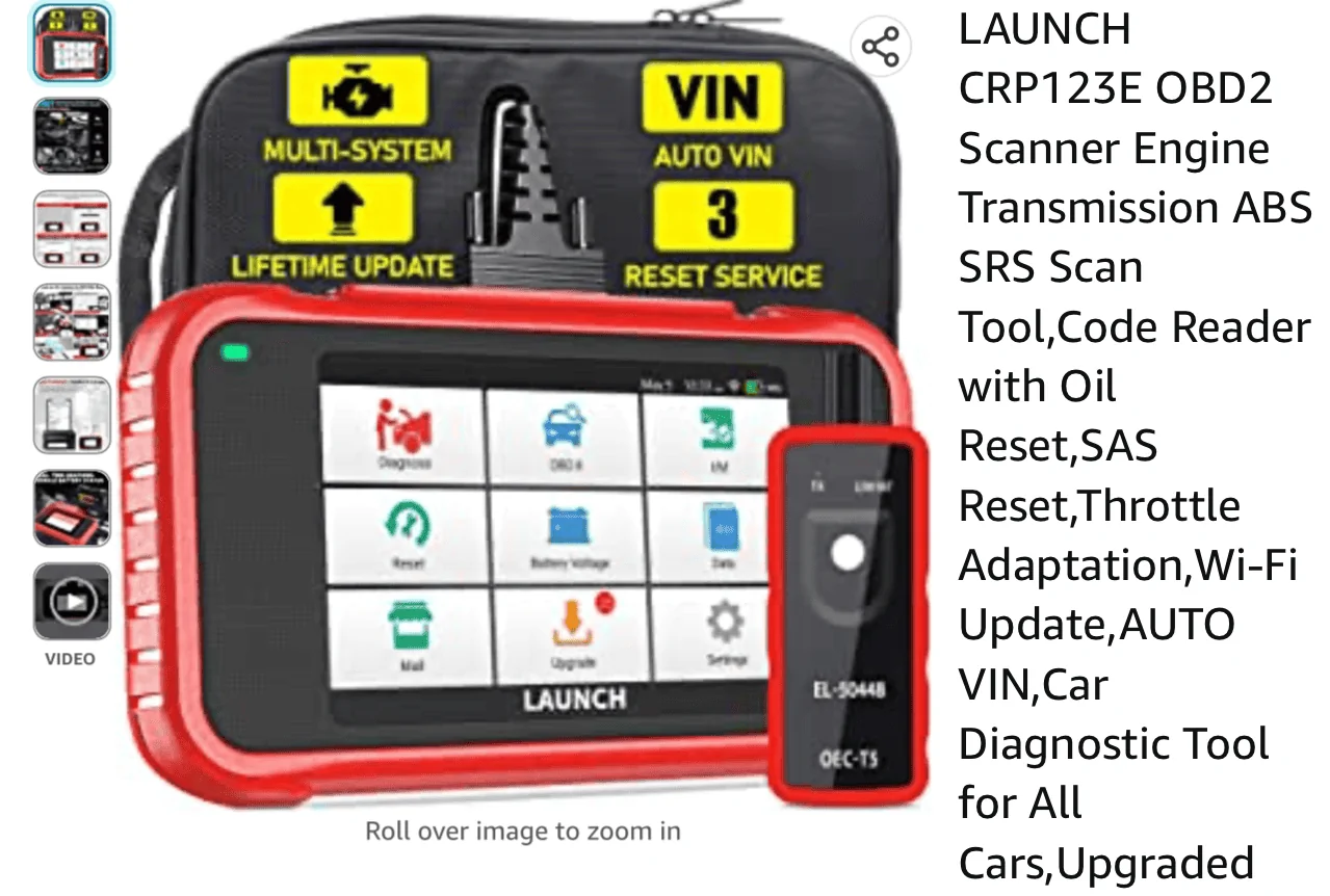

i checked the link you provided and you are correct about not for JL but it does seem to communicate with my Jl just fine. I may have to invest in one of the others shown there. I also use this scanner.
Jeep Wrangler JL JL OBD2 fuze location 1675104630227
