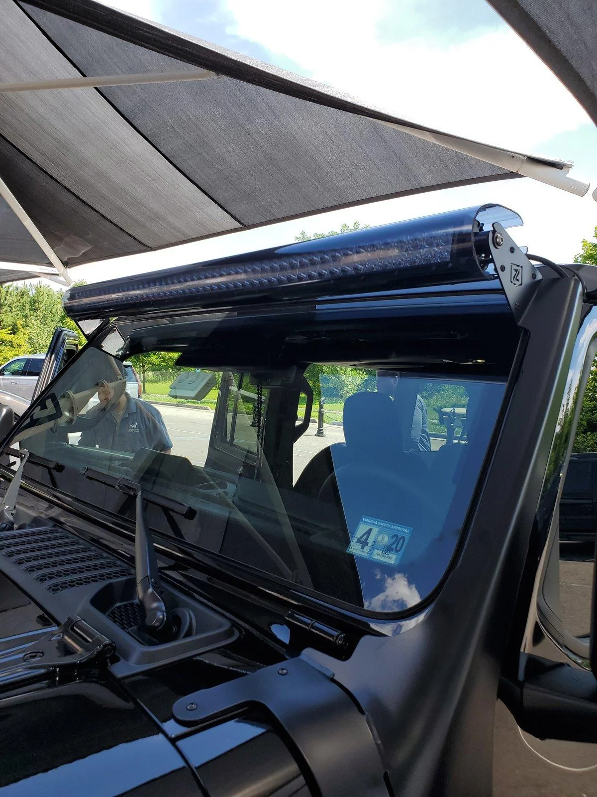

Hi. I installed a 50 inch light bar on my power top with a wind protector, its vibrates at 60 on the inside. Does anyone else have this issue? Any recommendations? I even purchased a Aerolidz cover and it still loud around 60.

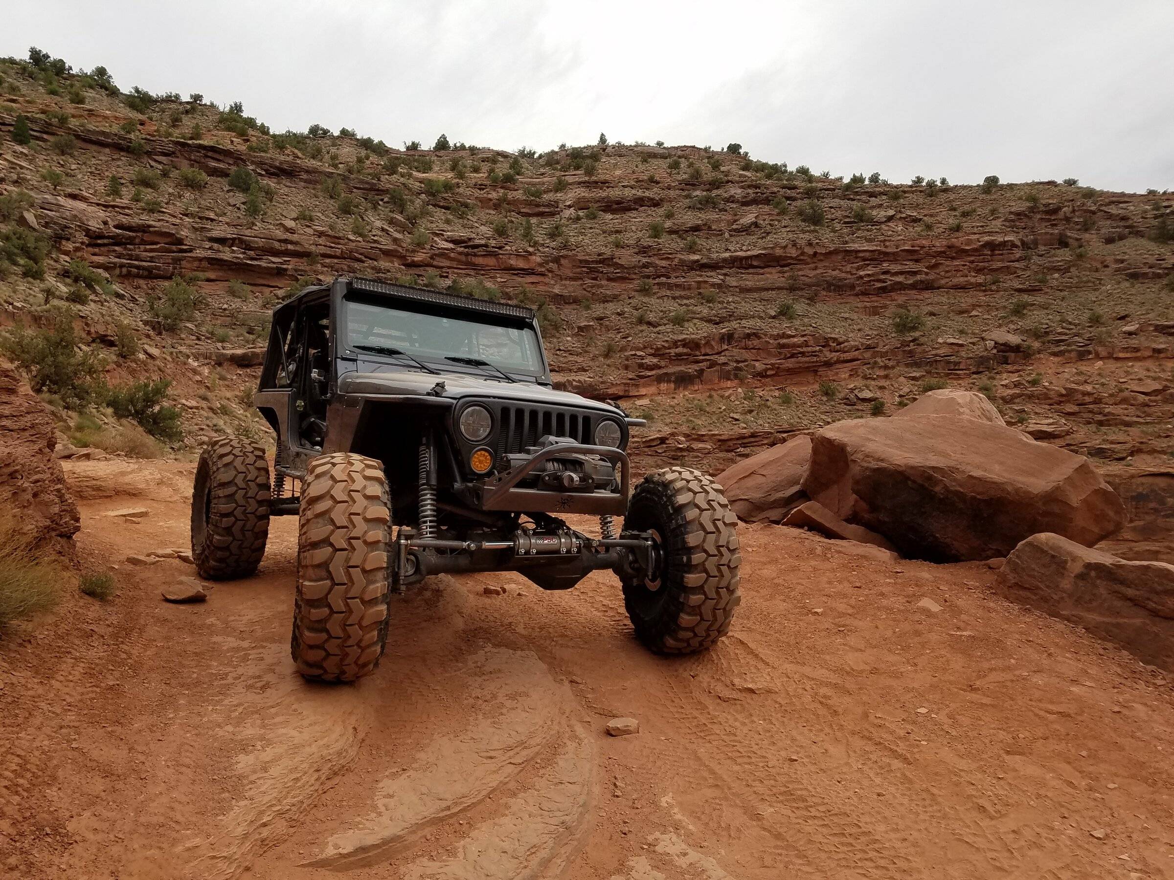

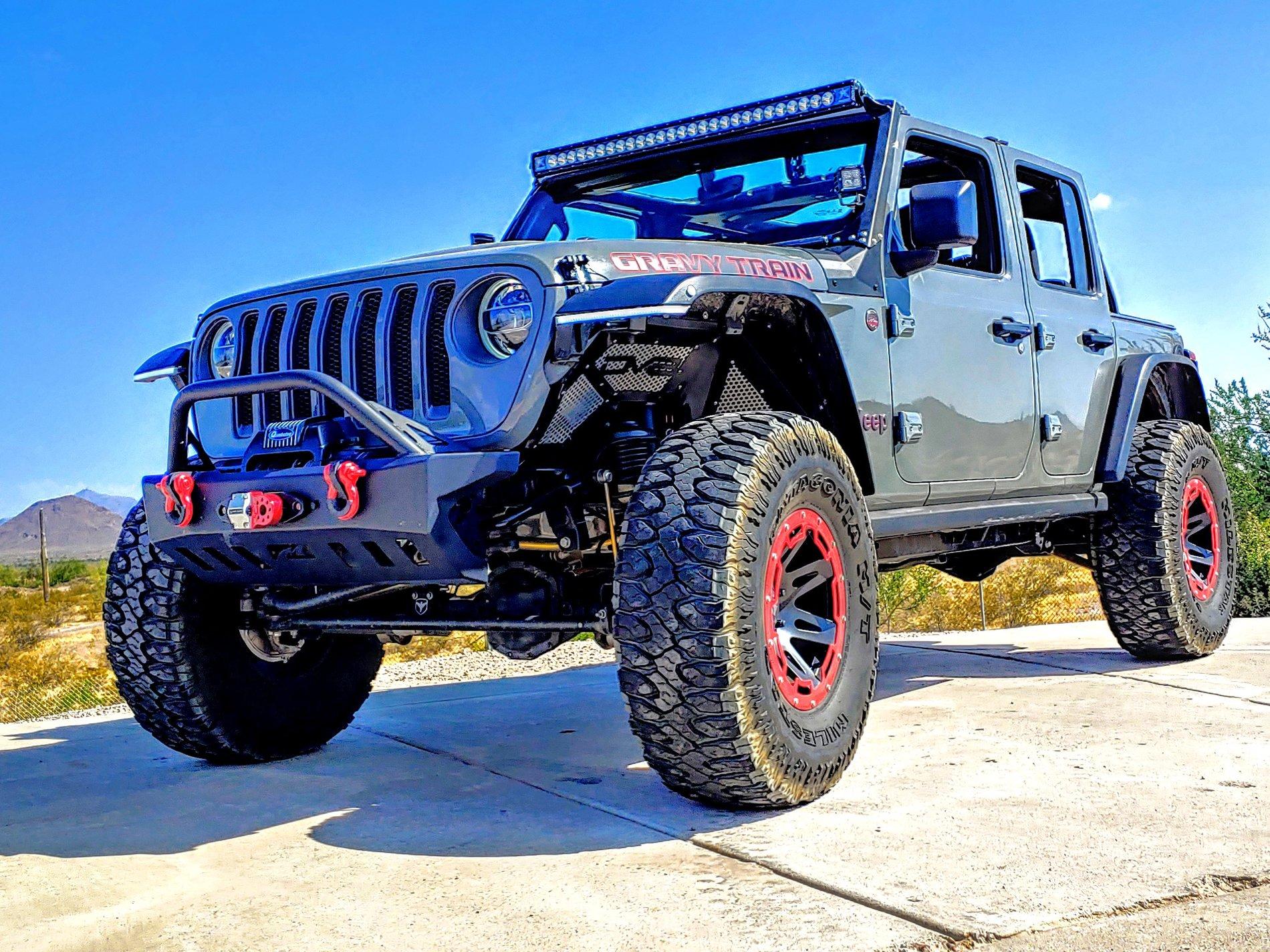

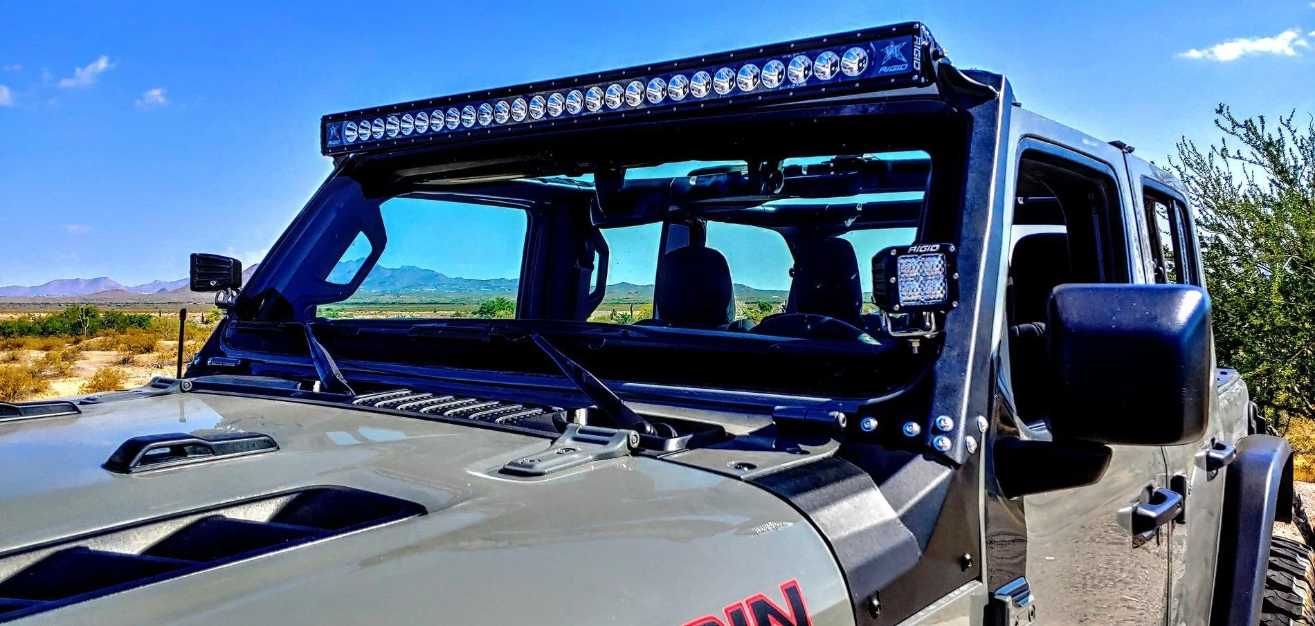

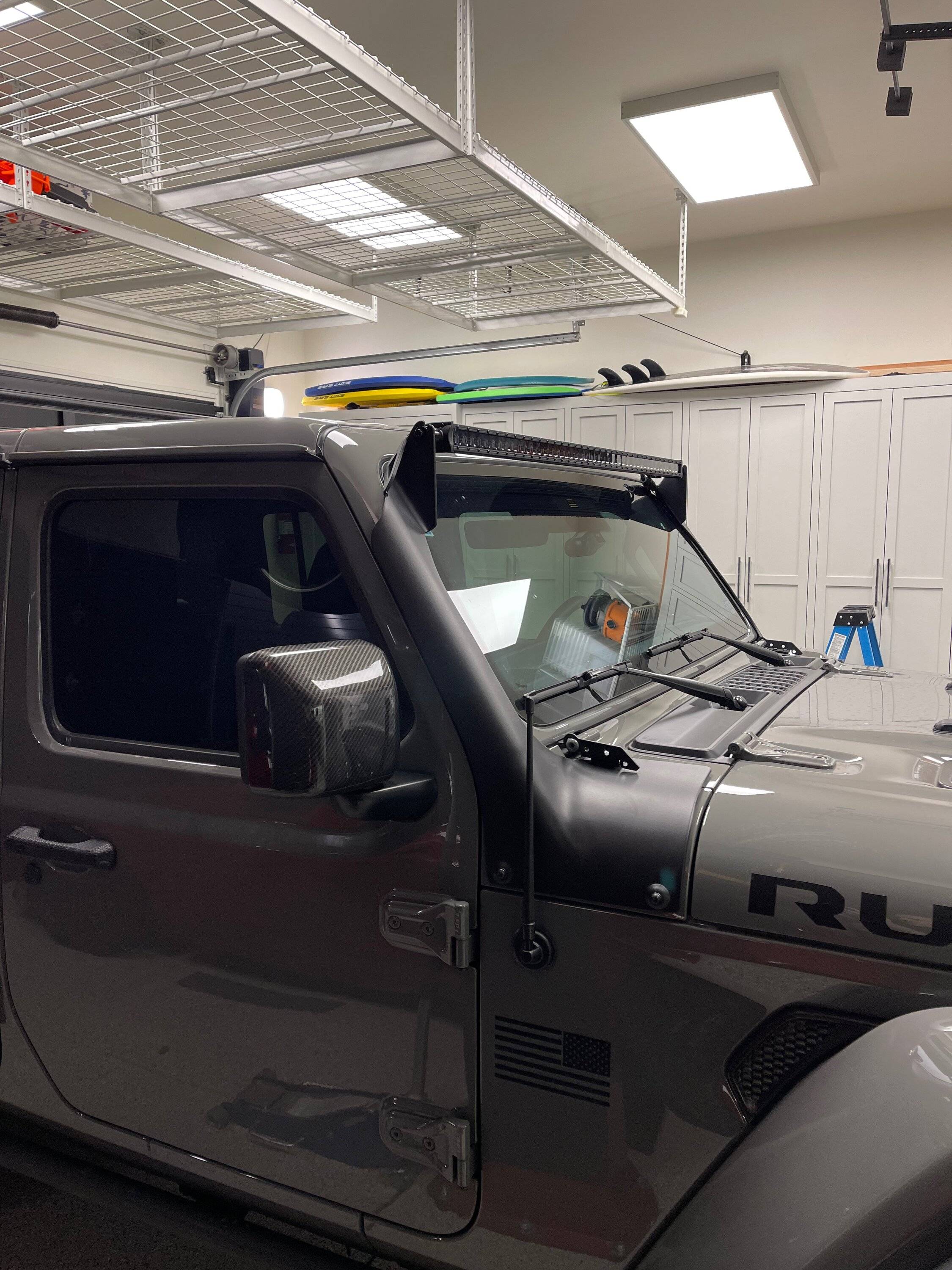

I must have hit the magic height and install angle with my set up. It doesnt make any noise at any speed. The mount is from Road Armor and the 50" is a Rigid Industries Radiance. I had almost the exact same set up on my JKU and I had to add door trim molding to the back of the light bar heat sinks to disrupt the air flow and silence the noise. I havent added a thing to my JLU set up and was amazed that it hasnt made one single hum.
Jeep Wrangler JL JL LIGHTBAR ISSUE 0602190902_HDR~2
Jeep Wrangler JL JL LIGHTBAR ISSUE 0602190900b_HDR~2

Dude, that sucks. Sorry. However the door molding trick is very easy and effective.

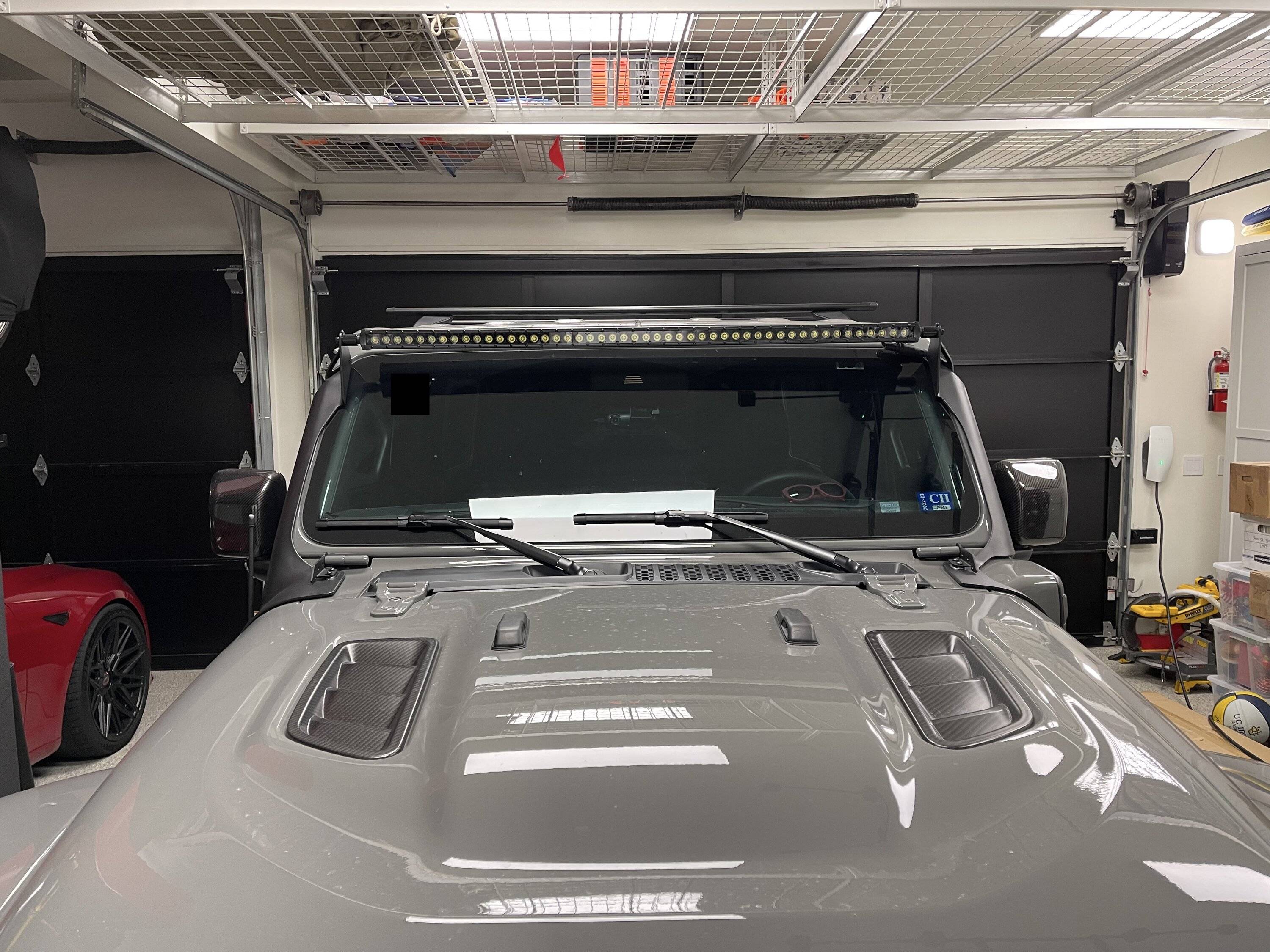

There will always be wind noise and turbulence with a light bar.
The noise you can get ride of is the whistling or howling. If you angle the light down slightly it helps, also the aforementioned tip above.

I agree, I use the door trim molding on my bar and it hardly makes a sound. Molding is cheap and can be purchased at most auto stores! Mine is really quiet.

On my last TJ I siliconed the fins on the edges and in the middle to stop the fins from vibrating. Worked like a charm. I used black silicone. 3 sections. Maybe 6" each section.

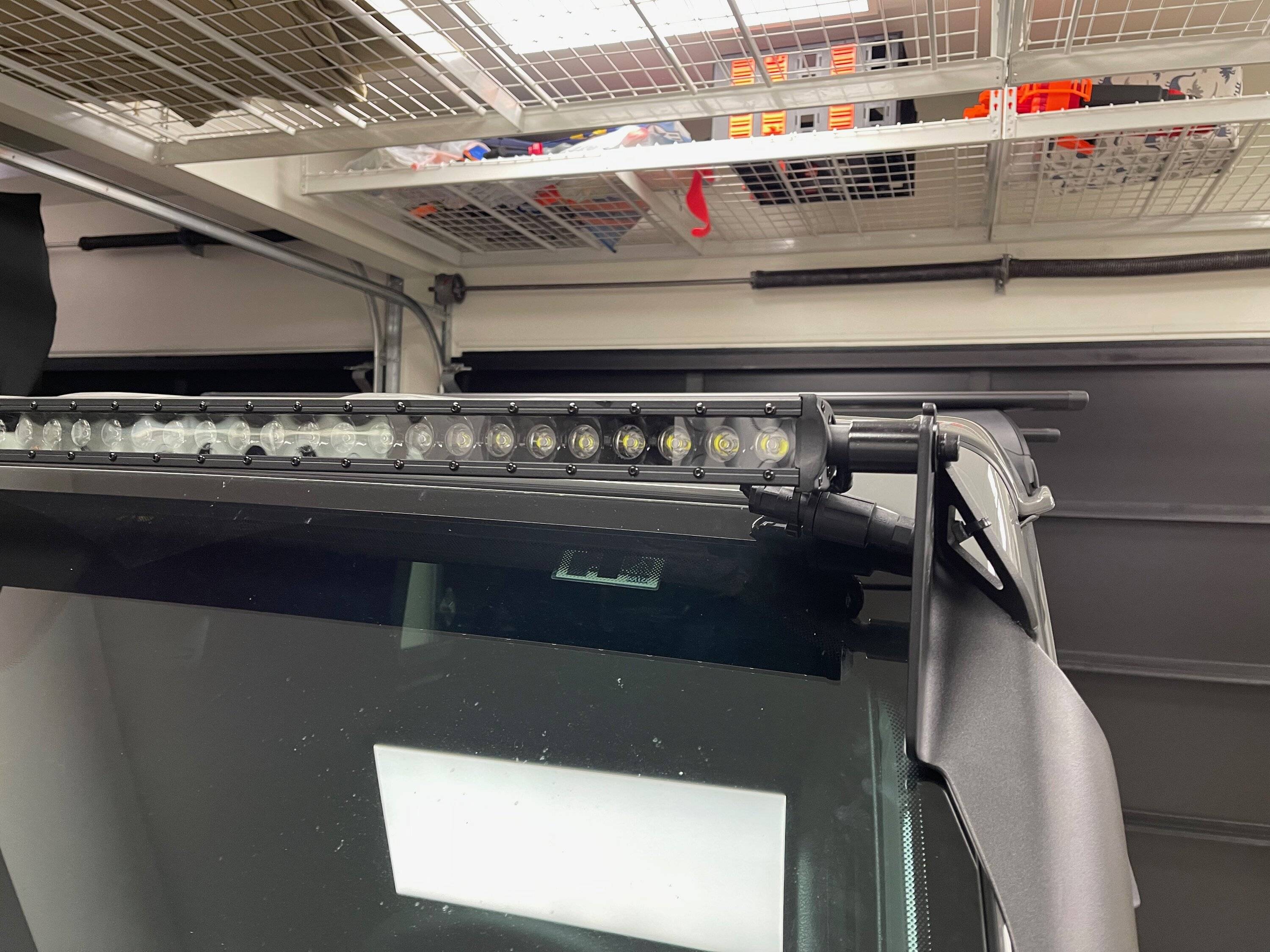

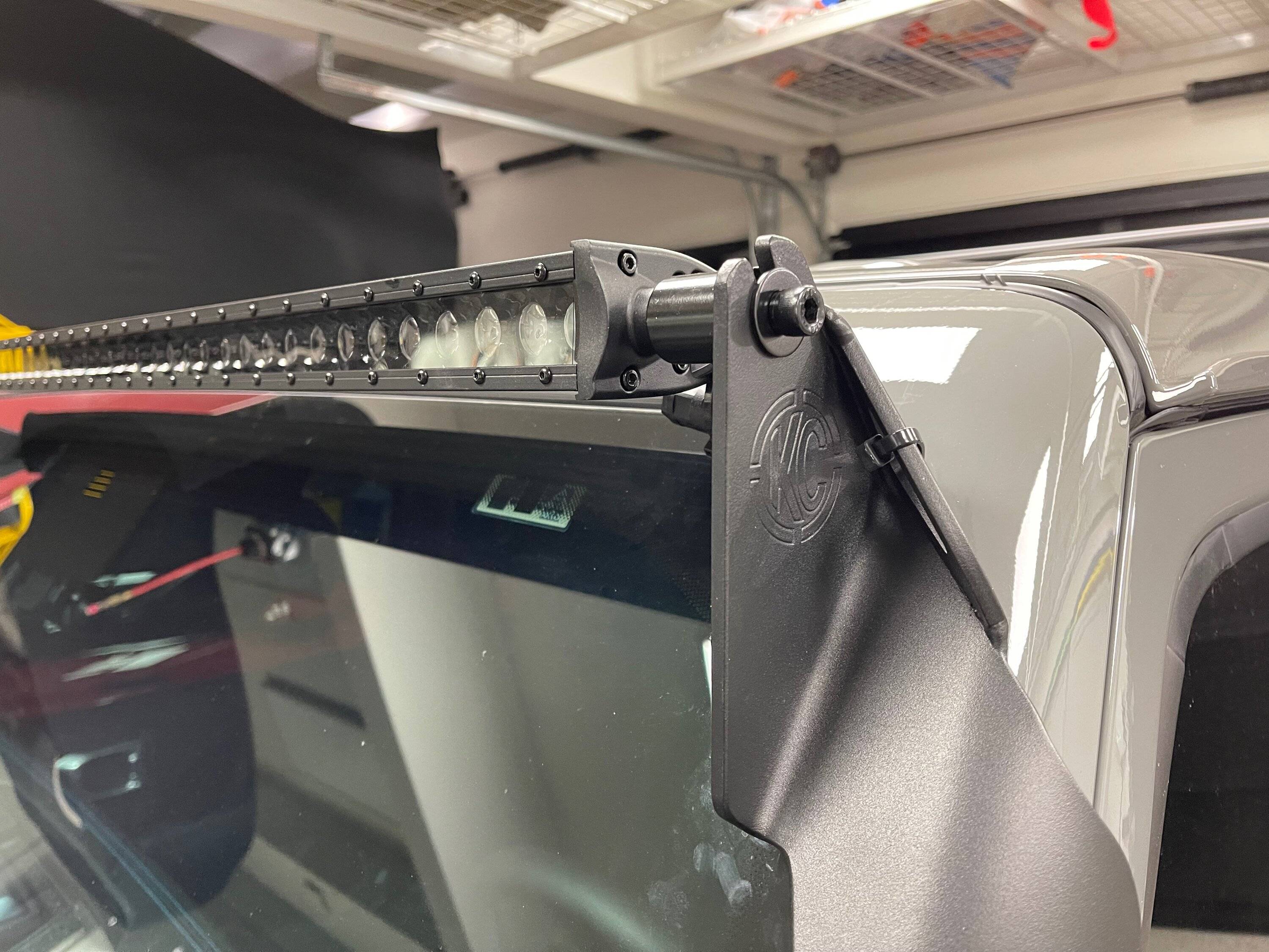

sorry to bring this one from dead but i too need help. I just installed KC overhead mount with RC 50" single row light bar. It looks great and lighting output is on another level. But the noise is absolutely unbearable.. i expected noise but this is nuts.
I wanted to ask if anyone can give advice as to which auto moulding to buy and exactly where to mount it? The RC bar is tapered in the rear similar to aero look on roof bars. I will also try aiming it down some as currently its perfectly horizontal. Here are some pics of what it looks likes.
Greatly appreciate everyone's help!
