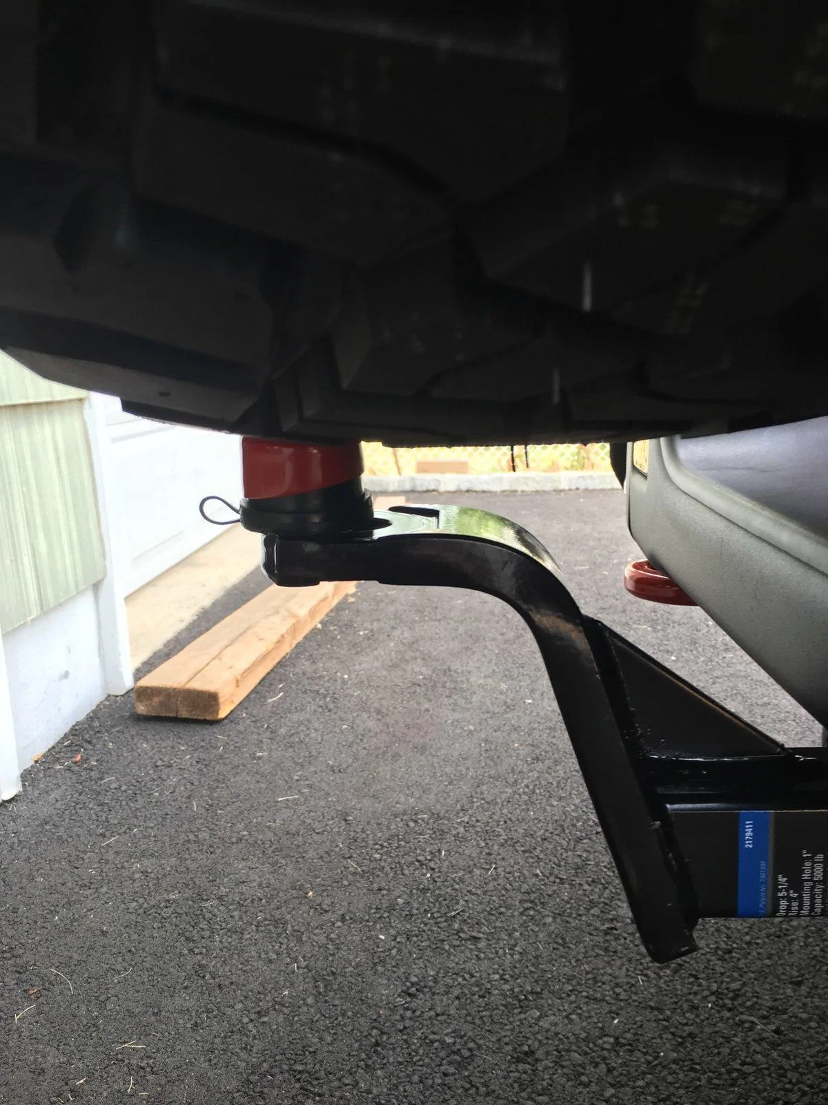

For a temporary fix I took my REESE trailer hitch which has a 5 1/4 drop and turned it upside down and put a rubber bushing between the tire and hitch. My tire or tailgate has been about 90% eliminated.

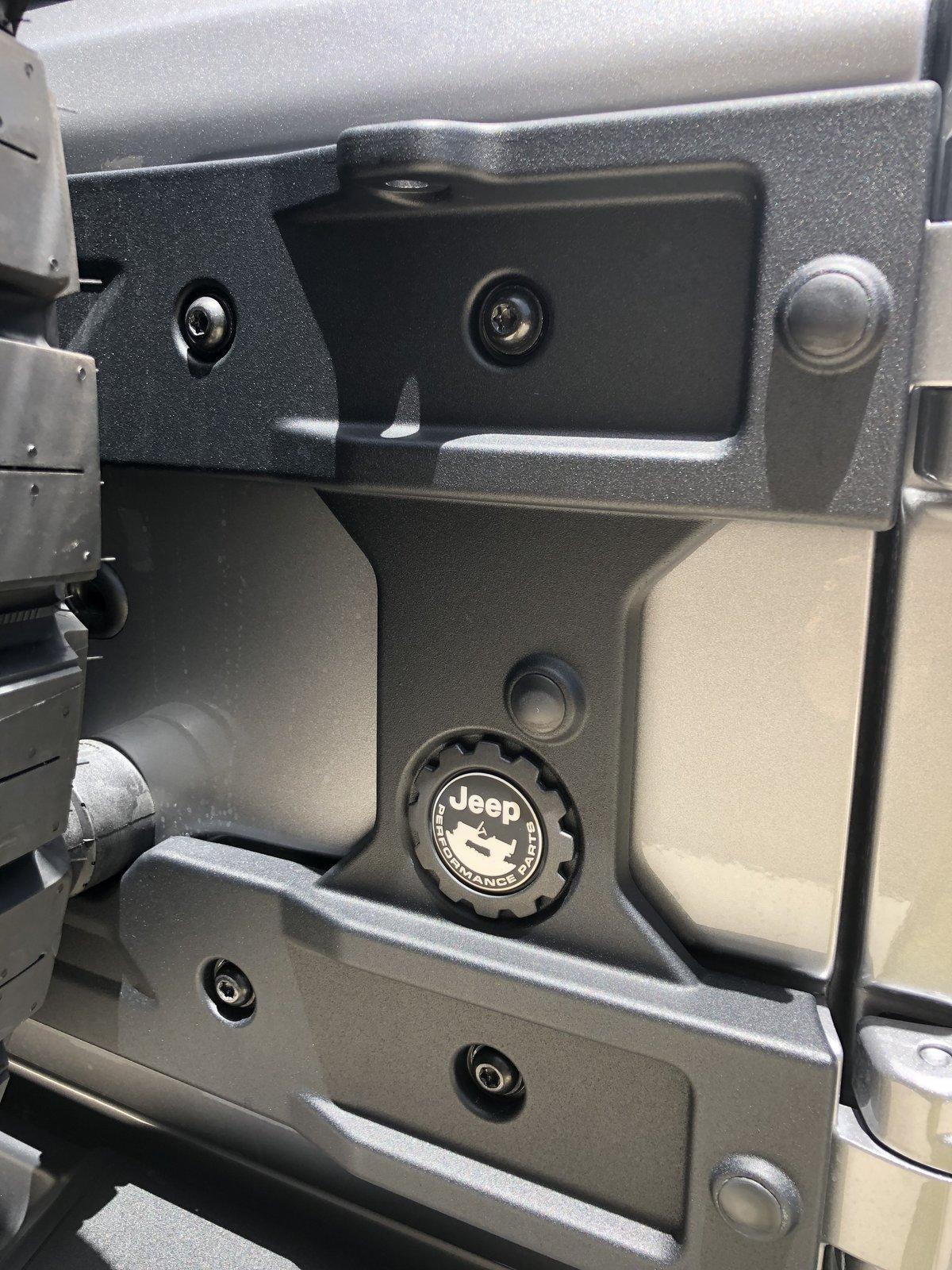

I can post a pic of the HD mounting bracket and the hitch with the spacer. I don`t know if I can upload a video, but if your facing the spare tire and hit the top of it you can clearly see it shake and have another person look at the bottom and top of the tailgate while you hit the tire with your hand and it clearly flexes. Not bouncing up and down but actually flexing. Everything is tight and blue Loctite was used

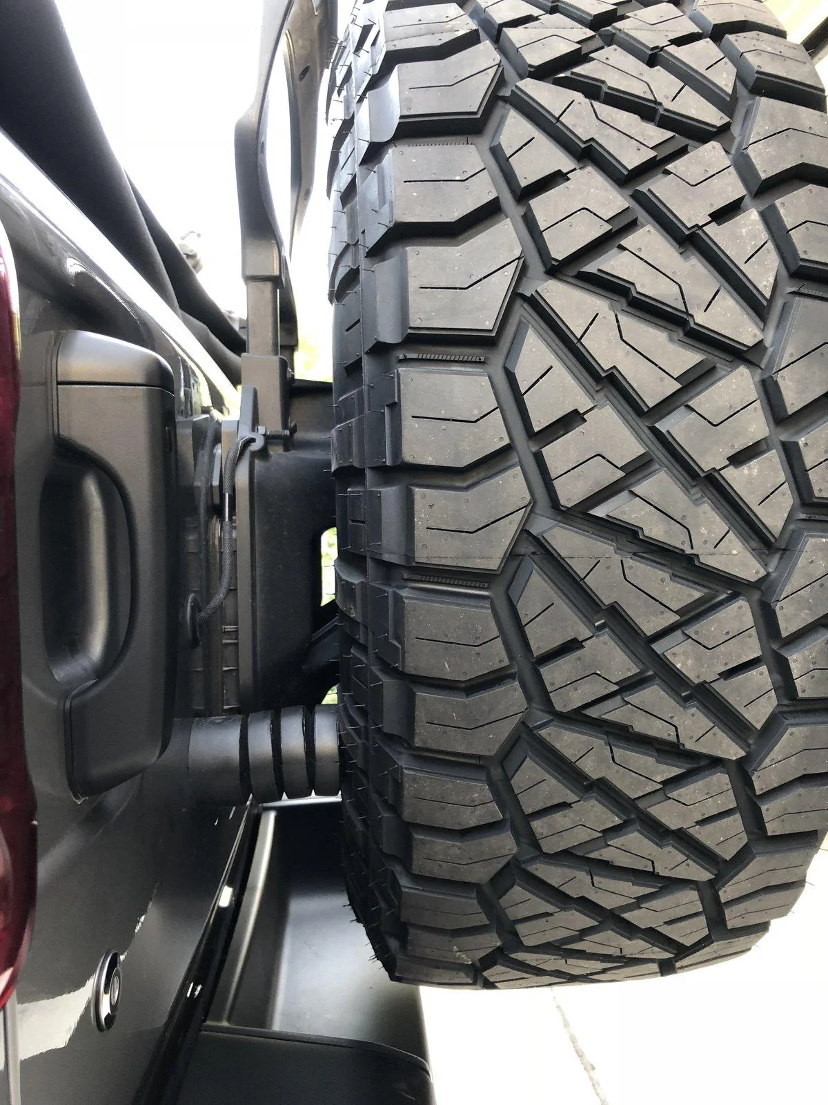

My neighborhood must think I’m crazy. I keep walking out and shaking my spare. No flex, no rattle. The whole Jeep is moving. My only suggestion is to tighten the four screws some more and see if it does anything. It’s pretty damn tight. How long have you had the bigger tire on there? I've only had mine for about two weeks so...

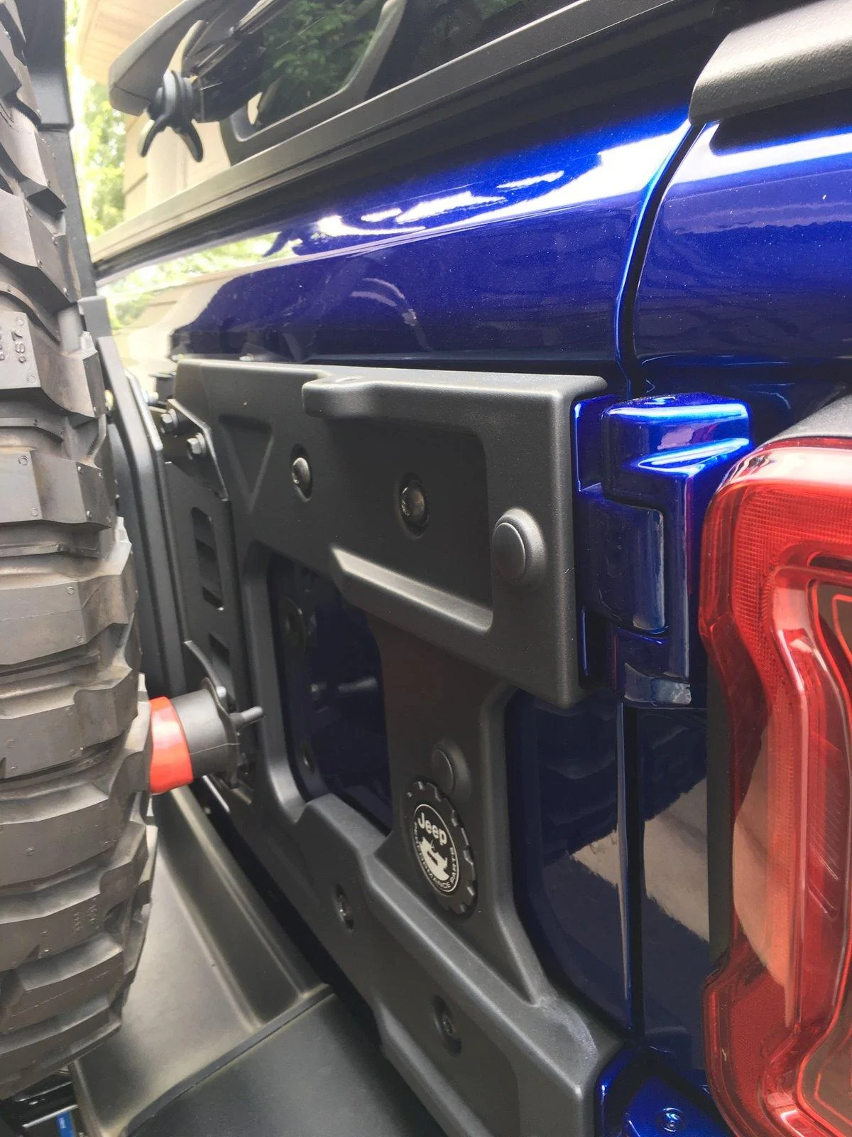

I agree I'm not 100% sold on the HD hinge. It simply reinforces the already thin metal on the tailgate and not the actual hinge itself. When the tailgate is open all that weight is still resting on the stock hinges with no additional support.
I currently have 35in KO2s on the stock rims mounted to the tailgate with no reinforcement, and by my calculations am just a few pounds shy of the weight limit. While I'm not concerned right now, I definitely plan to pick up an aftermarket bumper with bumper mounted tire carrier once more affordable options are available.
