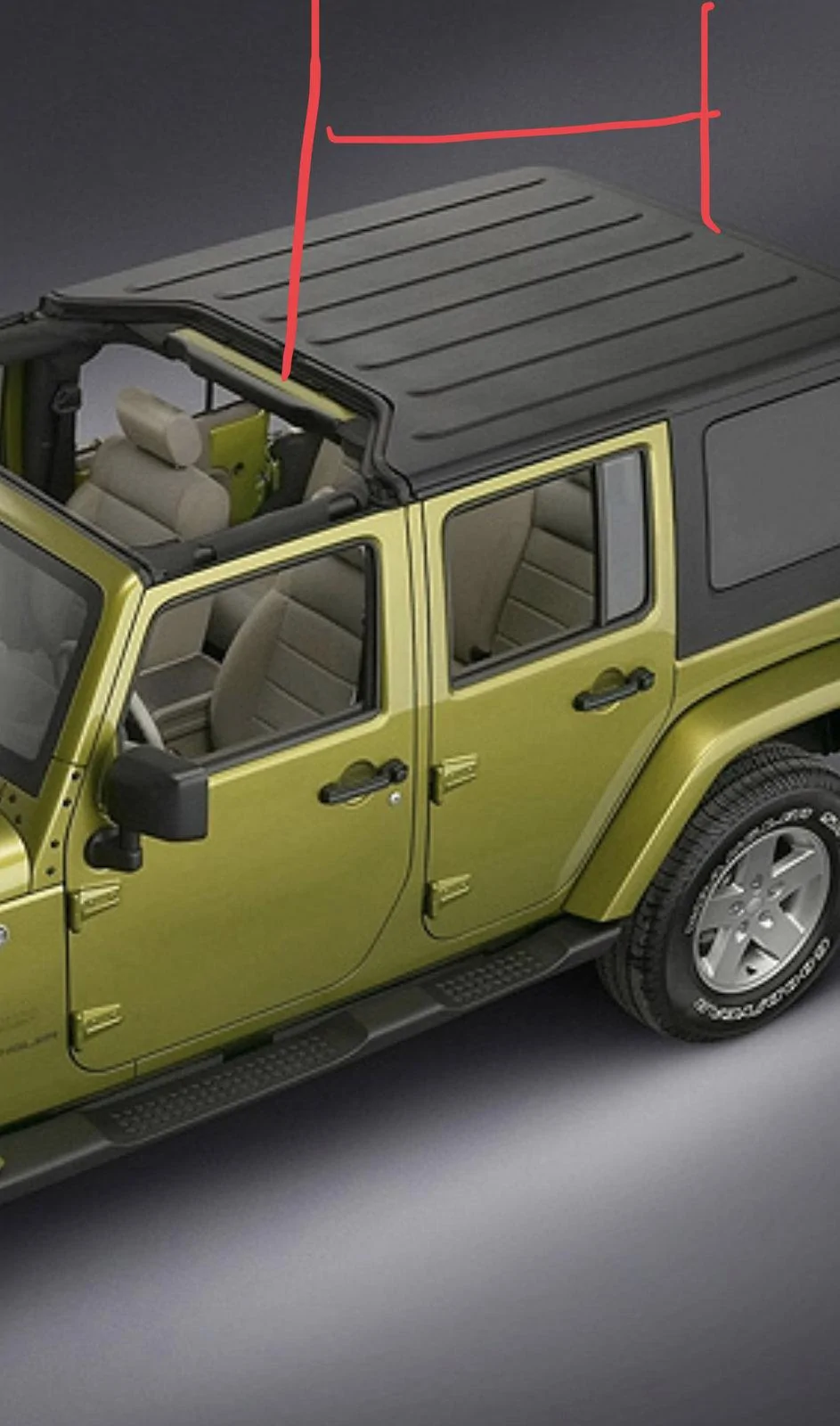

Can someone measure the hardtop of the new JLU 4/door? There are a few of us who need to build a table and/or hoist system and this would be of great help. It will still be several weeks before it arrives, but we could get started on building now. Thanks!
Any chance someone has the measurement of “A” from the middle (where it’s shorter than from the outer edge)?

Looking for this distance.
The entire length is 68". The distance between the curved part and the edge where the rain gutter stops is 3", so that should be 65" between those two points you marked in the picture. My hardtop is up on the ceiling and the Jeep is under it so I can't measure the entire length, but I can reach that one edge, which is 3". I used a yard stick as a straight edge to give me a reference point to the center curved point. Hopefully someone can measure the full part for you to confirm.

Thank you, I appreciate your help. I was guessing 6” shorter. I’m in early planning stages of designing my hoist & loft set up. Not a good idea to do this without the main ingredient (Jeep) but it keeps me occupied during the waiting period (ordered 9-29).

It is about 6 inches if you include those edges that go beyond the section that has the mini rain gutters. Yeah, I think I ordered about $800 worth of stuff before mine even arrived, so I know the feeling well. Tailgate table, molle pouches, roof rack, side rails, etc. etc. etc.
