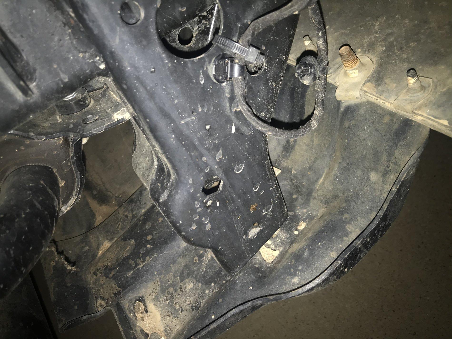

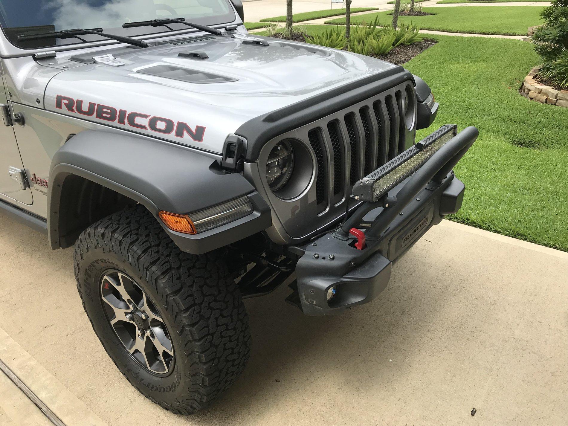

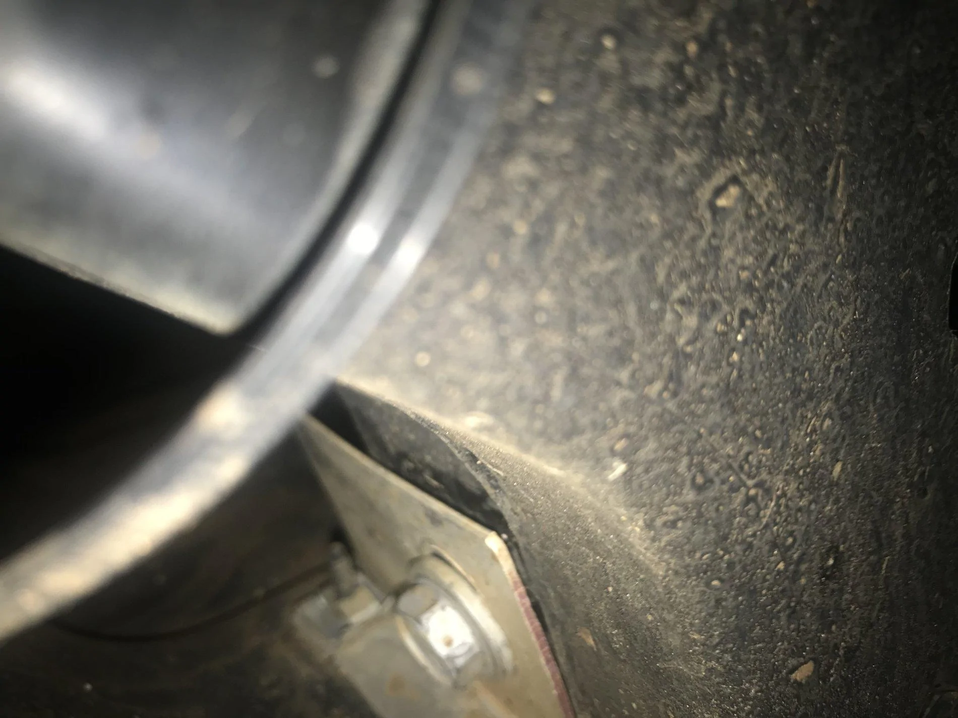

Here is a picture of how the skid is in relationship to the frame. And the second is the bracket attaching the skid to the frame piece.

I know the front bumpers work, I have a JK hard rock steel bumper on mine, what about the matching winch plate?
I got the hard rock/10th anniversary bumper to fit pretty easily, I wallowed out the holes on my JL and put the strengthening plates between the JL mount and the bumper (since the JL didn’t use any) to push it out slightly. I now think I might have just been able to swap tow hooks instead of making the holes bigger. I used my plastic bumper fog light harness and put its LED fog lights in the bumper (I already had the light adapters). Skid plate fit and protects the sway bar disconnect although I had to make adapters to mount the bottom to the hangy down part of the JL where the brace of the plastic bumper connected.

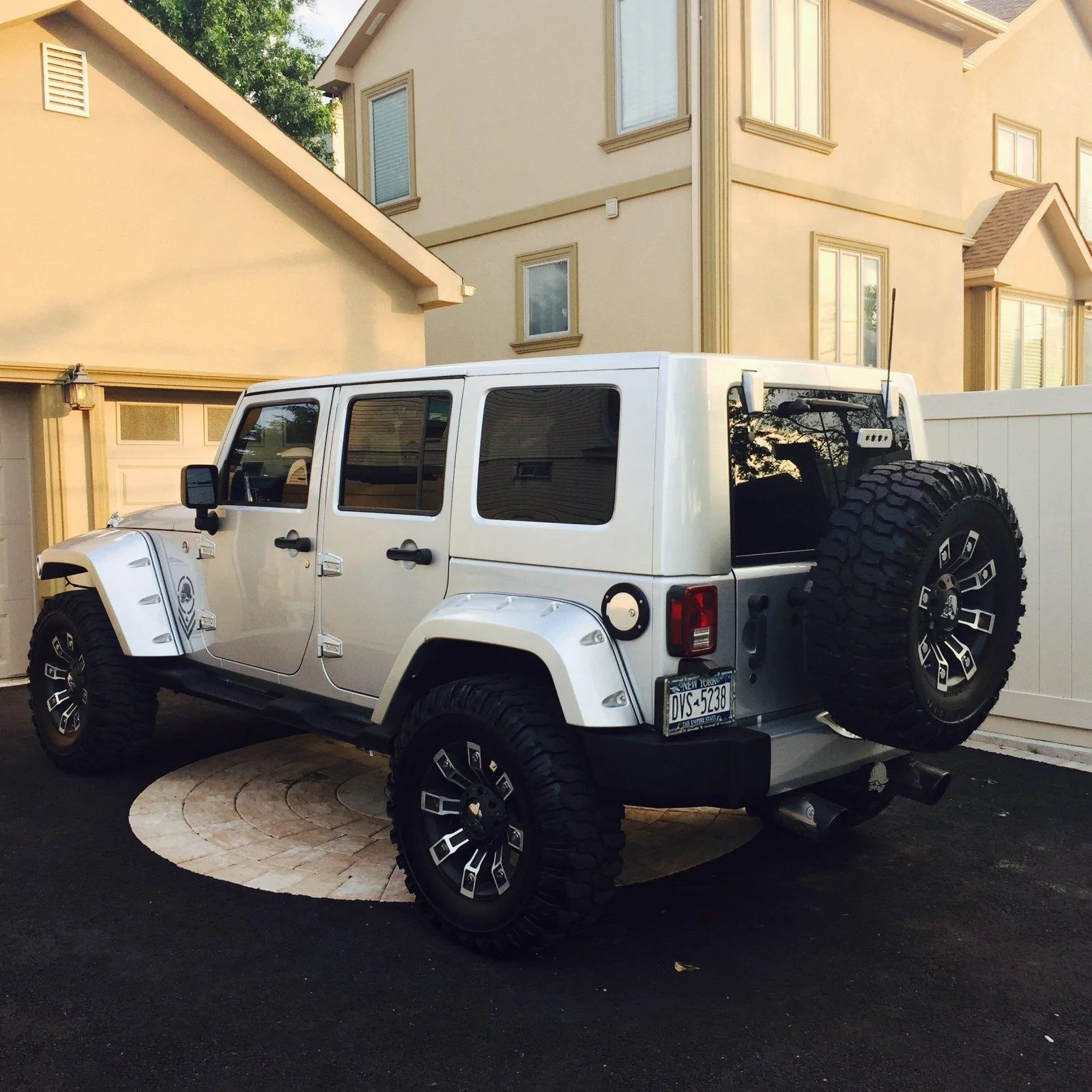

Would anyone happen to know if Max coverage Bushwacker JK fender flares would fit on a JL? I have seen multiple manufacturers advertise fender flares for 2007-2020 Wranglers and I need something with extra wide coverage. Thinking I can have fabricator modify the Bushwackers to add a place for JL fender lights.
