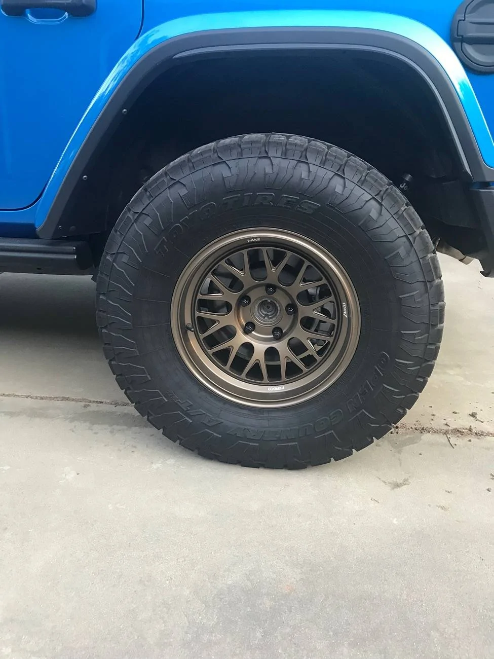

12.50’s on 8.5” -1mm the tread is ~ even with XR extensions
Jeep Wrangler JL Jeep rubicon X wheel question CA47E629-0B4C-409F-9653-D3B4517A44A9

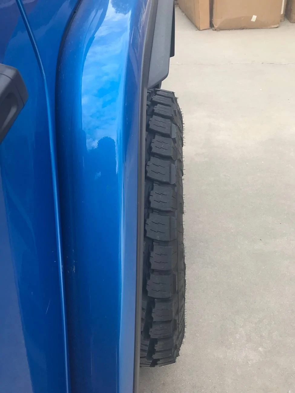

-12 would be ~ 1/2” poke
Jeep Wrangler JL Jeep rubicon X wheel question E4D14903-26D3-4C27-83BF-EFC523F9B2CD

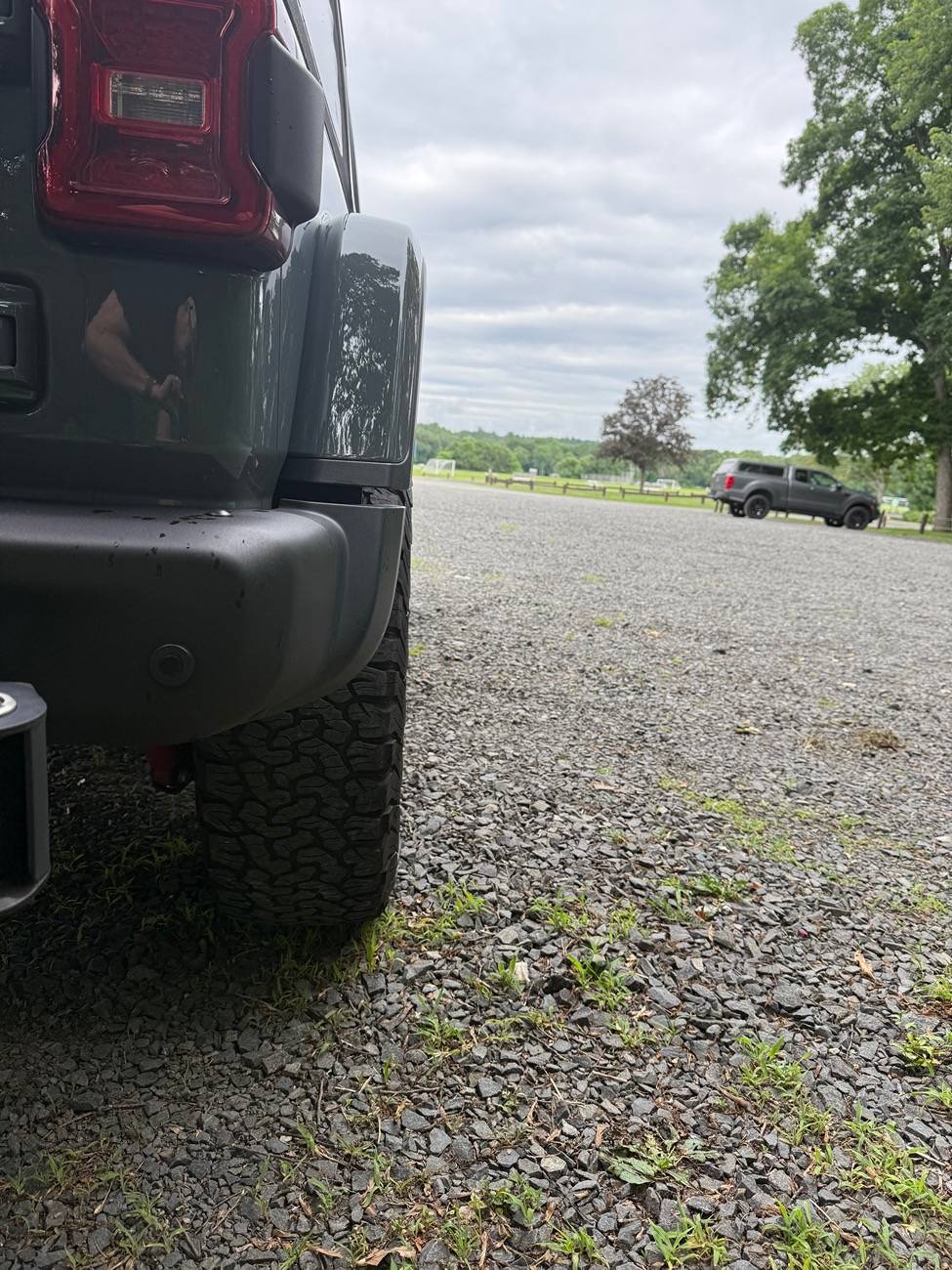

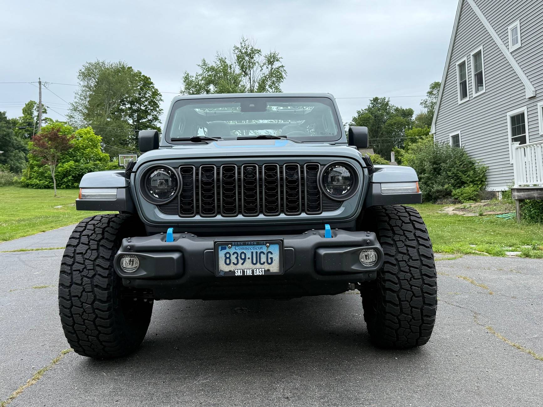

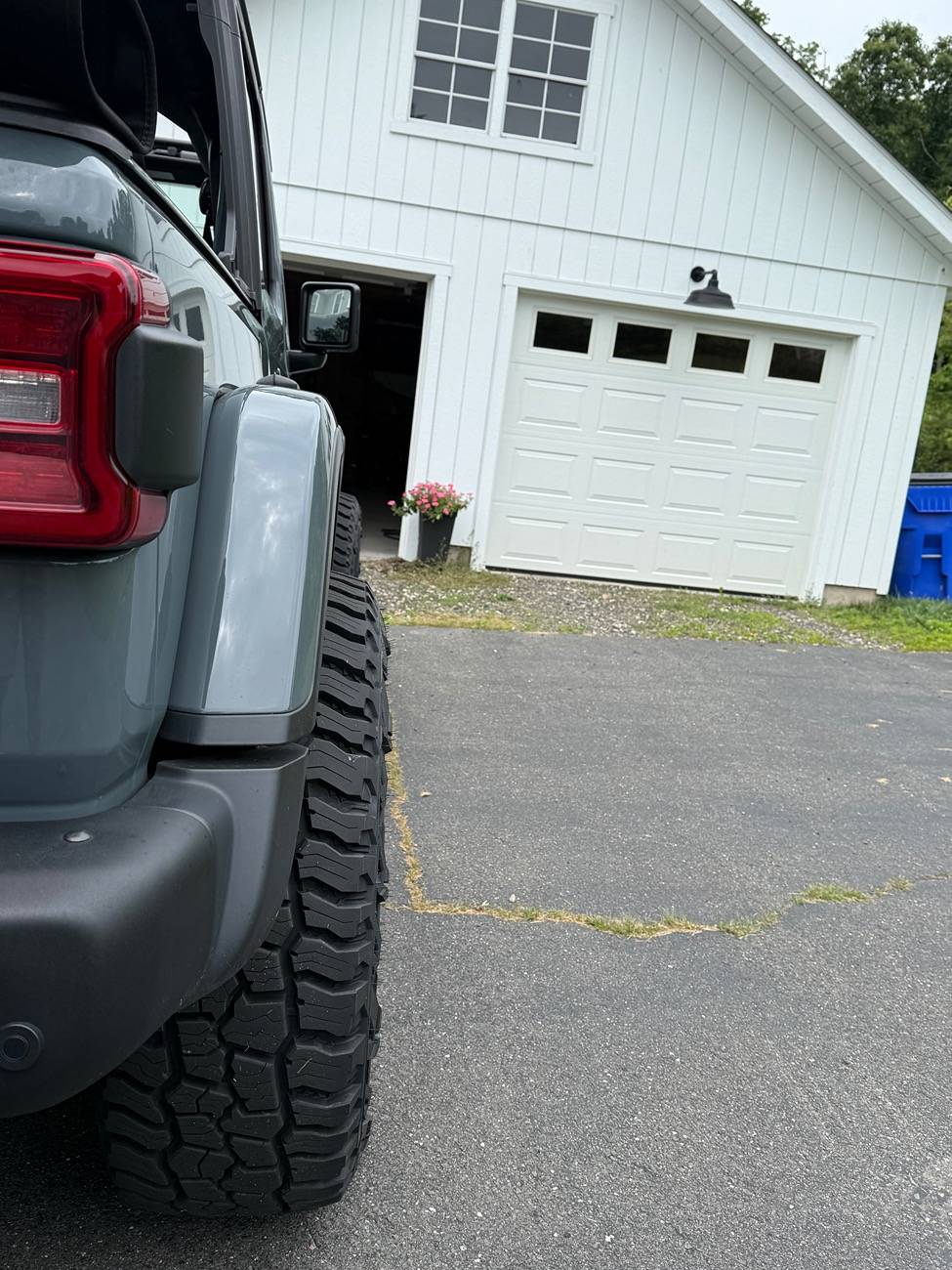

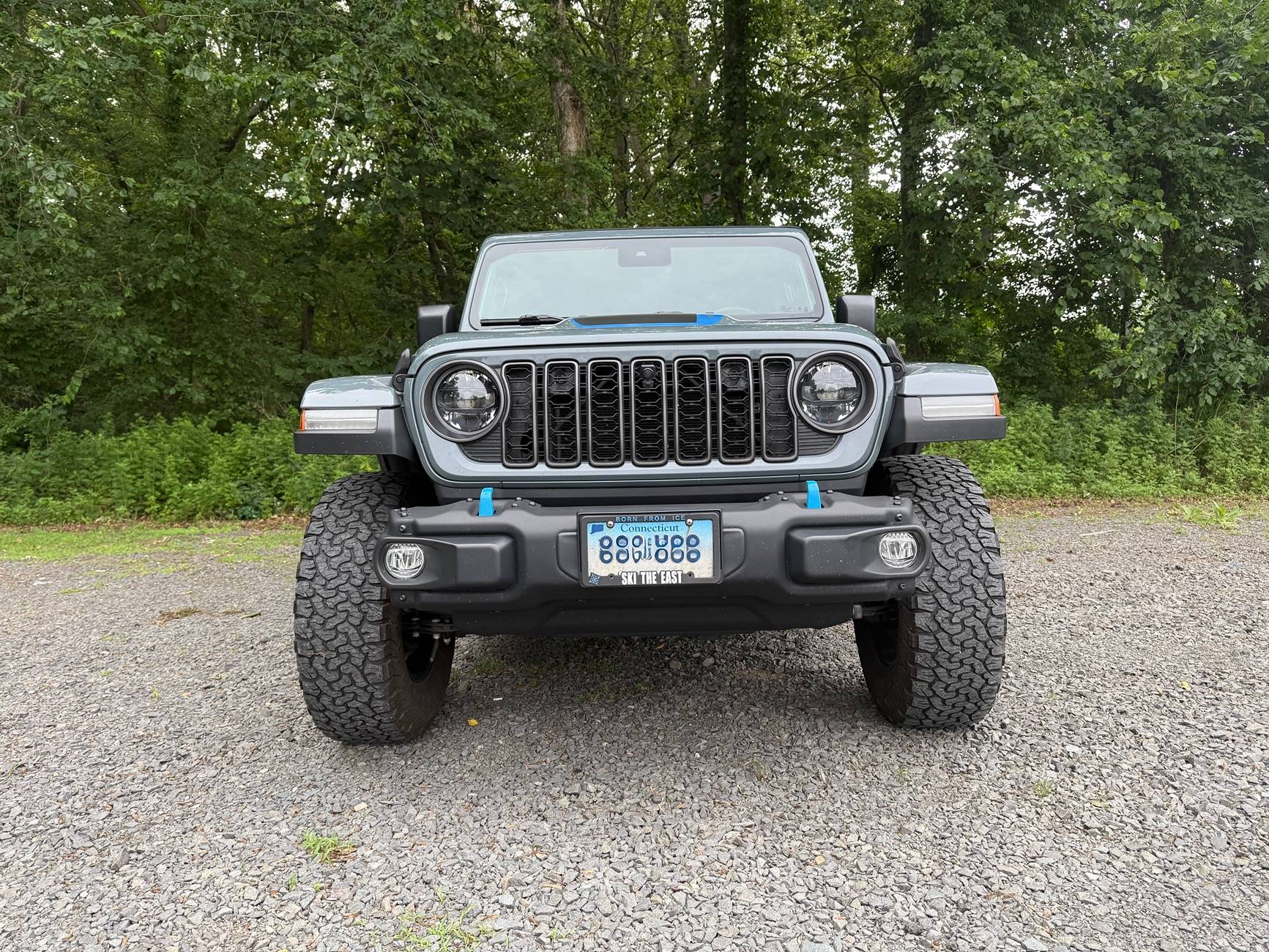

2024 Wrangler 4xe Rubicon X
2024 Rubicon X - with Fuel Rebel 17x9s -12mm offset and Mickey Thompson Baja Boss AT 35x12.5s stock suspension (before and after)
Jeep Wrangler JL Jeep rubicon X wheel question IMG_1319
Jeep Wrangler JL Jeep rubicon X wheel question IMG_1323
Jeep Wrangler JL Jeep rubicon X wheel question IMG_1305
