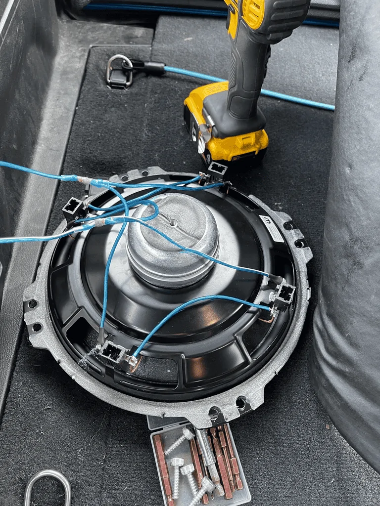

Jeep Wrangler JL is the alpine premium amp bridgeable? 0757476D-4B08-493E-89DC-57A1DA227E1E
Each of the coils is a 2 ohm load. Solder 2 of the adjacent terminals and then take the opposite terminals and connect them. The two lines to the left are connected to the 400.1 amp. I have been running that since June when I installed the Stage 6. The amp hasn’t killed it yet. Hope that helps.
