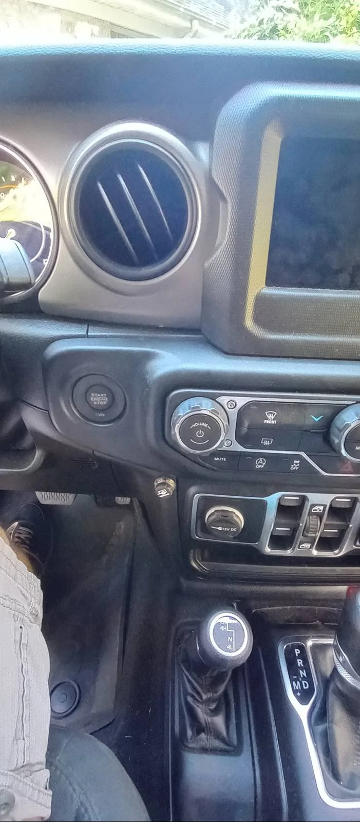

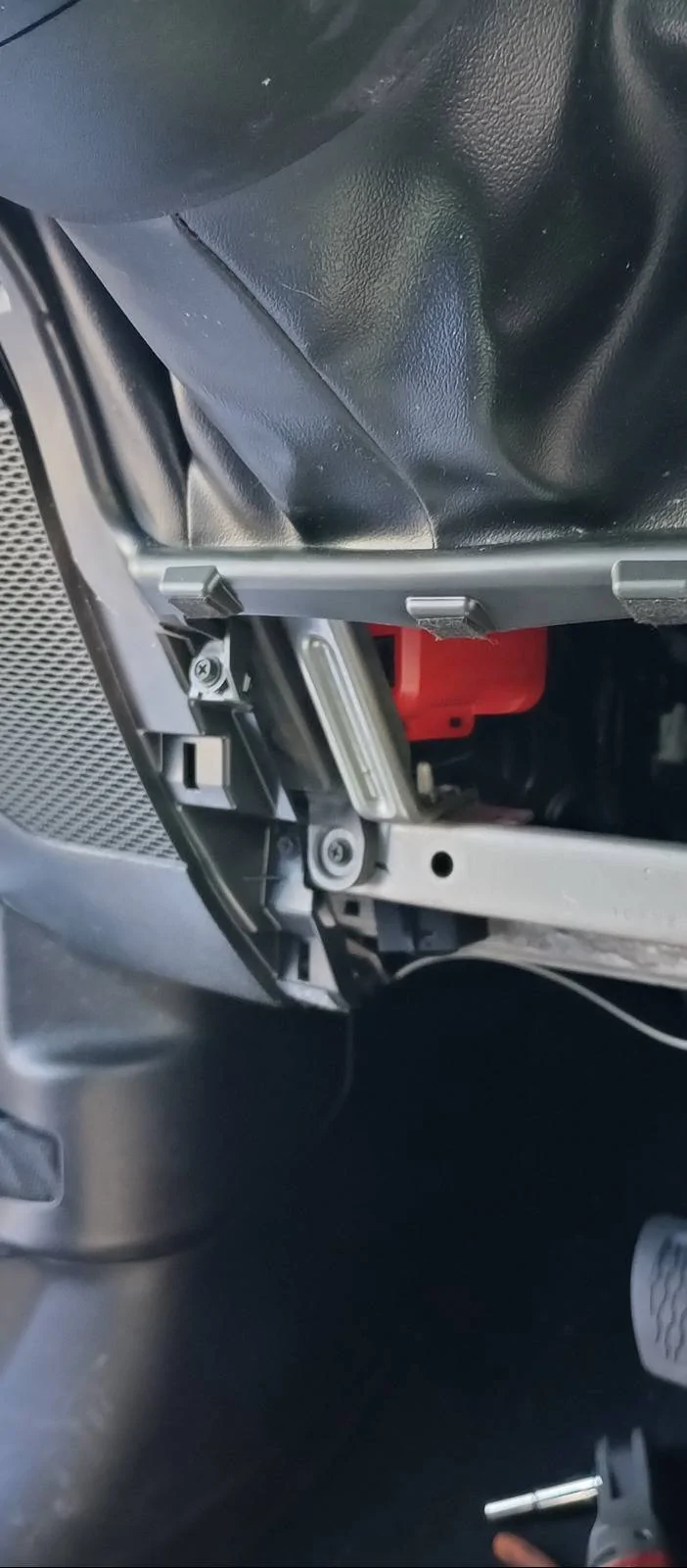

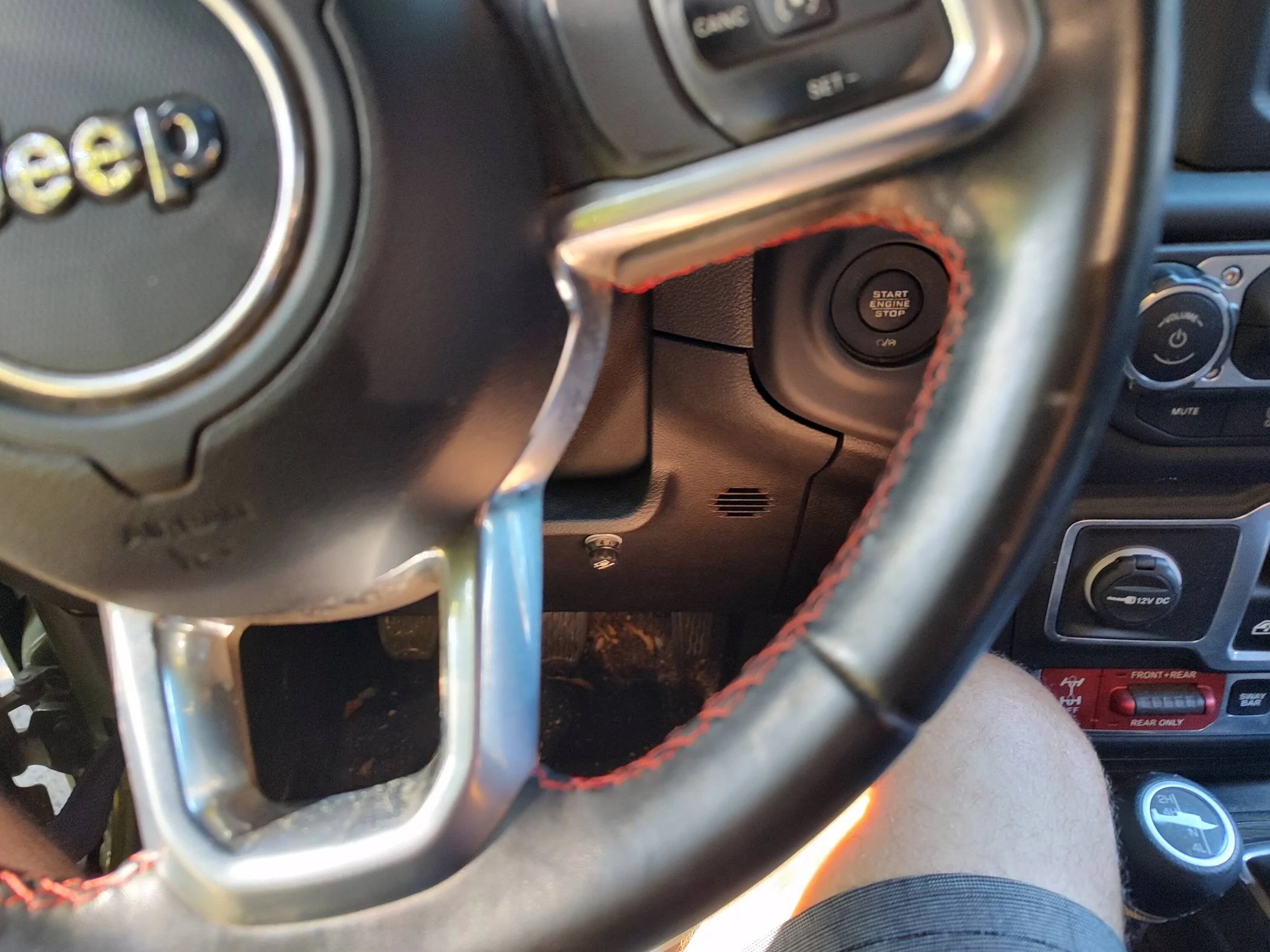

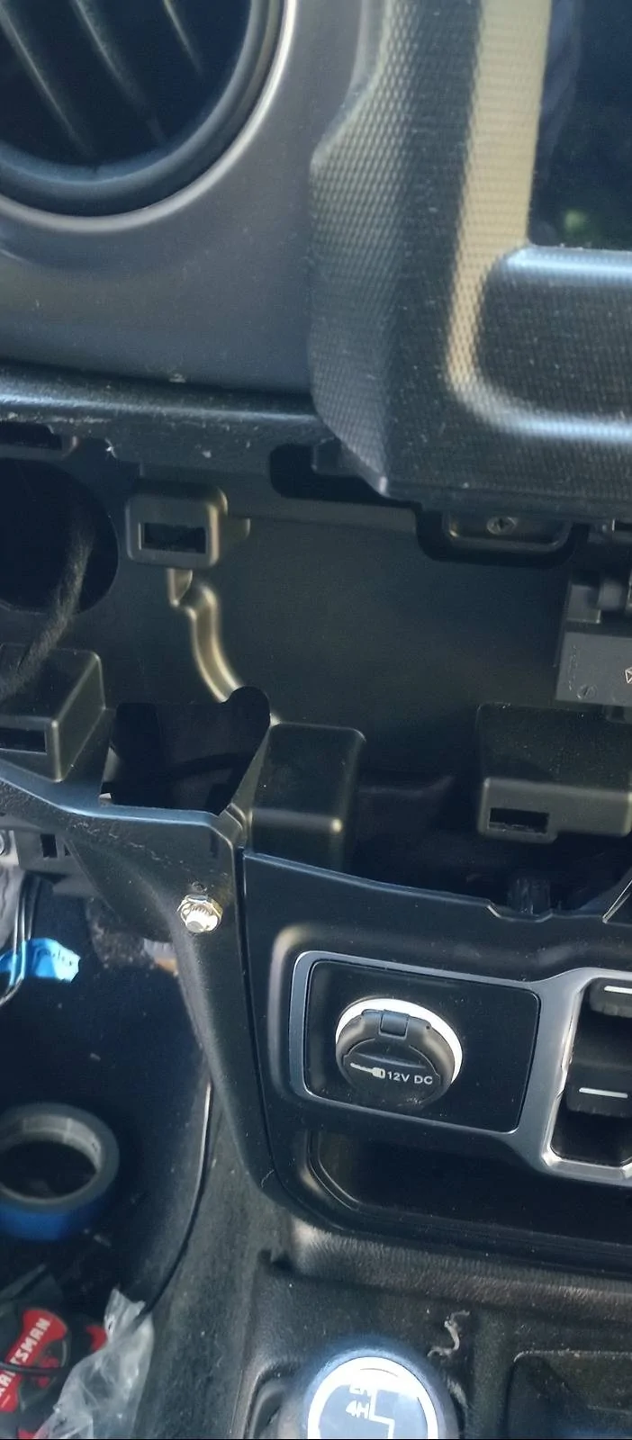

Hi @Jeep Wick
Where did you mount your RedArc control knob, and where did you mount the "brain"?
Thank you.
On my first Jeep I put it under the steering wheel, that panel was easy to remove I just had to dremel a space for the knob housing. The box was mounted behind here under the left side dash with command strips. Working on the current Jeep this weekend, maybe near the climate control but I'm not sure until I get behind there. I've seen some mounted near the shifter but I don't think I want to do that.
