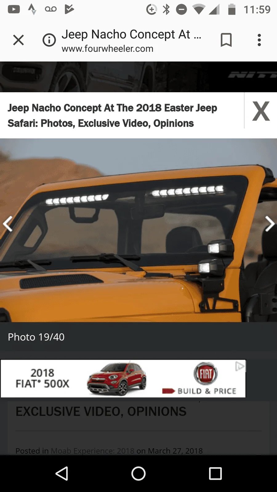

I came across this recently and I was wondering two things, #1 is this available? #2 how well would it work?
My thought is if it was tight against the glass (with some type of rubber gasket) it would work reasonably well but I am curious on other people's thoughts.
Jeep Wrangler JL Inside the windshield LED's? Screenshot_20181021-115950

Not available, just a one-off job for that Nacho concept. I don't think you'll see a widely available aftermarket solution for liability reasons. If you lost a mount, and it falls onto your dash/steering wheel while driving, that could be bad. Likewise, if you get into an accident and your head makes impact with it, that could be ugly too. Though if one were good with plastic and padding to make it safe, it would be perfectly safe.
But as far as the concept is concerned (now that the risks have been explained), it is a good location because you don't get the wind noise, and in your face looks. I know someone who has an inside mount on his F-250 and it works very well, and is tightly sealed so there is no glare. It can get a little warm, but then again it is a 54" RDS he has.

One thing that I noticed when I put the first lights on the safari rack on my XJ was that when they were turned on, they lit up the hood and glass so much that visibility was actually *decreased*. The lights needed to be placed further back so that the roof of the XJ would act as a bottom "shade" to keep the light from hitting the windshield and hood or a portion needed to be added to the bottom of the lights to keep the light from hitting the windshield and the hood.
So, this sort of design *could* work, but it needs to be sealed correctly so that no light escapes on the glass and the light needs to be recessed enough so that no light hits the hood.
