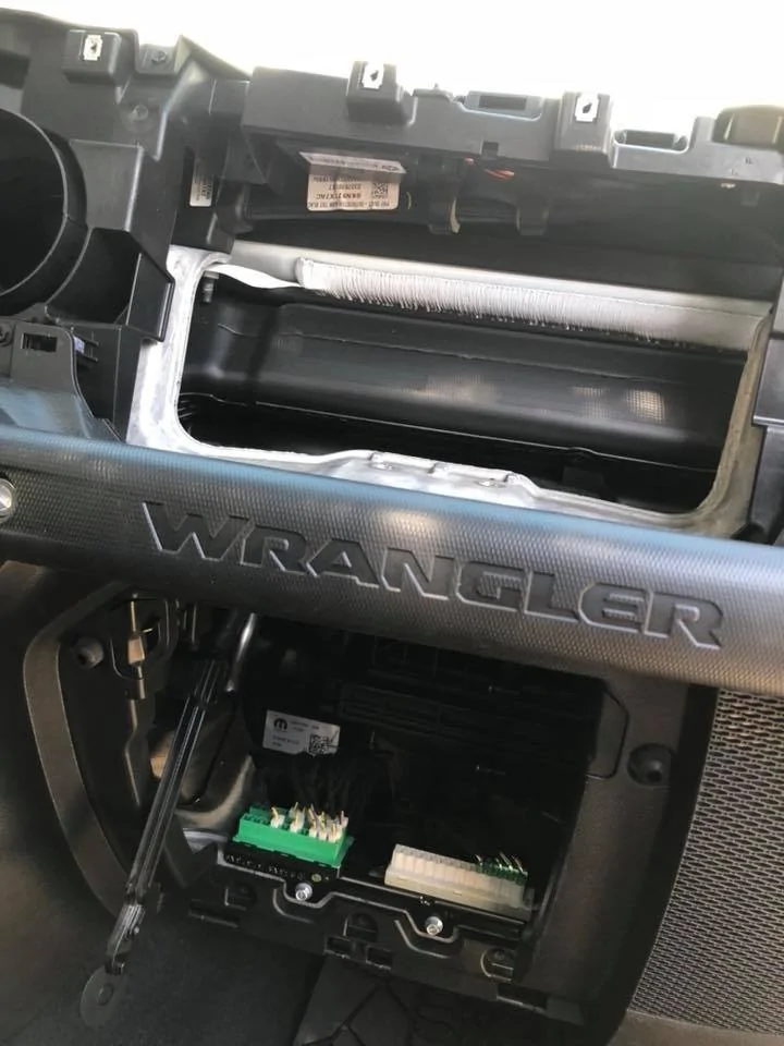

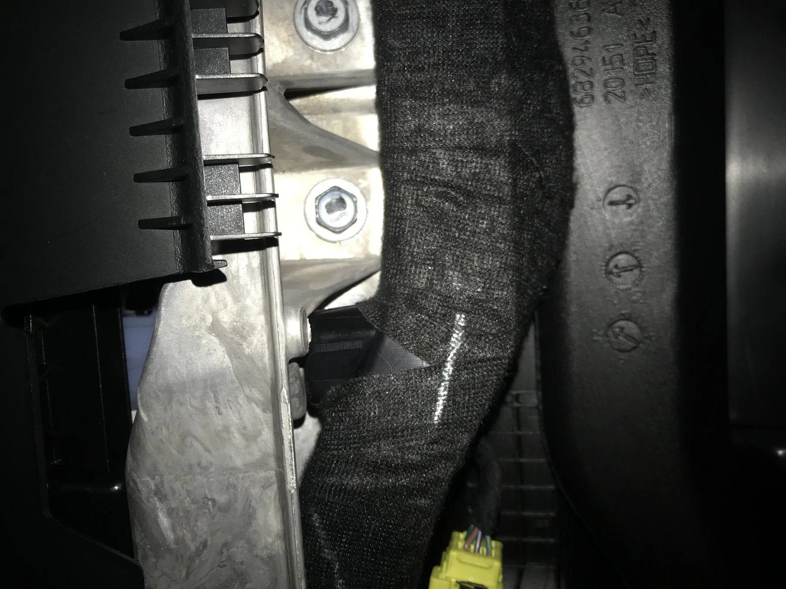

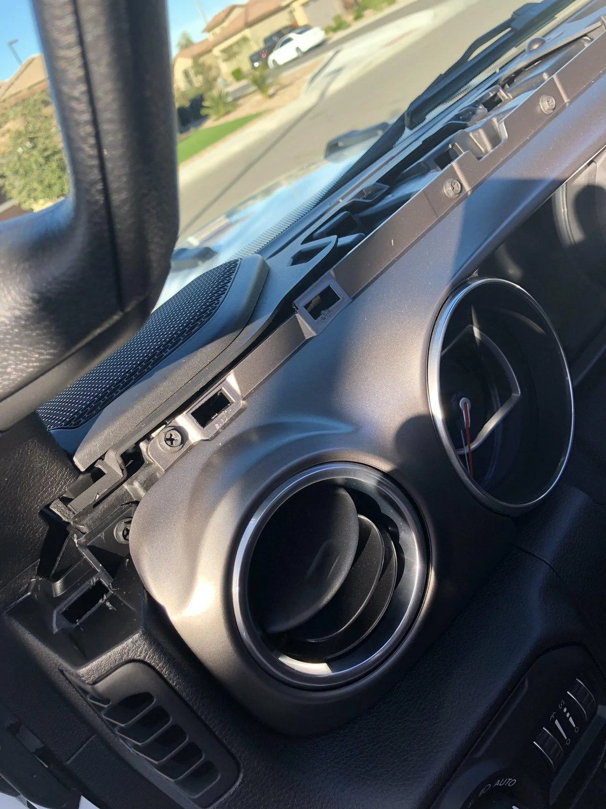

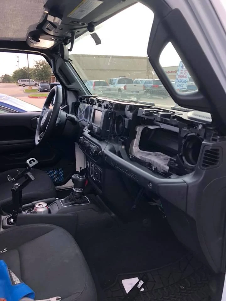

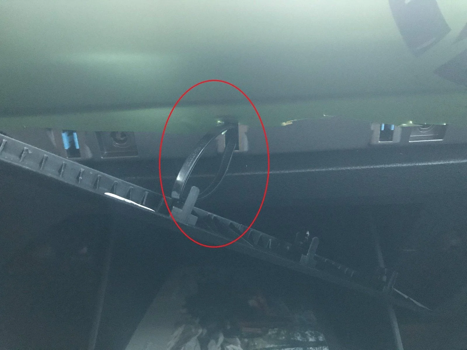

I've been asked how to take the dash apart so you can paint the red/gray dash panels. Here is a step by step.
***********SAFETY NOTE************** DISCONNECT THE BATTERY AND LET SIT FOR 30 MINS BEFORE YOU PULL THE AIRBAG*******
You need to pop off (has clips only) the AC controls bezel. Unplug the AC controls and starter button. The remove the radio bezel (Again clips only). Next remove the top dash pad. This has several clips and one screw that is hidden under the radio bezel. Now the fun part. Remove all the top screws on the driver's side dash (Red piece). The pry off slowly (Clips on the bottom). The passenger side is harder. Remove the top screws. Under the bezel is the SRS Airbag trim piece. You will need to remove that (3 clips) and cut the zip tie. Now remove the two screws that are under that trim piece. Open and drop the glove box. Look up and you will find two bolts (see picture) Those are for the airbag. (the airbag will come out with the dash panel. (The red thing you want painted). Remove the two bolts. Once you remove the bolts, pull the airbag and dash bezel towards you. from under the dash, you will now see a yellow plug. Unplug that plug and you are done!

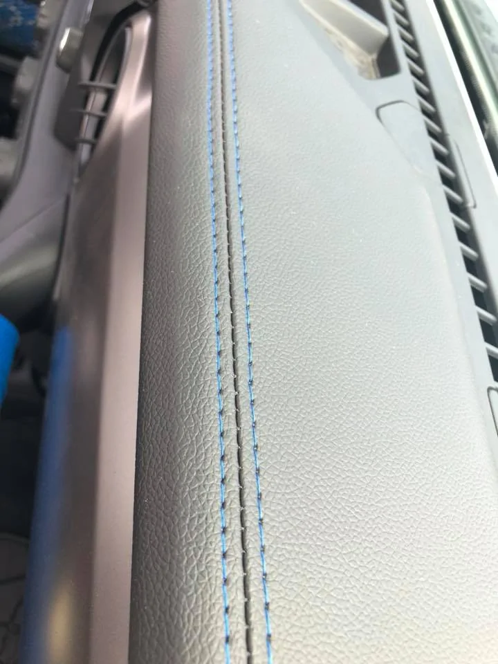

You really could be on to something here. I wanted a Punk'n Rubicon but would not/will not do the red interior with orange. If you could change out the stitching to orange and paint the ugly red dash, that would have been killer and I think more folks would buy some of these other colors. Every color doesn't go with red if you want black interior like Jeep wants you to think .

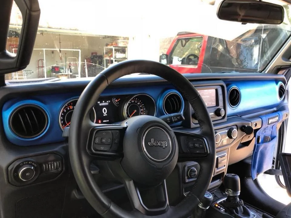

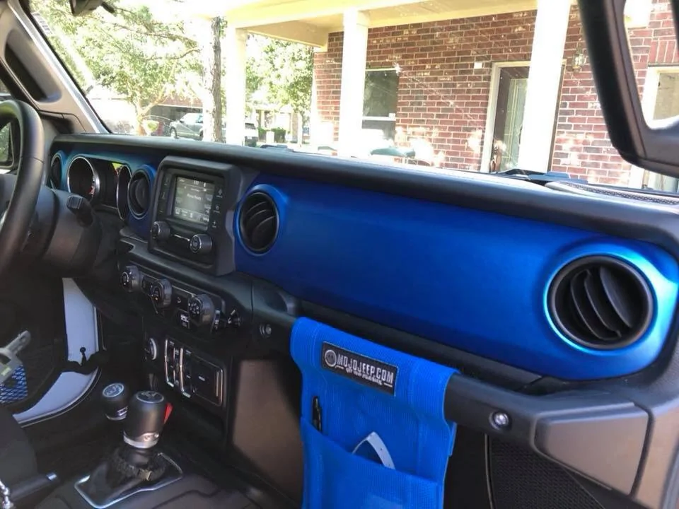

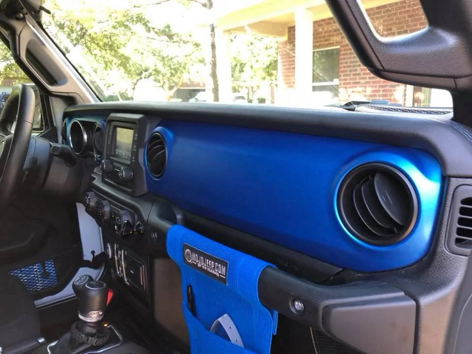

Here is the final product.

Looks great, nice job!
On a side note, that's a pretty cool bag on the grab handle. I may have to make one.
