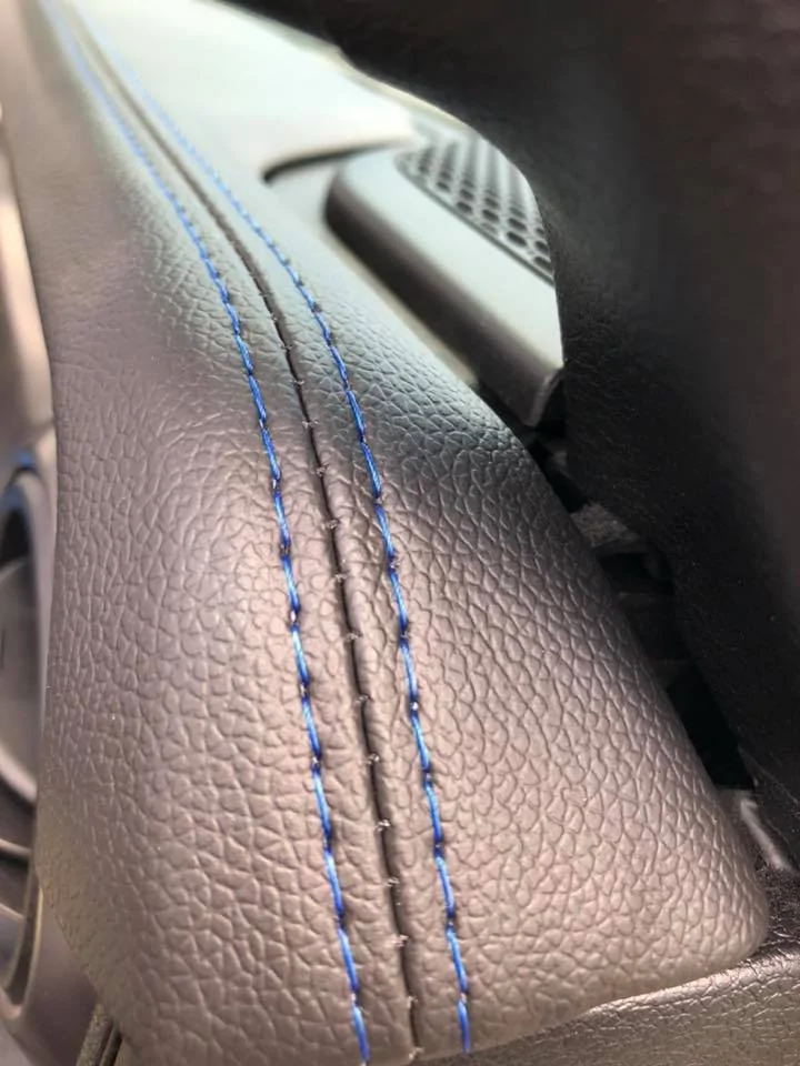

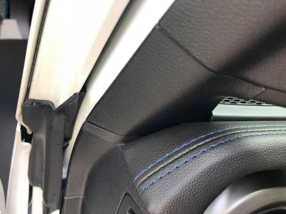

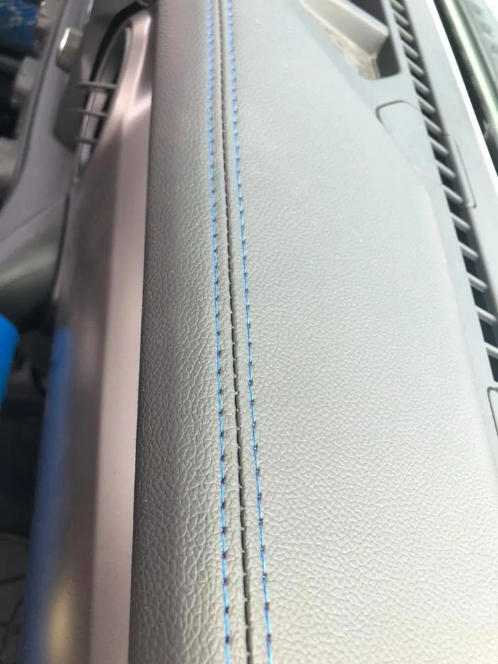

Here is the final product.
Jeep Wrangler JL Hydro dipping dash parts dash4
Jeep Wrangler JL Hydro dipping dash parts dash5
Jeep Wrangler JL Hydro dipping dash parts dash3
Jeep Wrangler JL Hydro dipping dash parts 36447310_1984365281614555_2018178211535388672_n
Jeep Wrangler JL Hydro dipping dash parts dash1

Looks great, nice job!
