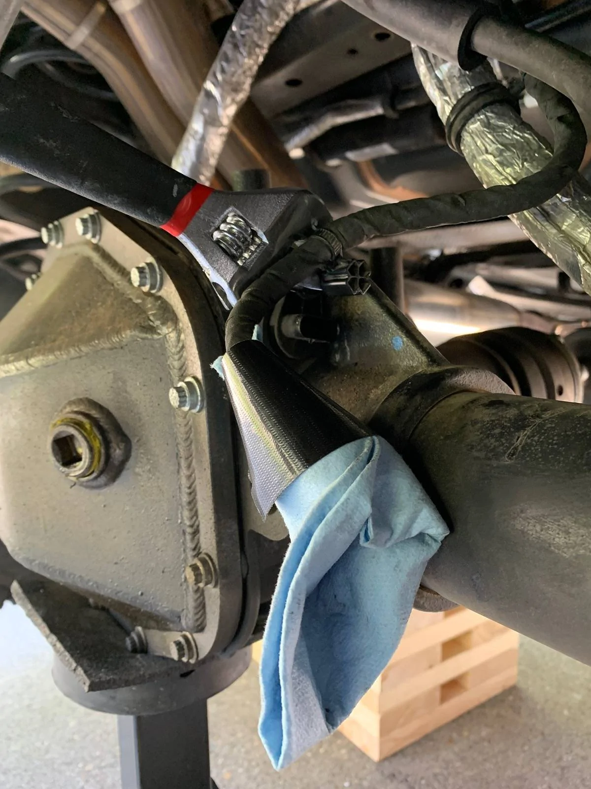

I’m in the process of swapping the coil springs, can anyone instruct me how to disconnect the rear locker cable harness before I drop the axle?
I pulled the white tab out with a screwdriver but can’t figure out the rest.
Jeep Wrangler JL How to unplug rear diff e locker harness? IMG_8460

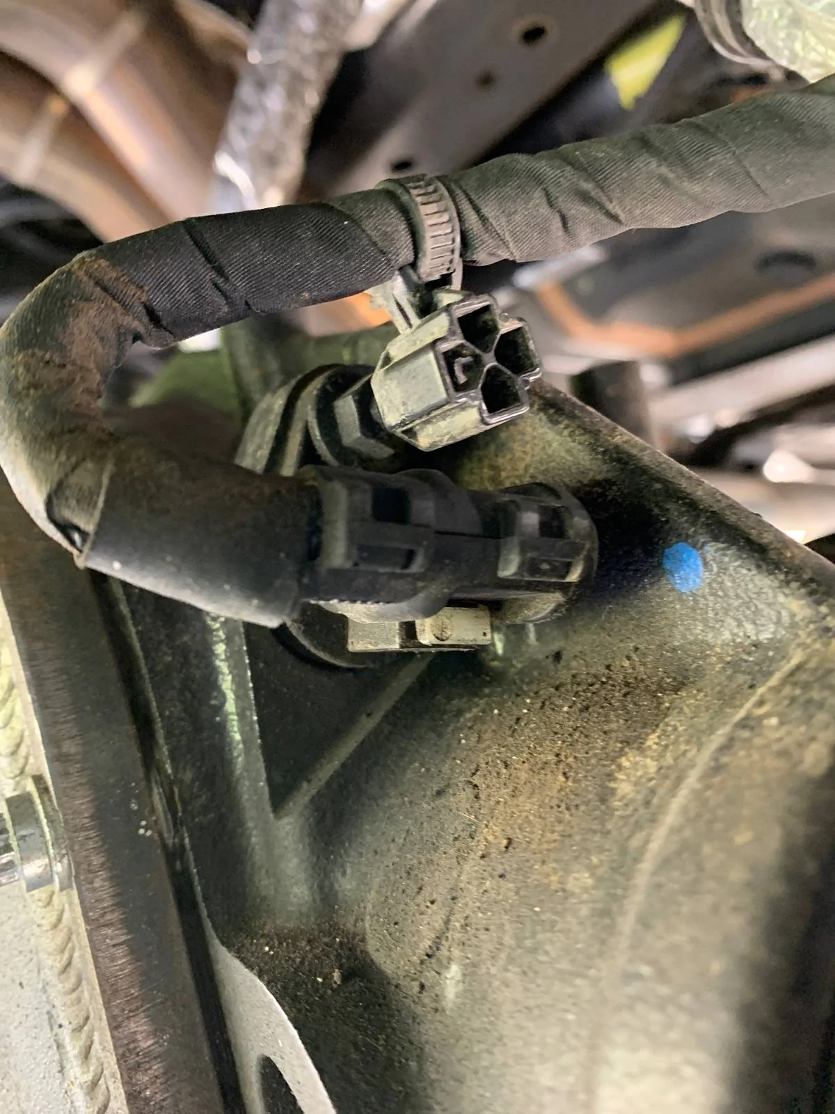

now pinch it by where you pulled the white tab out and just pull straight back. the connector that slides on the threaded bolt is a pain you need to just keep wiggling while pulling it. use a lever but don't screw up the locker plug.

now pinch it by where you the white tab pulled out and just pull straight back
Got it! Thanks a lot. I was being very careful and was afraid of breaking the plastic.

Okay, just pry that plug off the screw
