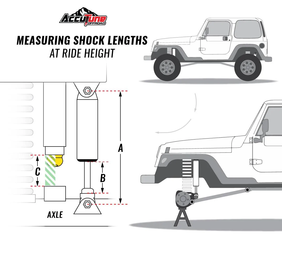

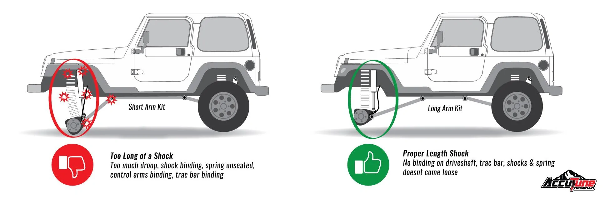

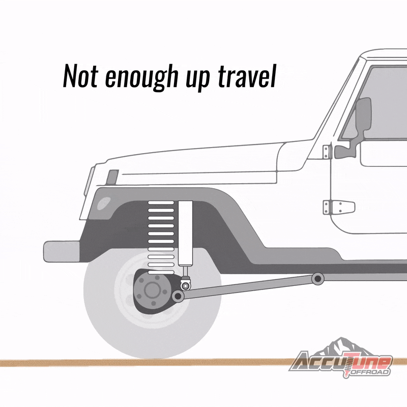

We recently put together a new Tech Article going over the process it takes to measure for new shocks. This should be pretty helpful for those looking to upgrade shocks on their lifted Jeep. There are a lot of shock options out there to choose from, and measuring for compressed & extended lengths is a great way to make sure you get the best fitment for your needs.
Why is up travel important?
How much total travel should I have?
How do I pick out the best shocks?
A few graphics to give you an idea on what to expect:
Jeep Wrangler JL How to: Measure for new shocks Jeep-jeep-suspension-animate-no-travel-sm
Jeep Wrangler JL How to: Measure for new shocks jeep-shock-lengths-good-vs-bad2
Jeep Wrangler JL How to: Measure for new shocks measuring-jeep-shock-lengths-at-ride-height
