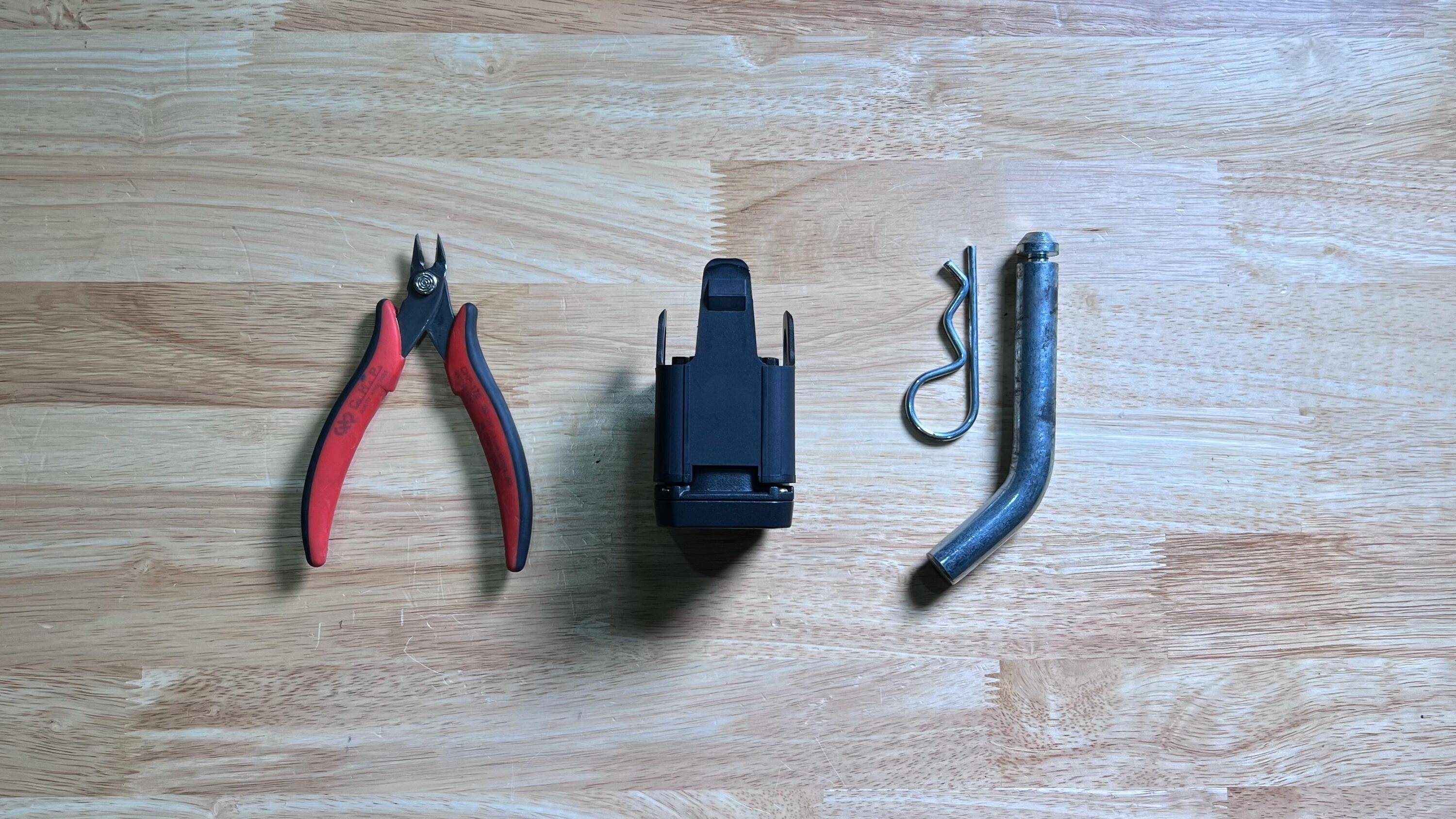

Requirements:
C1/C1R HitchMount LED Pod
Cutting Pliers
Locking Pin
Jeep Wrangler JL How-To: HitchMount LED Pod Trailer Pin Modification | Diode Dynamics ybUnwRw
Cutting Pliers | HitchMount LED Pod | Locking Pin
Jeep Wrangler JL How-To: HitchMount LED Pod Trailer Pin Modification | Diode Dynamics VtSDybo

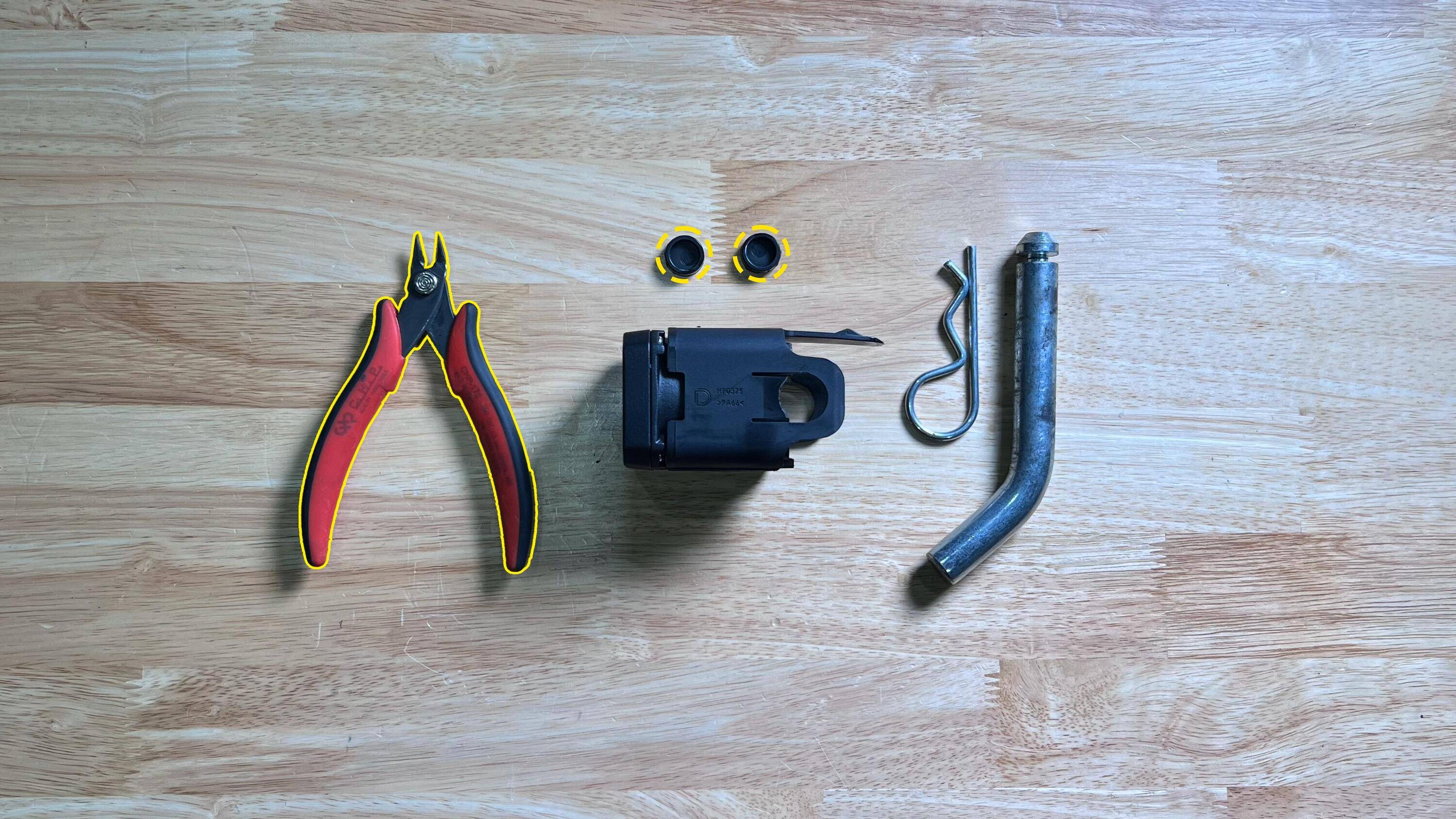

Use the cutting tool of your choice to remove the retention tabs on our snap-fit housing
Jeep Wrangler JL How-To: HitchMount LED Pod Trailer Pin Modification | Diode Dynamics bFWjipo
Retention tabs have been cut from both sides of the housing successfully
Jeep Wrangler JL How-To: HitchMount LED Pod Trailer Pin Modification | Diode Dynamics P9c4b77
With the snap-fit housing retention tabs removed, you can now prepare your locking pin

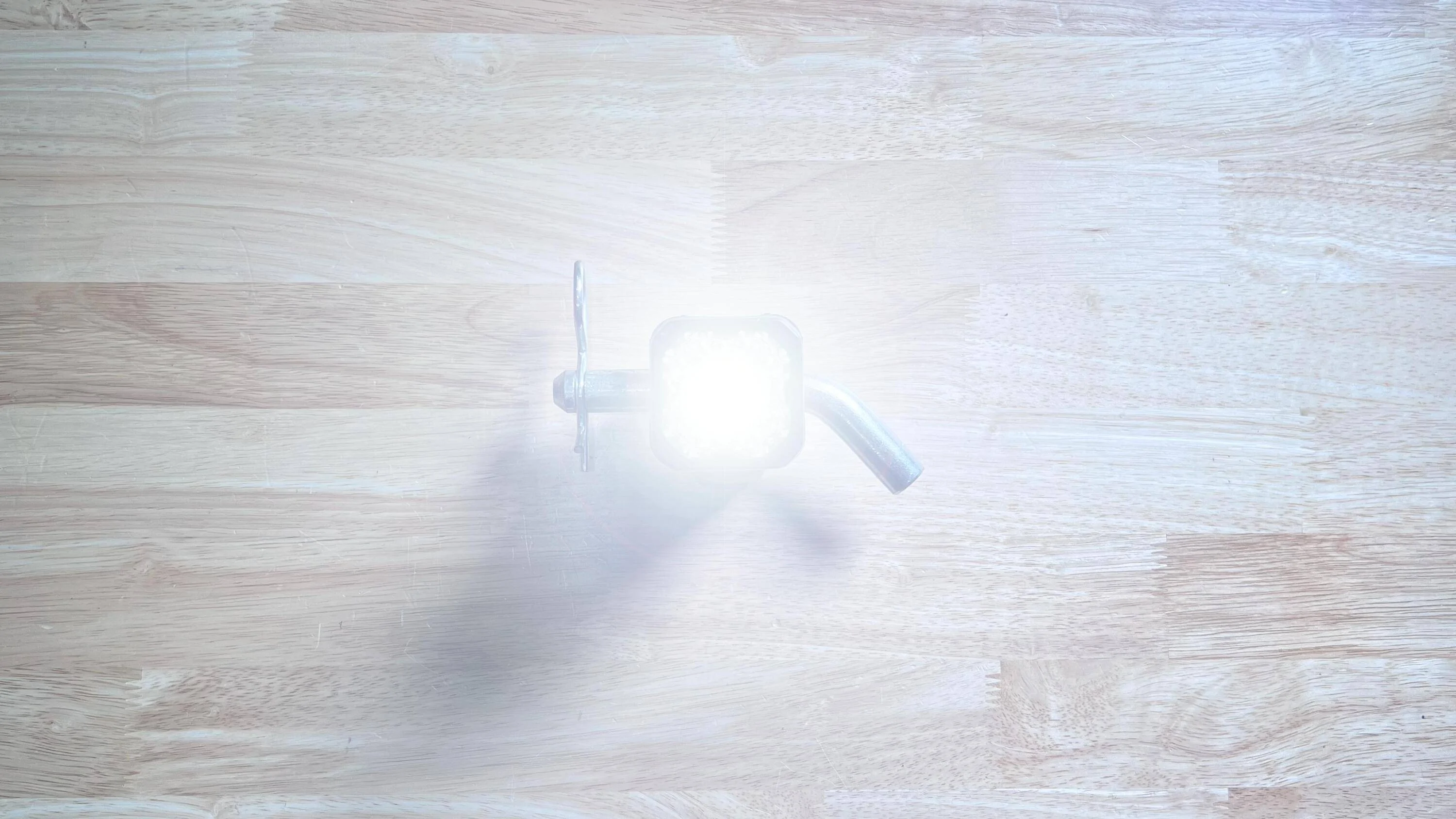

Security has been added to protect your HitchMount LED pod
