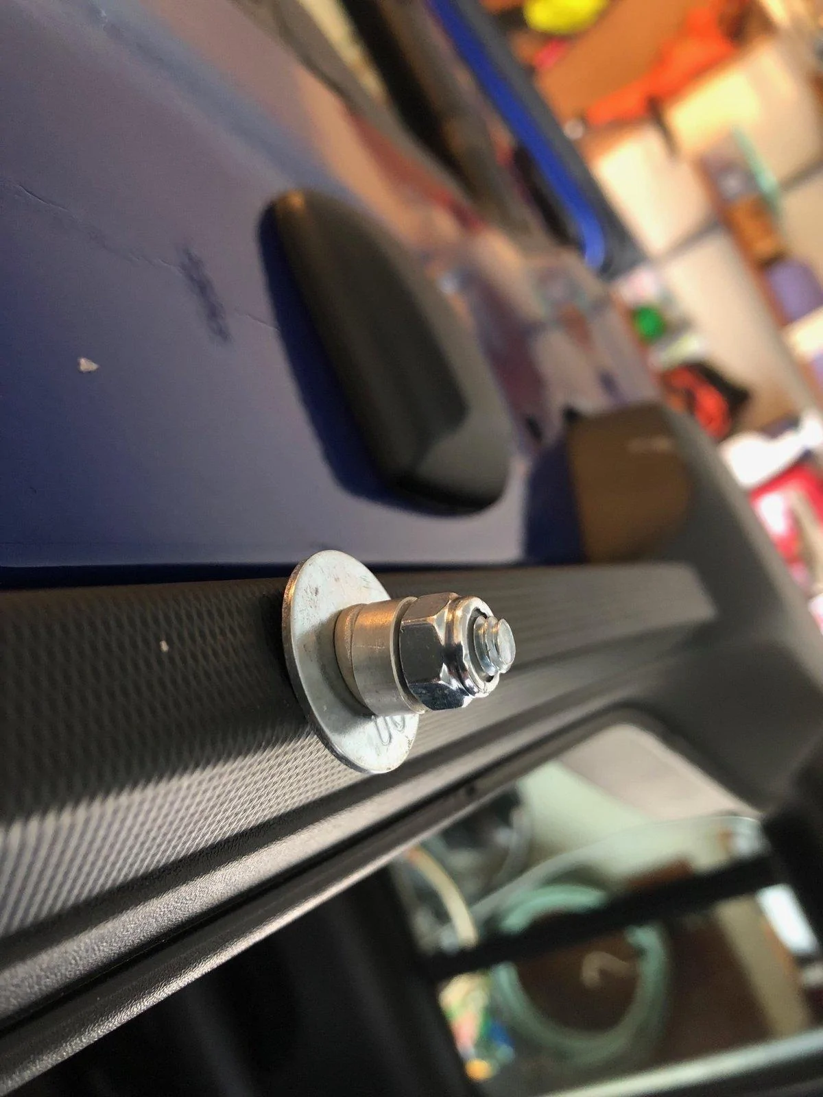

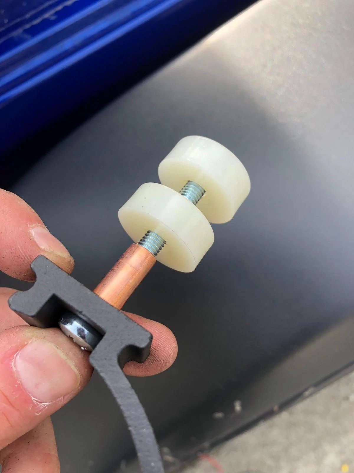

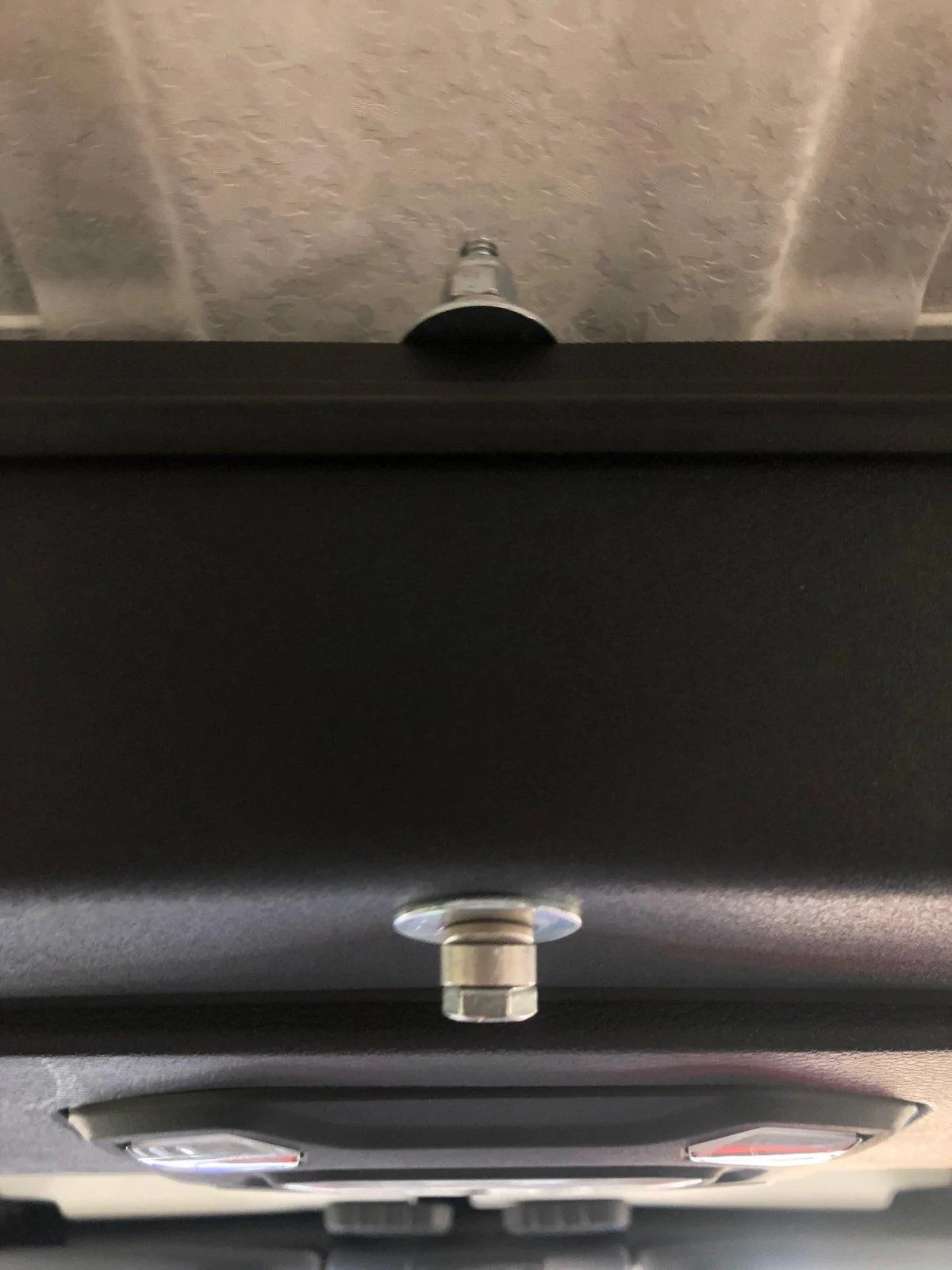

> Rear speaker bar vibration - for not having the upgraded sound system with subwoofer, these suckers still hit great in my opinion. All Chrysler products that I've heard have always had great stock sound systems. My only gripe was a horrible vibration at even low volumes from bass notes on the rear bar. I remedied the resonance issue with a vertical bolt through the whole bar, utilizing eccentric bushings from bicycle brake pads to get it to disperse pressure evenly on the angled surface. I then used the discarded rubber piping from the first fender attempt to press into the space above the bar, between the enclosure and the roll cage, as well as below the bar between the enclosure and the trim that houses the dome light. Evenly installed it looks stock and you cannot even see the top piping, but it is now TOTALLY SILENT even with big bass hits. Now I notice vibration from the front somewhere.....:CWL:. That solution gets to wait till next weekend. (see photos)

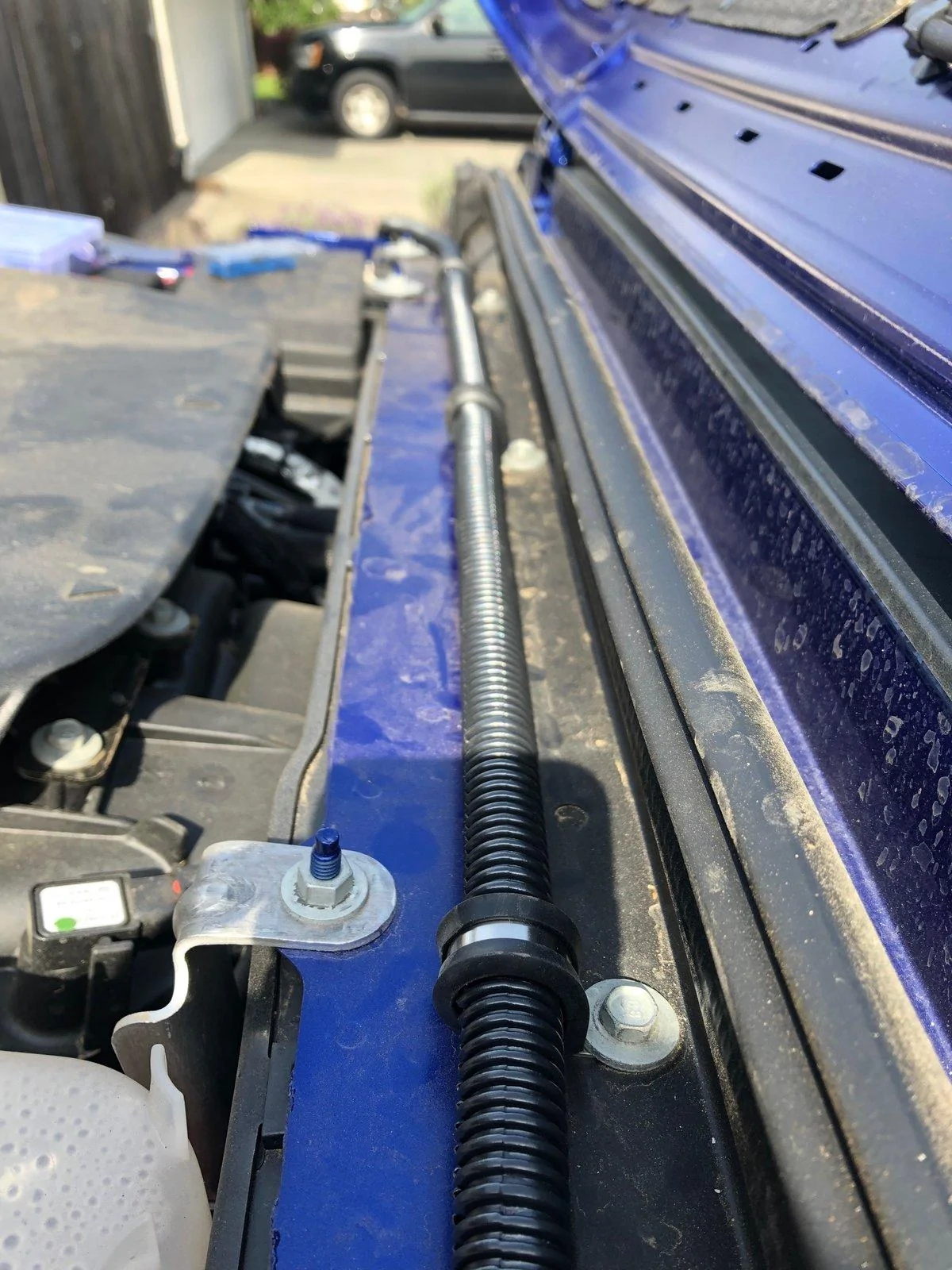

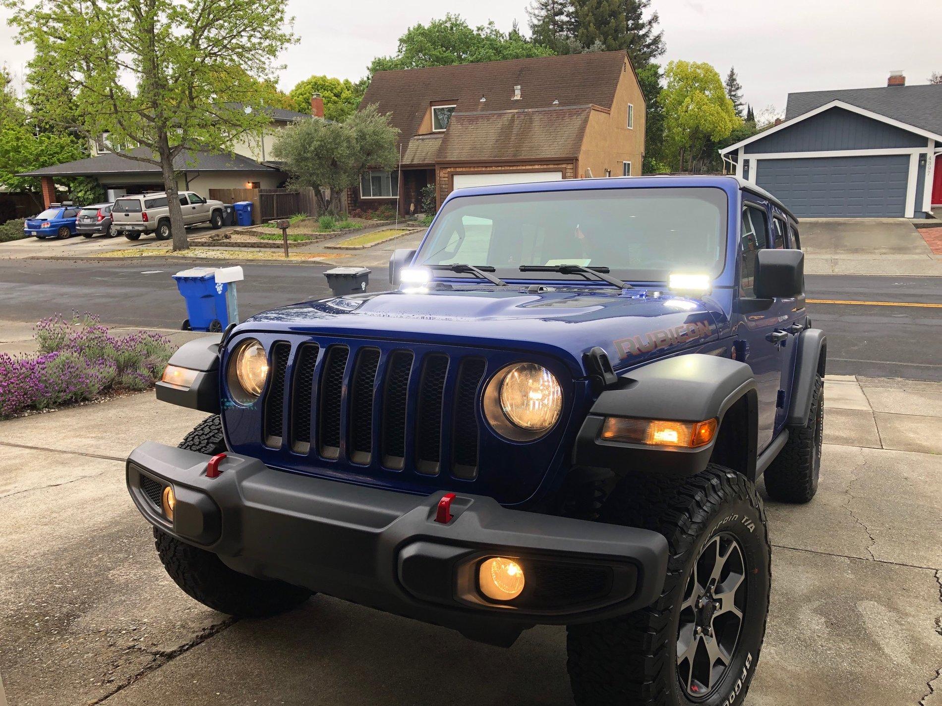

> Accessory Lights - I wanted to utilize the OEM upfitter switches as they're awesome, so I purchased the cheapest legitimate LED lights I could find. I have no interest in a hooligan-esque light bar and cannot rationalize spending hundreds on KC or similar branded lights if they may get torn up on the trail. I purchased two pairs of these for front and rear https://www.amazon.com/gp/product/B07DHNFXKL/ref=ppx_od_dt_b_asin_title_s01?ie=UTF8&psc=1 along with the following for installation. https://www.amazon.com/gp/product/B01MSJMAU1/ref=ppx_od_dt_b_asin_title_s01?ie=UTF8&psc=1 https://www.amazon.com/gp/product/B01MRYMY6Z/ref=ppx_od_dt_b_asin_title_s01?ie=UTF8&psc=1 https://www.amazon.com/gp/product/B00J7S39CW/ref=ppx_od_dt_b_asin_title_s01?ie=UTF8&psc=1 https://www.amazon.com/gp/product/B01N07O1GO/ref=ppx_od_dt_b_asin_title_s01?ie=UTF8&psc=1
I already had spade, butt, and bolt connectors but you'd need those for the wiring as well. I had to get creative at Ace to mount them beside the cowl, but after that they went together great and are dumb bright. I used the space below the panels beside the cowl as a discreet point to do the wiring junctions and so I could get to them in the future should it be needed. All for around $70. Still needing to do the rears. (see photos)

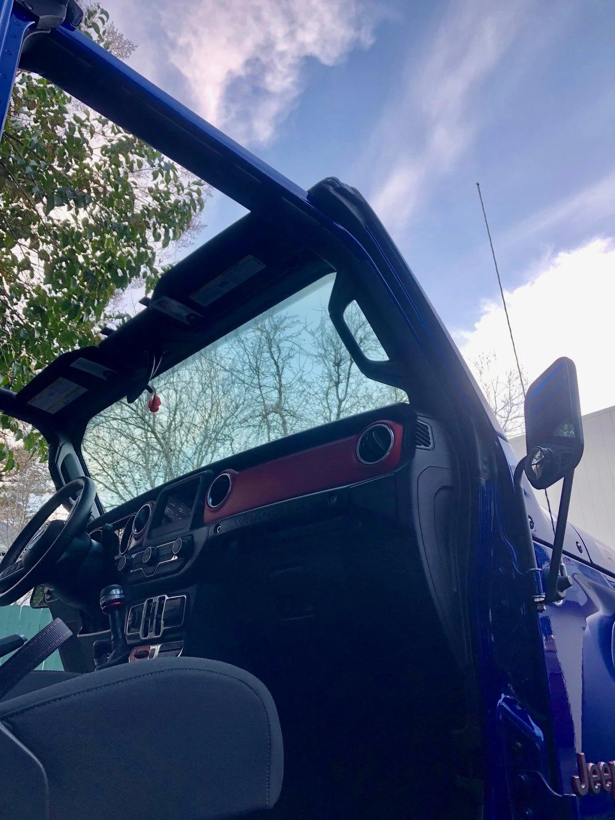

> Illegal to drive with doors off - Mirrors were the remedy! I picked the following up, and after a quick Ace run to get a little better hardware with washers and mylar washers to get them tight enough for highway travel, all was well! Cheap cheap cheap! https://www.amazon.com/gp/product/B07MKHQK4S/ref=ppx_yo_dt_b_asin_title_o06_s00?ie=UTF8&psc=1 https://www.amazon.com/gp/product/B001DKT0DO/ref=ppx_yo_dt_b_asin_title_o06_s00?ie=UTF8&psc=1 (see photos)
