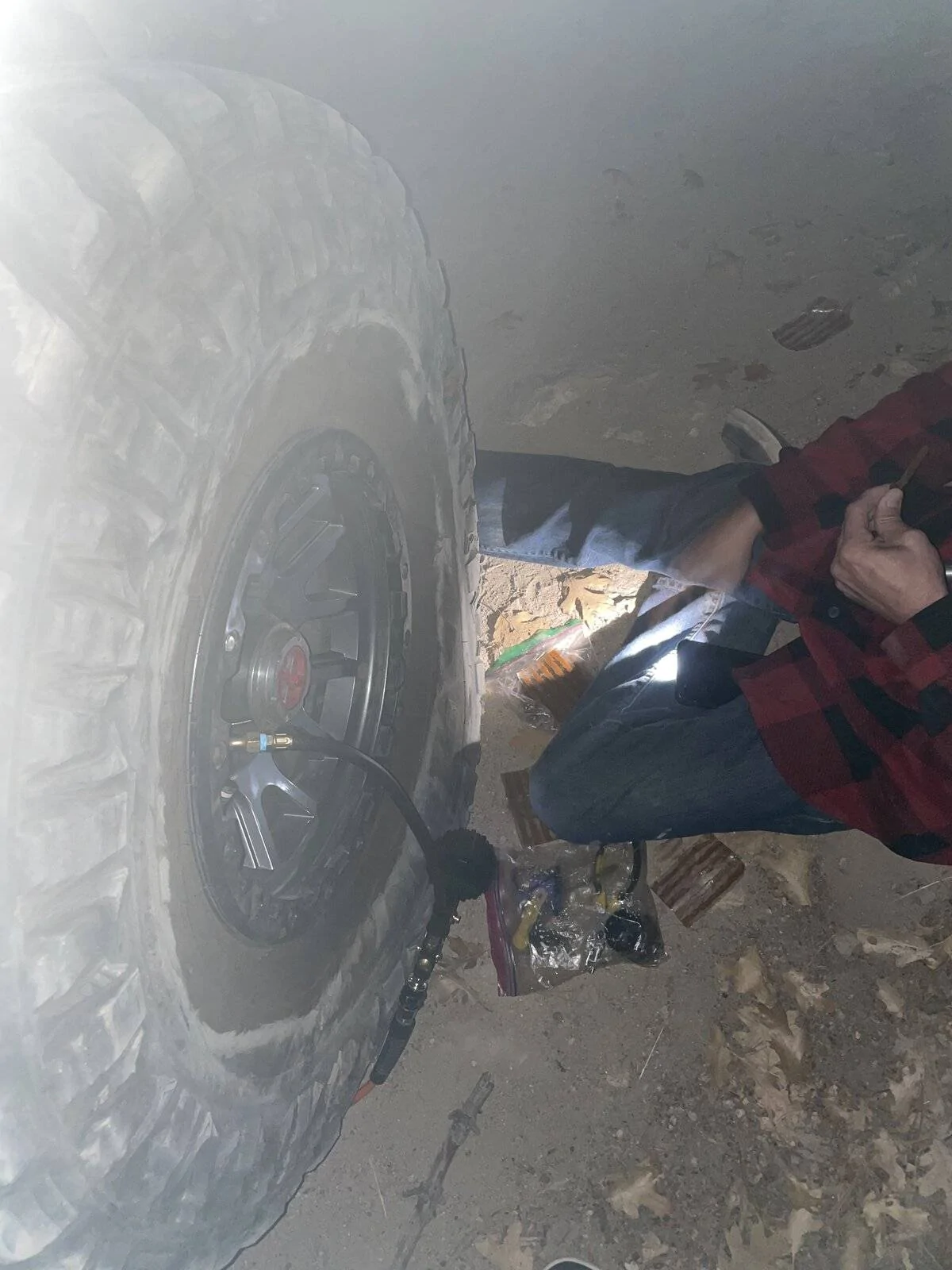

Stuck in big bear with moto21 on a trail with a shredded tire
Jeep Wrangler JL Help imag

Are you OK? Did you get it fixed? Did you install the spare?

We don’t have a spare sadly as these are newer, we are trying to put on our cousin smaller spare and hope it at least gets us down the hill . It was shredded in 2 spots

In this case, do not use your lockers (if you have them) and try 2 wheel drive instead of 4 wheel drive if you can, due to different drive shaft speeds due to dissimilar tire sizes.
